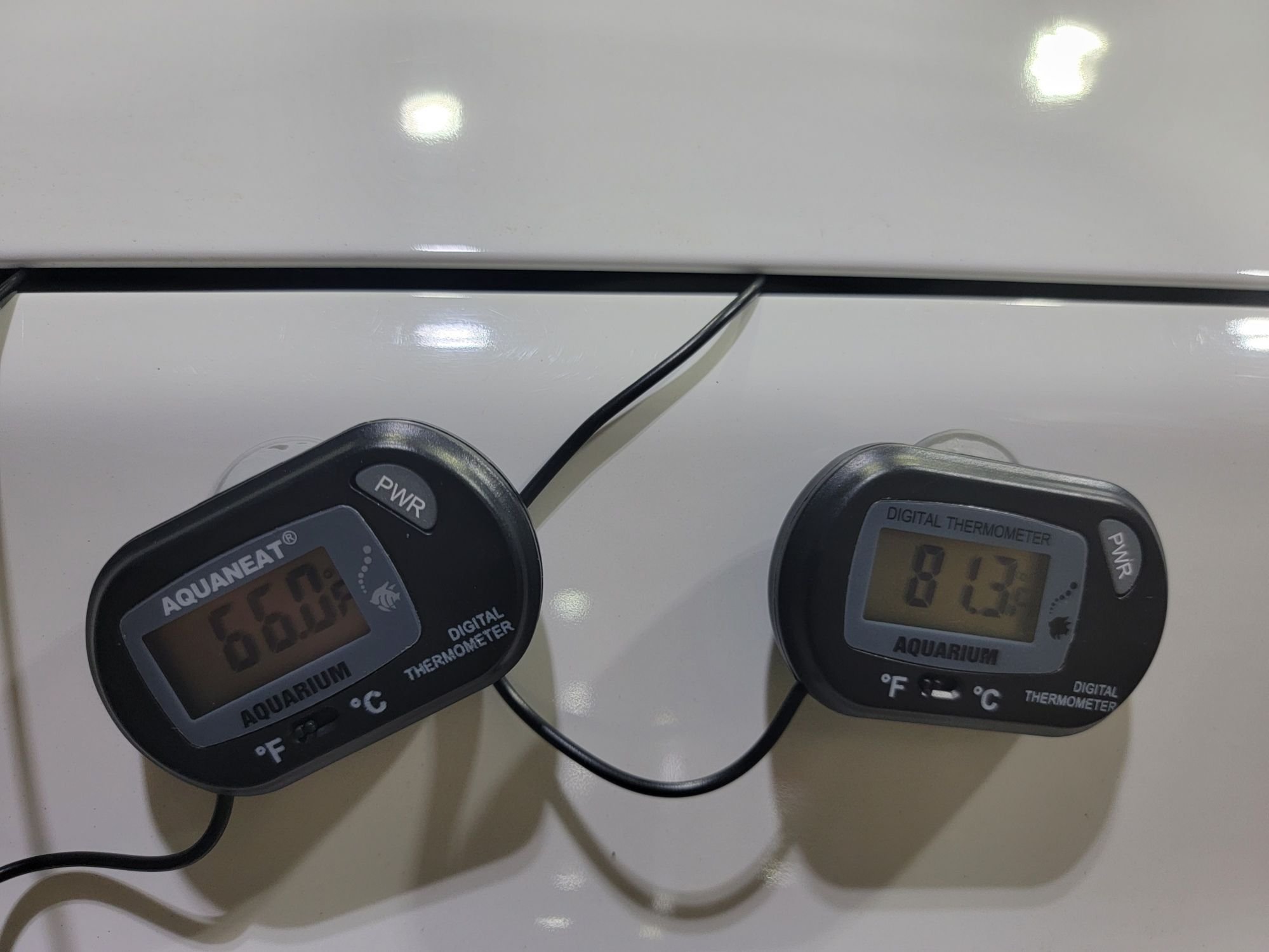

temp diff inside and outside the air box (while car is parked), 60degree evening. Still have to block the side of the radiator and the frame rail
