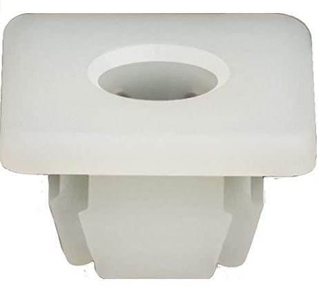

these stay on the same spot (and white), makes it easy installing the cover. also works for the engine mount brace
They're also plastic, and would use a very coarse thread screw (almost like a wood screw), and strip somewhat easily. I don't have to worry about stripping the metal speed nuts and allen bolts I use
Nylon. I'm using the same ones since 2012 and on my 2nd belly cover now. i think i had #8 screws at some point and now #10 i'm still trying to find wide washer head screws... pairing screws and washers adds a few seconds to the process lol
btw I added some glue to the thingers so its 'permanent' and wont spin. I dont have one that is stripped, they're all snug, oh and they wont rust
