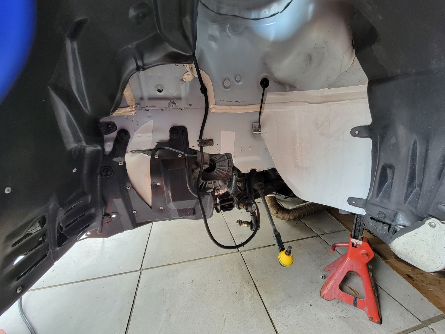

I use NAPA rubberized undercoat. It dries to a NOT sticky finish with some give to it... Like the coating on the right side in your picture.

Do RS's have that black undercoating? I hate this crap. The dirt is always oily and I've had it going to my eyes, hair, shirt, etc lol while working under the car. I'm done with the fronts, the rears are probably 4x the work but it'll be worth it
fuuuu*****¢¢¢¢kkk I've had that crap in my eyes more times than I can count.

just brushing on some flat white enamel. The original paint on the underside is so thin so I might apply enamel all over when its time to replace the fender liners. the rears will be 100% covered since it has that cream glue material all over. I'll do the same under the seats after a good power wash

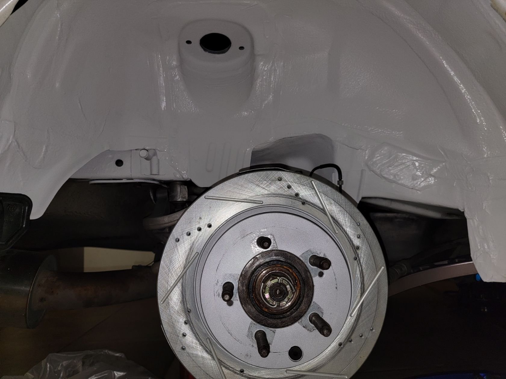

WD40, spray, stir with bristle brush & wipe. Purple degreaser and my tire sprayer for the final wash
testing enamel
I also painted axles and brake shields too lol

Hmm, I got a truck I may need to do that on (not white lol), what epoxy did you use?

Soapy water and a paint brush. I'm always under the wheel well anyway lol
this is just the basic Home Depot Rustoleum flat white enamel paint. I still have to see how it holds, especially during winter. I'll just power wash it off it cracks or peels.
if you want a good undercoating, look into the CRC Corrosion Inhibitor, its clear-waxy, not black-rubbery. Has great reviews on youtube and even works on electric connections. I'm after a clean wheel well that wont collect brake dust and sand & shiet.
I've had experience with epoxy on the garage floor... never again!!

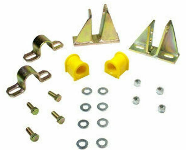

Just learned this thing existed. I dreaded revisiting my RSB due to that stupid OE bracket
KBR22-24

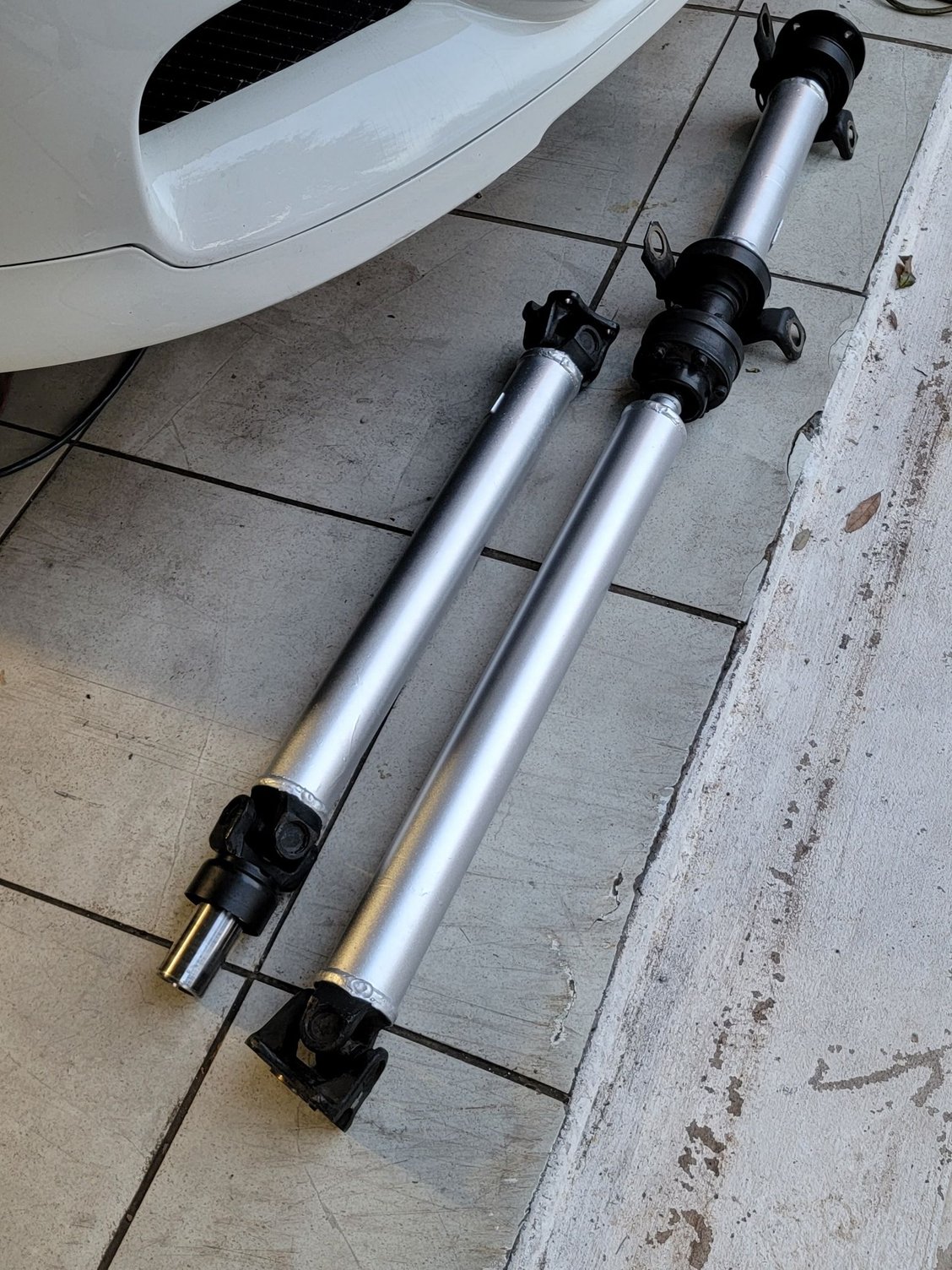

finally got these today, but my 5" swift springs are stuck in some container somewhere. QQ: I should be going for the longest configuration for the rears right? anyone know how much (minimum) thread should be in that green canister? its just barely peaking thru that hole as pictured and it's a tad shorter that my KW v3
