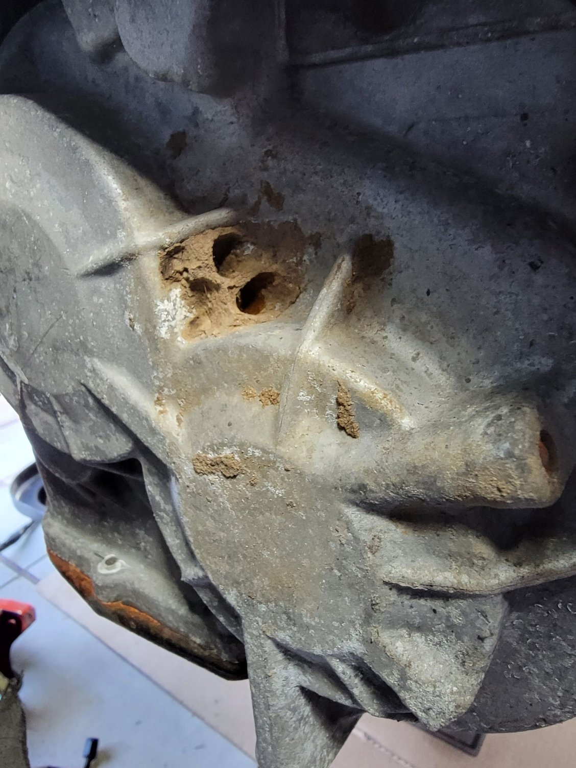

nothing new to share today. just this... I always wondered why there usually a lizard or a spider on my tires
need to pull that box out it looks 60 years old hahaha.
Im guessing your car has been on salted roads at some point?
That's actually freshly assembled maybe 300miles ago. before that check up it was built and painted by ShepTrans . I think that paint had chipped off thats why it looked like it lived underwater lol. I have full splash shields/plastics so this area does not get rinsed. We dont get snow or salt water in Houston. My car is parked outside tho. I will pressure wash it when my axles are in
