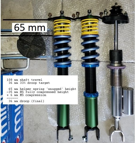

Now that the TC is in i can factor in main spring compression
trying to make some adjusters for the rear

This is the best tool for my FA rears that I can find so far. I happen to have one from a previous faucet upgrade. Good feedback for those "clicks"

the way the space is under the ohlins i doubt i could even get a tool up there. leave me the choice of either racing at the bottom and making the knobs basically unreachable or raising via preload which is supposedly not ideal. i dont think in the fronts this should matter as much since they'll never be unloaded at least. i've got my car in the shop doing some weight balance adjustments but afterwards i'll drop the rears a touch more.
That's terrible, and potentially dangerous. I'd go nuts if I need to test settings. I barely have time to adjust air pressures and gather my thoughts when doing autox'/track sprints sometimes.
My other car has adjustments at the bottom also. I carry a folding windshield sunscreen around so I can lay down on it when making quickie adjustments

yea i mean i can personally reach it but as u raise it it travels further up the bottom perch and harder and harder to get my hands/fingers around the knob to turn it - like try to reach the bottom of a tall glass you're washing.
i use cardboard but folding windshield screen is not a bad idea - waterproof too, more or less.

Ohlins front rebound adjusters are on the bottom because it's an inverted damper. Fortune doesn't use inverted dampers unfortunately. Inverted is desirable for macstrut suspensions since they're more robust and less prone to flexing under high load.

You should be setting your droop travel and then not touching it and setting ride height via spring perch ("Preload") I can easily reach my front adjusters when the car is on the ground and my car is only like 50mm off the ground
