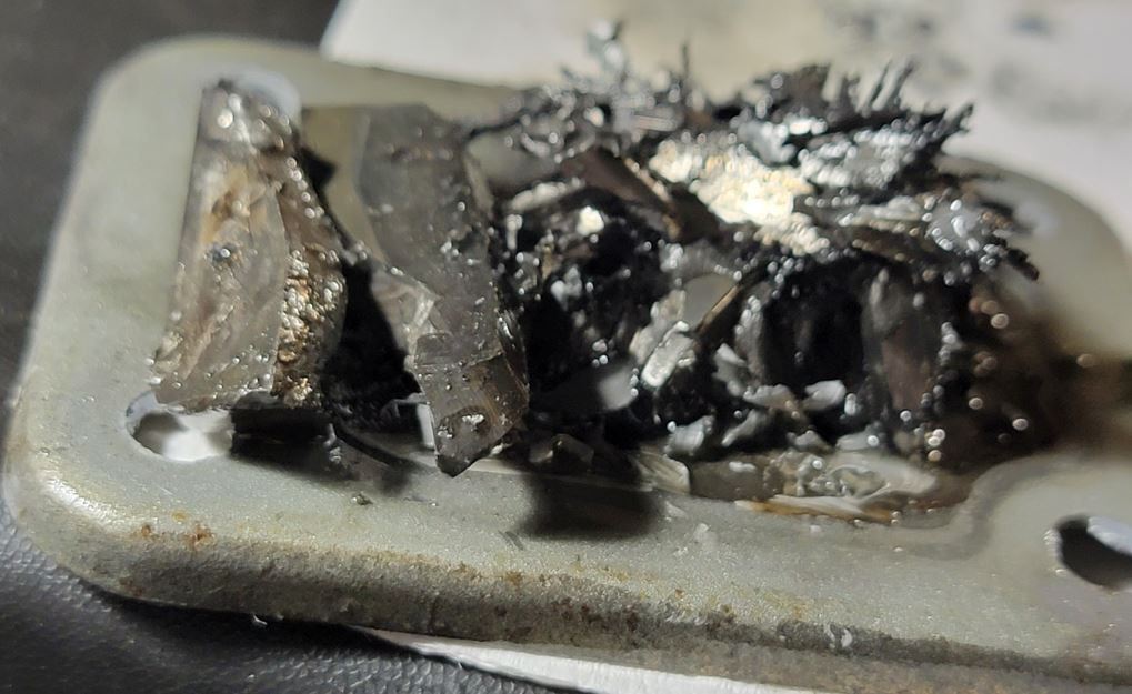

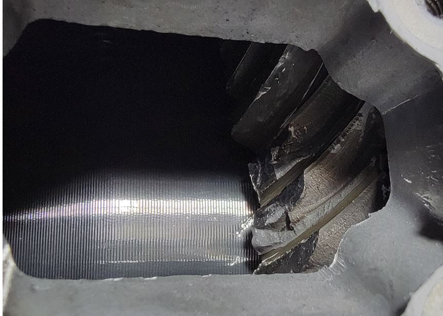

remove the inspection port and rotate it over that allows you to check the ring n pinion at least to see if youve broken a tooth. If not youve either popped the torque tube that runs thru from the gearbox or youve broken the front diff planetary gears or something similar in the front diff. being a wavetrac though they are bulletproof generally. they will warrant them too.
Start with the inspection port that will eliminate the ring n pinion at least which is normally the weak point

I was kinda excited to report that there's *only tiny pieces on my drain plug*, then I removed that plate
I did not know this plate is magnetic
7 consecutive teeth damaged, no idea about pinion

Ive smashed 2 ring n pinions in transfer case while mid race. Ive been told by Ralliart here that the ring and pinions are prone to hairline cracking and eventually these cracks shatter the gearing. They replace them once a rally season in all their rally cars and never have issues. As for the cases flexing i dont know if they do or not. maybe? I have a spare transfer case unit i picked up nice and cheap which i keep as a spare in the shed and i have a spare ring and pinion also. Biggest issue lately is theres like a 15 month wait on ring n pinions from mitsubishi last time i enquired.
Your very lucky it didnt smash the casing as normally the teeth go around the ring gear and smash out the side of the casing ruining the T/C. if the ring gears toast the pinion will also be toast. good news is your diff will probably be fine just give it a good clean out in a parts washer make sure you get all the bits of ring n pinion out of it lol

Normally the teeth sheer off then get dragged around the TC via the intact teeth and they wedge between the crown wheel and the casing and blow the casing out as they have nowhere else to go.
If you can find a cover on its own then for sure!
