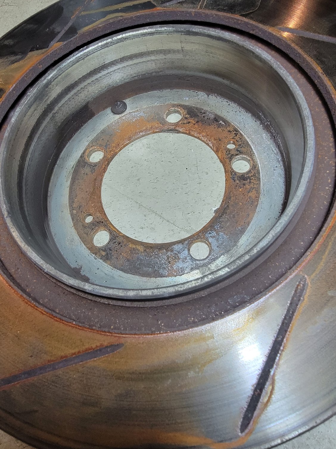

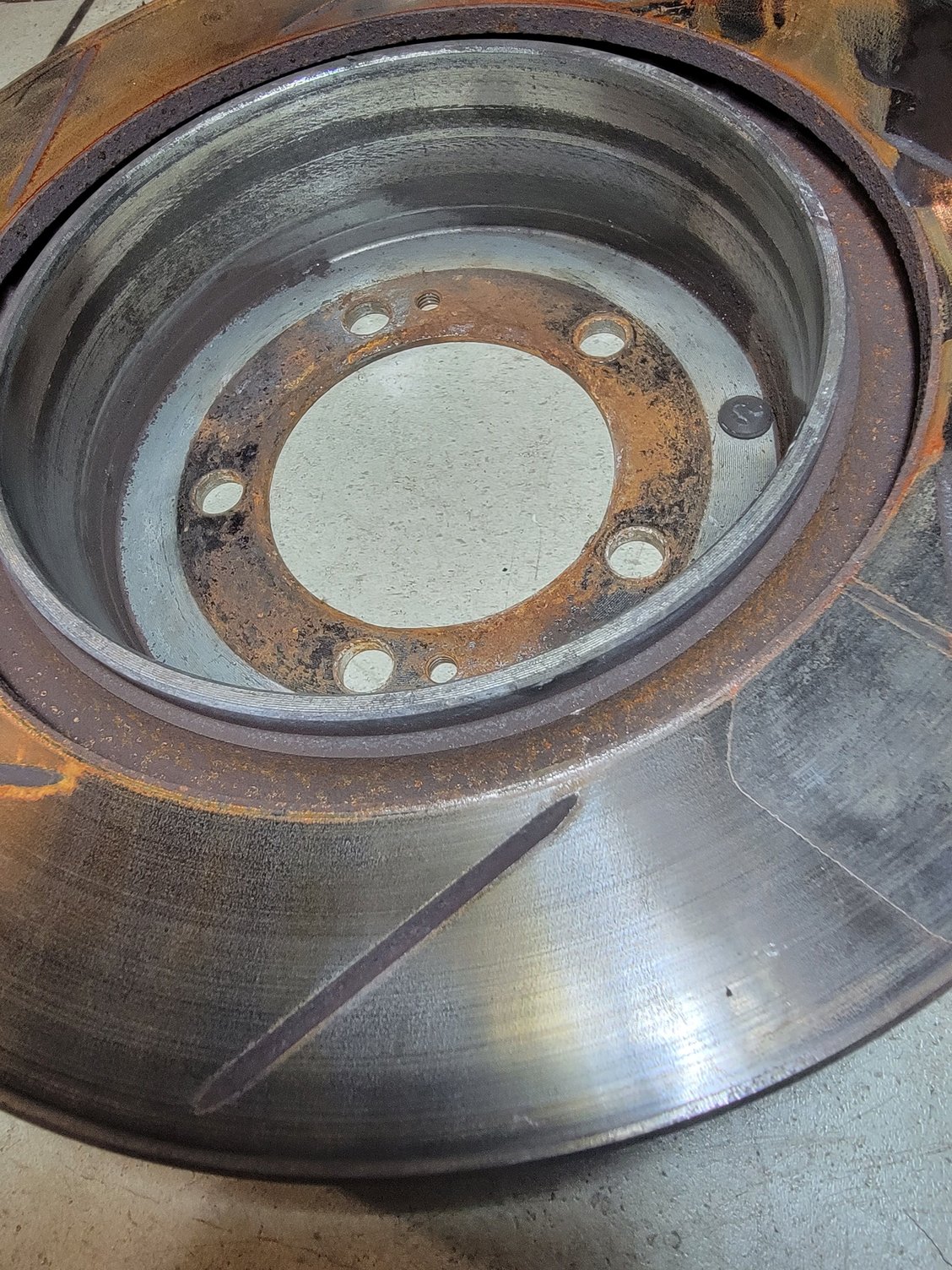

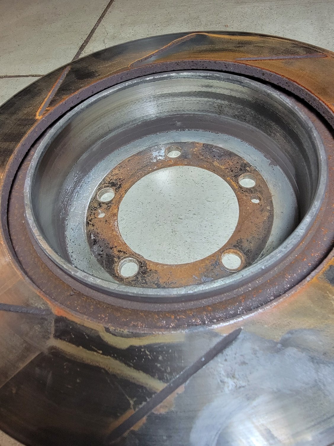

This might sound crazy, i apologize in advance. both IS axles are fine, lsd oil is light gray, not much shavings and no prizes coming out. Initially i was disappointed and confused. I was packing up for the night putting back the hub and rotor and test spun it a few times then it snagged super tight... the drum brake was engaging. I dont know if the simple explanation is that my rotor is warped, or if this 'burnt' part has too much friction or something is screwed up (more on this) or all of it. The clank/thud likely came from the lsd, like when making tight turns. this is the first time it made that sound going straight since one wheel is braking.
Old Sep 8, 2021 | 09:41 PM
  #150
ViciousLSD's Avatar
Joined: Oct 2011
Posts: 3,858
Likes: 600
From: Houston
Some sequence of events before the big bang....
1. on the Aug 22 TT, i had to pull the emergency hand brake hard when I lost pedal pressure, going well into 5th gear. pretty sure the rear brakes were very hot at this point
2. days later i tested my 11" wheel and moved the brake cable to run more along the trailing arm which stretched it a bit. not sure how big of an impact that is. it does move with the trailing arm
3. i inspected the drum brakes. pads seem thick as new. I wanted to replace the pads but I didnt get any new springs/hardware so I just put lithium grease where its recommended. the pad seems freer to self adjust more. I didnt inspect the drum. I did swap rotors left<->right since the fronts have directional vanes, rears dont have directional vanes but swapped them anyway. I guess now the brake surface is moving in the opposite direction (not sure if thats important)
4. I change to motul fluid, bedded the pads hard until the rotor surface is shiny. tested the hand brake several times.
5. I drove 50miles to the track and didnt have any issue. I never used the parking brake on grid but I did check if the hand brake is good since my pedal *seems* to be getting mushy. rolled to the start fine, feathered the clutch and once its rolling I mashed the throttle then bang. some popping/slowing as I roll to the infield/cross over. the locking is a lot more severe from stand still to getting pulled by a tow vehicle. it remained in this state since that moment. the drum pads seem slightly off center
A series of events is typical for my (bad) luck. seems one thing leads me to another thats why i thought of listing them down
