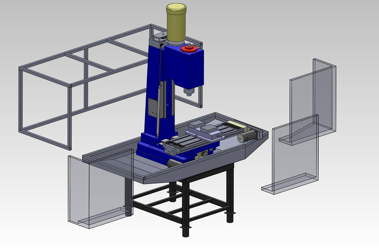

I've been thinking about my car recently, still need to order the inconel studs and rip into the turbo system and fasten things down a little better.
But my free-time has been busy with my CNC milling machine build. It's been similar in scale and effort to the EVO build. Lots of time out in the garage making parts to mount the precision ballscrews, servo motors, encoders, larger three phase AC motor, flood enclosure, motor control systems etc. When it's done I'll be able to crank out whatever I like in terms of parts - in the garage. So I could cut my own billet smooth transition exhaust manifold flanges, turbo flanges, control arms, motor mounts, suspension uprights with improved geometry, better BOV's or custom brackets for neon lights or NAWZ bottles. You know, stuff that is super sweet.
Here are some images from that. Hopefully I'll be up and running by spring, right now I'm still finishing up some parts with the machine in manual mode.
Current State.
"Don't get metal all over the garage" plastic enclosure.
Flood cooling enclosure in process
Parts finished up for mounting bearings and motors.
Motor control system and PC based CNC software.
