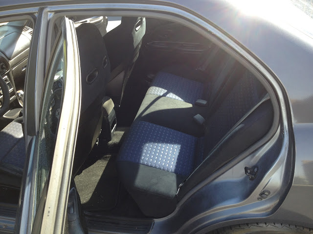

Originally Posted by Archlegan
Where in Jacksonville are you? I'd love to see the car!
I'm over on the southside. It's not much to look at right now but in a couple of months it will be.
Here are a couple of interior shots.
