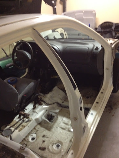

I’ve been a huge fan of the Evo’s ever since seeing “Who am I?” back in 1999 or 2000 and was set on getting one. After much searching and talking to different RI’s back in 2003, Motorex said they could do it for about 45k. Unfortunately that was just far too expensive for a 16 year old so I ended up with a 93 RX-7 instead. Now nearly 10 years later I’ve owned and modified three FD’s, a Civic hatch, a Rubicon, and three Z33’s (including my current DD Nismo #871) and have finally decided to build my own Evo IV. (Thanks to BCspeed34, ArchieBabes, and 3bar_dc2 for such inspiring builds and posts.)
I already have an Evo IV front clip complete with just about everything I need as well as a 2001 Mirage that I will tear down to the frame, clean, paint and rebuild as close to an Evo IV as I can get (just not RHD). This will be all original panels, trim, etc. (no fiberglass replicas), with Evo IX seats, and painted Graphite Gray. Once I can find a rear floor pan at a reasonable price it will become AWD and get a 4G63.
More images and updates to follow.

Post up pics of the clip when you get a chance. I recommend doing the floor pan swap first. Once that's done, it's all downhill. Rumor is that the Evo 8 and 9 floor pan will work. I'm using a Evo 5 subframe, sway bar, and control arms w/ Evo 8 rear diff, axles, mustache bar, control arm brackets, and diff support. These parts are easier to source than a Evo 4 floor pan (they're different) and evo 4 rear end. It'll also give you a wider stance.
You'll need the Evo 5-6 gas tank and filler neck if you go this route.
Good Luck

Alright guys, here are some updated progress pics of what I've been working on recently.
gutted Mirage interior
black lhd dash pulled from salvage yard
empty front clip with random clutter around
empty front clip on end
evo powersteering cooler and push fan installed
manual doors taken off Mirage and filthy door jambs cleaned
power doors on
nice rear
front end assembled
evo interior harness work for evo power mirrors and automatic a/c controls
evo swaybar on left mirage swaybar on right
5lug swap w/tiens compelted on front
350z wheels from an old 350z I use to have that I will run temporarily
More images and updates as I get time to work on it.
