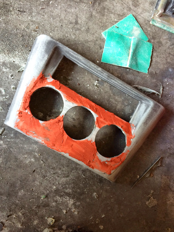

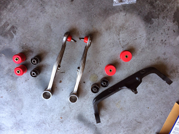

Some updates from the past week.
Pressing out old bushings
Bushings out
New energy suspension bushings in
New whiteline bushings in the front control arms
Mostly completed rear end
Welded on the evo firewall braces
New a/c evaporator vs old
New timing belt, balance shaft belt, and accessory belt
Wrapped the manifold, new water feed and return, and braided oil feed and return
Gauge pod Im working on
Full Evo harness from Jeremy @ http://www.evoparts.co.nz/
My rear cut coming from Canada
