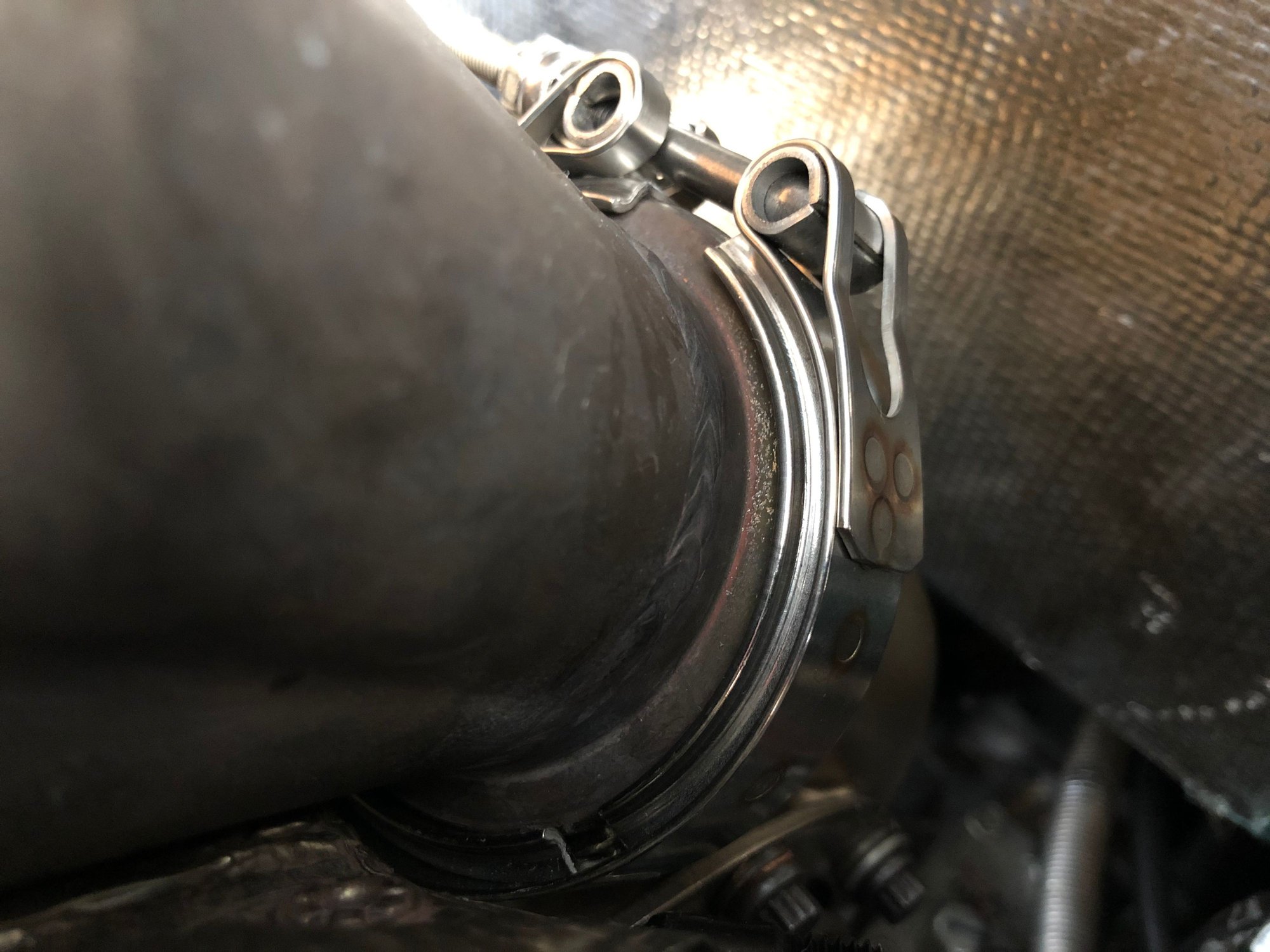

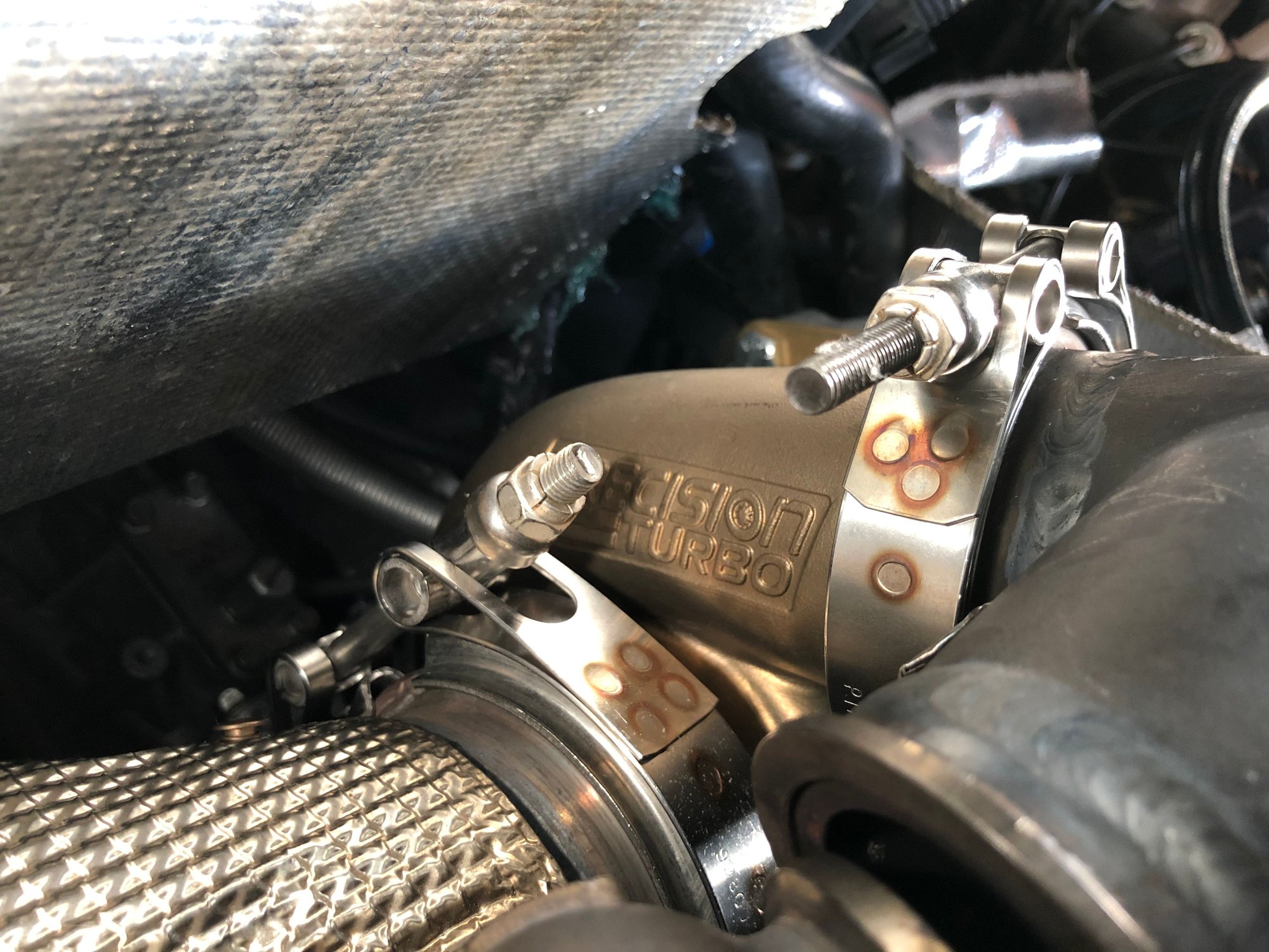

Anyone have any tips for me on this one?
I've been wrestling with getting all the v-bands lined up correctly for hours and hours across a couple of months so far now. It's been insanely frustrating. Laying on top of the motor and lifting a heavy turbo and trying to align the mating surfaces plus tightening down the clamps is no fun.
At first, I thought it was because of the custom turbo to block support mount I had made so I cut that out of the equation (literally), now everything is much closer to lining up but it seems like every time I get one lined up and clamp correctly, I can't get any others to and at least one is way off.
There are four v-bands:
1. Turbo to downpipe
2. Exhaust manifold to turbo
3. EWG in and out
Am I missing out on a secret that can make this much easier?

These V-band flanges have top be pretty spot on in order to work properly. Hopefully the jig they were welded on wasn't tweaked.
If you took all the V-band clamps off and tried to line up the V-band flanges by themselves on the floor, do they still conflict with each other or slide into each other smoothly? I would leave the exhaust mani to turbo one as is (unless it looks too short), but the waste gate pipe may have to be cut and converted to flex pipe to give you a little wiggle room. I would hate to have a leaky v band in there.

Can't comment on your exact scenario obviously but if it were me I'd start off by getting every vband sitting around the flanges but not tightened down. Your first pic shows your outlet is sitting too high and needs to rotate down but from the pic the vband that connects to the compressor housing outlet appears to be snugged down. Of course easier said than done but see if you can get everything loosely fitted prior to cranking down. Then it's just a matter of going around and tightening the clamps.
Also, are you using hand tools or impacts? Can understand it being cumbersome to tighten those suckers down while also holding the turbo up but power tools go a long way here. Quick zip of the trigger vs going at it with a ratchet cranking away.

Yea, to be clearer on my current challenges...
It's really hard to hold up the heavy *** turbo, perfectly align the flanges, hold that still while compressing the V-band clamp to make sure it's mated with the flanges AND then tighten down the clamp without the clamp shifting up and down. Which means I have to hold the clamp in one hand and the turbo in the other and use my third hand for tightening. :P
I've tried your idea of tightening with my battery impact but I can't fit it in the space properly, even with wobble extensions. Actually I did once but the force of the impact plus the wobble ***** the v-band and makes it not align with the flanges.
As you can imagine, It's been utterly frustrating. I think my next step is figuring out how to convince my wife to help me out. We would basically both have to lay over the engine to do this. If anything I should setup a camera on time lapse to get some comedic footage from it. :P

Is it possible for you to get one started, line up the other started tighten up a little, go back to the first one, line it up and go back and forth keeping them in similar in tightness till they are tight?
