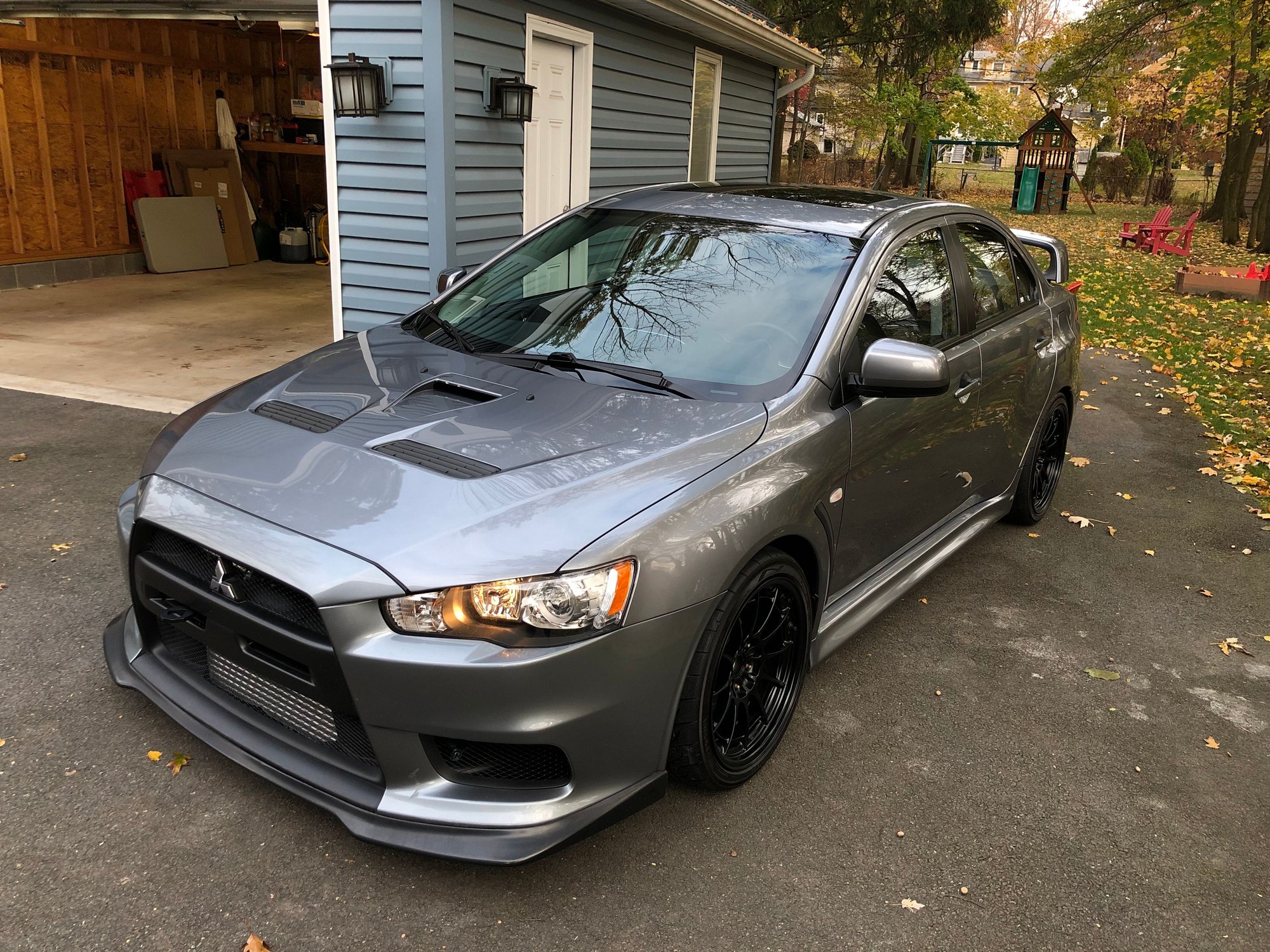

Best part of black wheels is that you can touch up any curb rash with some model paint, lol! ;-)
Or just learn to not run into ****.

Curb rash wasn't from me.
Damn I didn't even notice. Looked light just light hitting the wheel and reflecting.
Who did it? Or did you buy the wheels used like that?

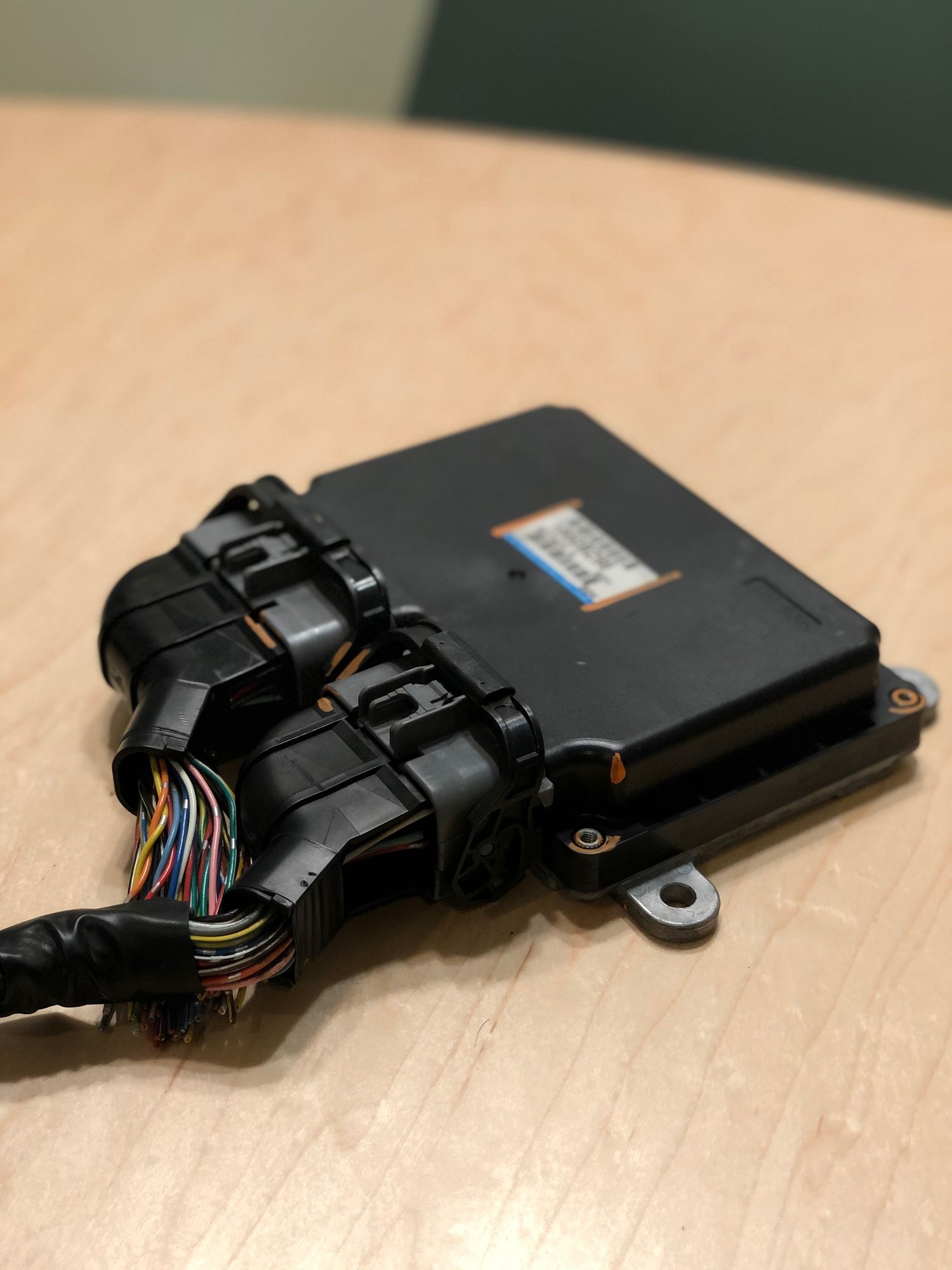

Up to some shenanigans...

That's the ACD ECU isn't it?
Old Nov 8, 2019 | 04:49 AM
  #1462
RazorLab's Avatar
Posts: 14,094
Likes: 1,092
From: Mid-Hudson, NY
nope, main ECU. I actually purchased it more for the wiring plugs than the ECU.
I do have an extra ACD/AYC unit as well though...
