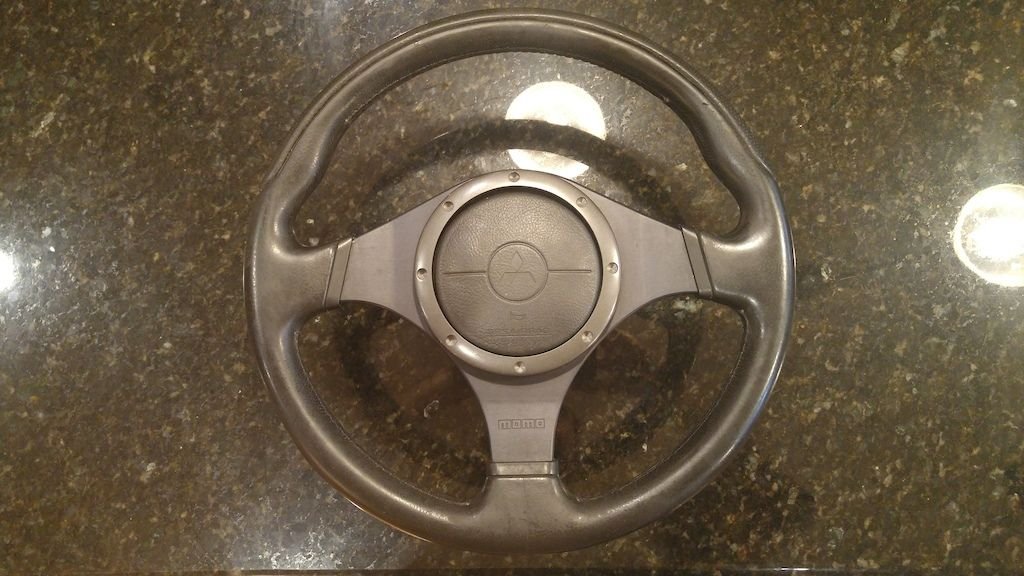

ix bits
I needed a new steering wheel air bag, but they go for near-as-makes-no-difference $200. I found this ix wheel and airbag combo for $240. Alcantara padded wheel cover coming soon

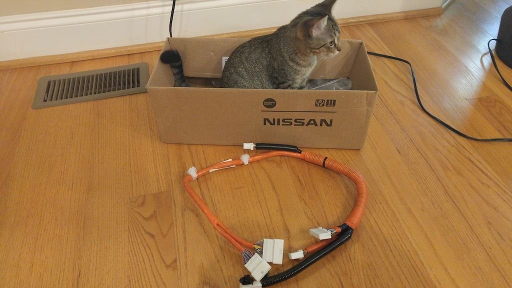

Nissan Parts
I was able to find a new OEM cell tap harness from the LEAF BMS.
I'll splice this into my Orion BMS cell tap harness for a clean look with quality OEM terminations (Nissan cell taps for 48S2P = 96 cells).
Cardboard box also functions as a kitten trap.

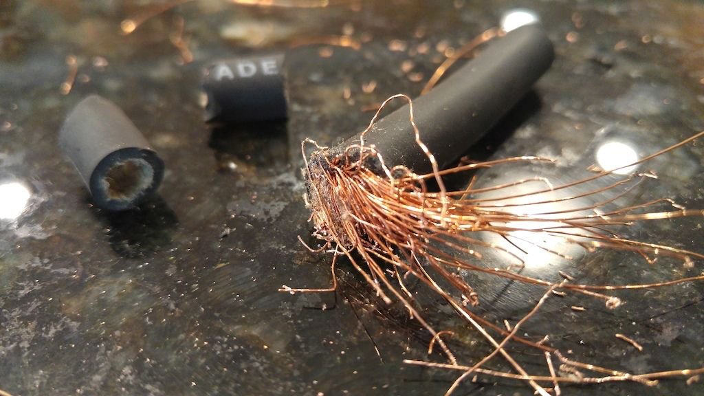

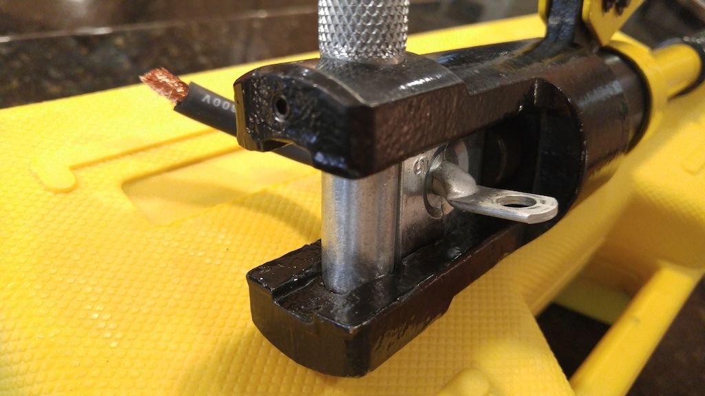

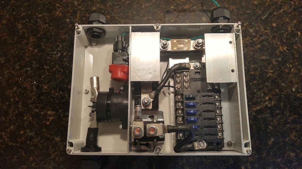

Cutting Stuff
Preparing the contactor/fuse box for installation and further wiring.
Close up of conductor core in 4 AWG cable.
4 AWG is a delight to work with after wrestling with the 4/0 AWG motor cables
Old Jul 28, 2016 | 03:12 PM
  #340
electron bom's Avatar
Joined: Apr 2015
Posts: 375
Likes: 61
From: Raleigh, NC
Contactor/Fuse Box
Remaining circuits will be wired up once this is bolted into place.

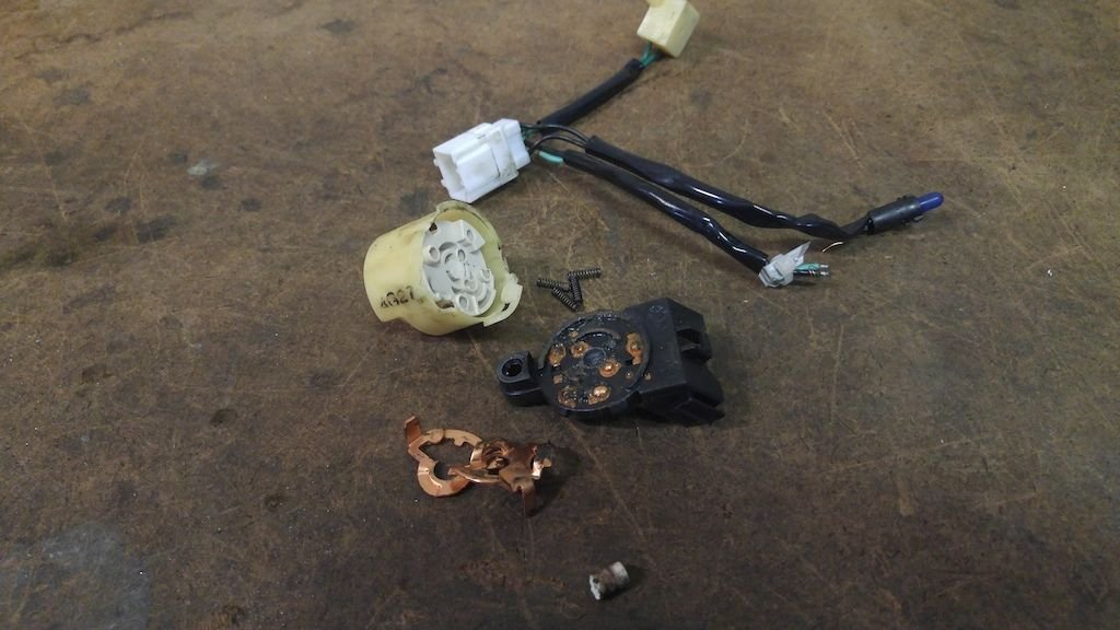

The Cannibalization Continues
I planned on wiring up the key switch today, but it is broken. I ordered another one (along with the entire upper steering column) on ebay and that got me wondering...
From how many different Evos have I sourced used parts?

Anyway, here is a pic of the broken key switch, set back # 36,421.

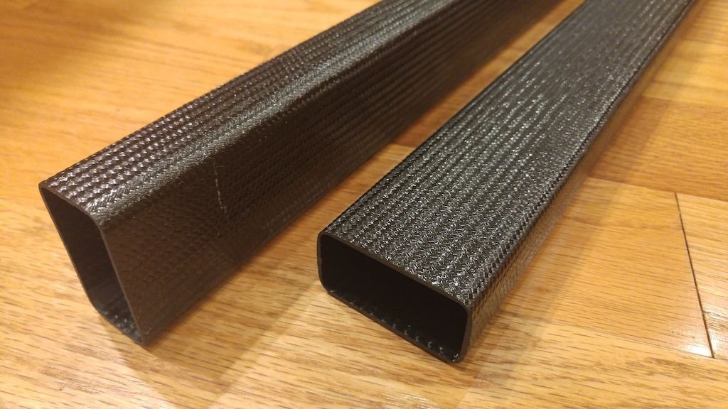

Carbon Fiber
Conduit arrived!
