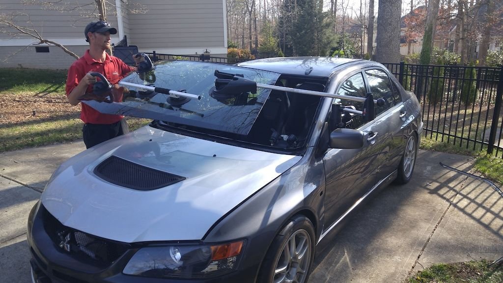

Inspection Preparations
have commenced
Old windshield was cracked badly from the collision, so it had to be replaced.
