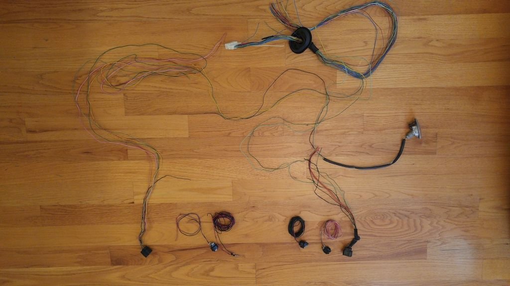

Paring down harness
I don't need most of the connectors or the fuse box, so its time to reduce and simplify.
The amount of material I removed had significant weight. Unfortunately, I lacked the presence of mind to put it on a scale.
All that remains is a headlight harness. I left all the trimmed wires pinned in the terminal connector so I can add onto the harness in the future: temp sensor, rpm sensor, cooling fan, etc.

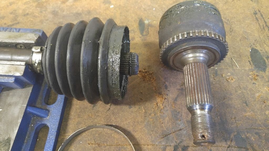

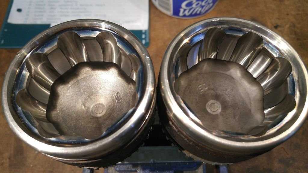

My second-hand front driver's side axle had some stripped threads. I had a spare second-hand passenger axle lying around with good threads, so I endeavored to perform a transplant. Due to morbid curiosity, the process evolved into a CV bearing wear comparison. Since both axles came from similar cars driven in a similar environment, I thought my findings might be of interest to those shopping the forums for a used axle and find themselves wondering how much mileage affects condition (created a separate thread for reference).
My driver's axle, purchased used from a forum member with an advertised 90k miles. Boot has no cracks.
The donor passenger axle also purchased used from the same member, but from a different car with 25k miles. Boot in perfect condition. Notice the threads are in better condition too.

Cups: 25k left, 90k right. Maybe hard to tell from the picture, but the 90k has some slight bluing. It has quite clearly been subjected to more heat.

How did you get the outer assembly off the axle shaft?
With a hammer. It's only secured by a retaining ring, similar to the inner axles. A few well placed taps and it comes right off.
Interesting. I tried to get mine off and it would not come off no matter how large of hammer I used
It looks like it uses a hog ring, like how the inner is secured in the trans or tcase, so you just have to unclamp the boot, and yank it apart.
They can be PITA sometimes, i used axe as hammer one time to separate one that put up a fight, needed few good whacks
