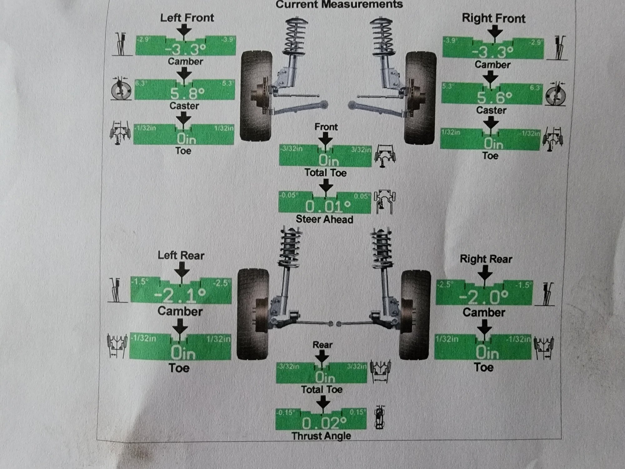

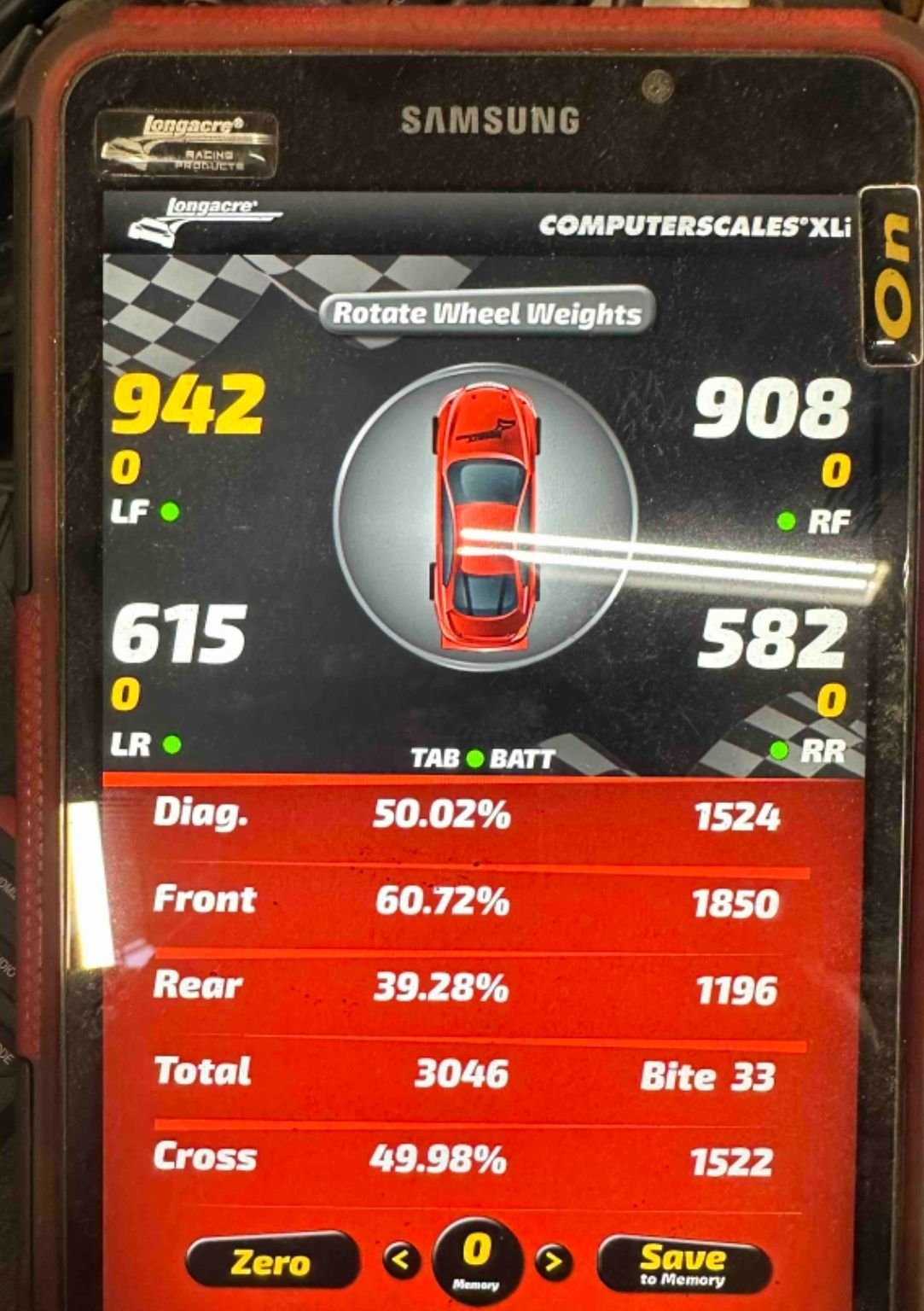

Got e85 in the car after burning off old gas. Well about 1 gal of 93 in the tank. Flashed back my tunes from Devin.
Took car for corner balance and alignment. Surprisingly the car is 2896 lbs without me in it, about 3045 with me. Not bad considering it has the Autopower 1/2 cage in and a full tank of gas. Just going down to a 1/2 tank should be about 40lbs less weight.
Went with 0 toe, and 3.3 F and 2 R camber. Only 5.8 caster but I can add back in more later.
