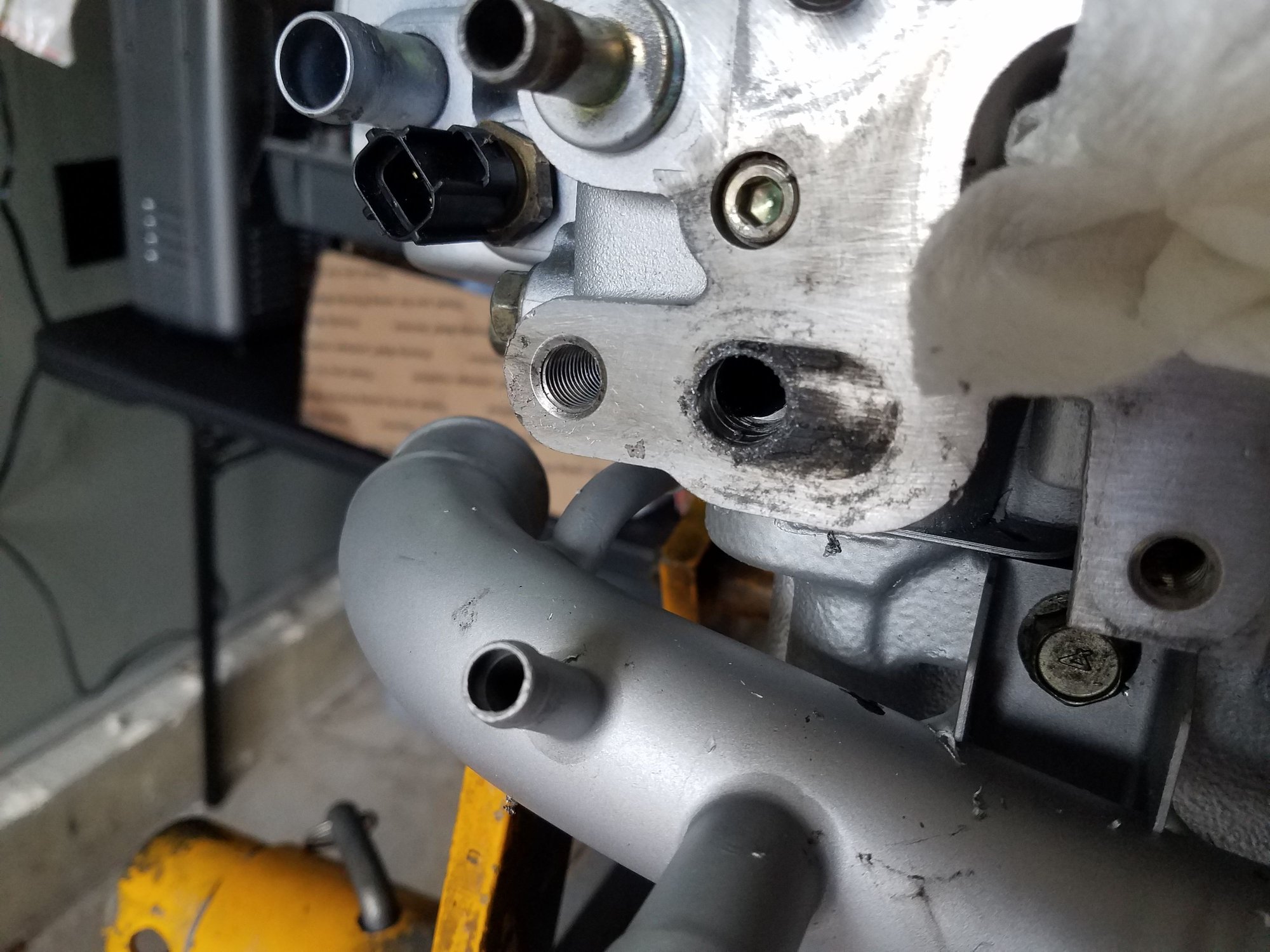

Sitting on the stand and a parts table just about ready to see an engine bay.
But first, we block the EGR port at the head.
You need one of these.
And one of these. The grease helps catch shavings of metal, fyi.
