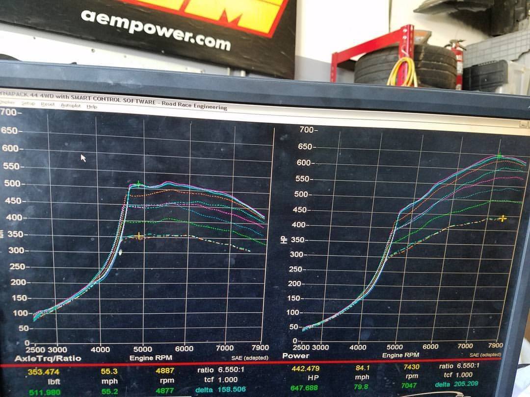

Yesterday was a motor sports masterpiece. Top Gear (now known as "The Grand Tour") has returned. Several of my friends hit the race track for an awesome time and I finally got tuned on speed density at RRE with Rick Barcena
Within the first 3 pulls, the car destroyed its old ethanol record pushing 442hp and 353 lbft of torque using only 91 pump gas! After that I drained the tank and poured in the much higher octane E85, at which point it really came alive.
The 10 year old Mitsubishi laid down nearly 650awhp and 511lbft of torque. All this with a full interior, sound system, sound deadening, and AC! I couldn't be more proud
Injector duty cycle was at 80% with 35 psi, 37psi peak boost and a single hard wired walbro 450. The fuel is there for 700hp, there is no doubt in my mind. We decided to keep it at 650 for the day.
Final dyno graph for 91/E85
I filmed a few short videos for you guys with my cell phone, sorry for the crappy quality. At some points the dB's are too high for the microphone to process so you might hear a skip in audio lol.
The bad news is, the rear diff is toast. It had always made a grinding noise from time to time, but I shrugged it off as normal. After doing the weir 12 plate conversion and bushur diff mounts it became even more apparent , but the oil always came out clean so I kept using the diff. Last night the diff began screaming at me whenever I was in decel. I took it apart today and found some play in it, but the ring and pinion looked fine . The pinion bearing did have resistance to it and it did have a tendency to lock up whenever I pushed it in. Again the noise only shows itself in decel. An RRE shop tech and I found it to come from the back of the car, hopefully we were right. This means the car was making more power than was measured.
Enjoy gents! You know I will after I fix this bad boy.
-pal215
