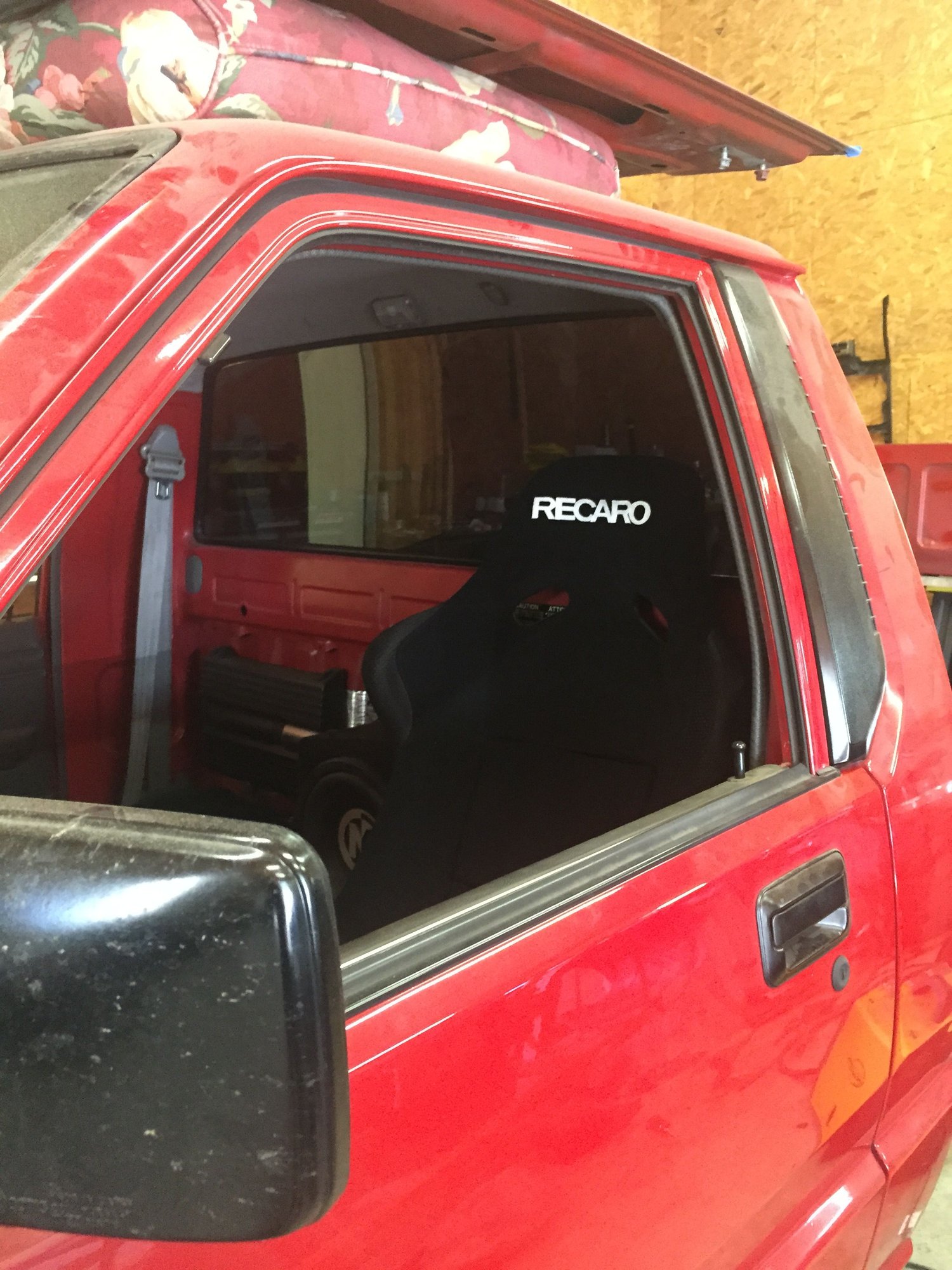

Evo 8 Seats/Center Console/Lancer Armrest/Little sound system:
So I drove the little POS for a while like this until the timing belt finally went. Thankfully the highly coveted 4g64 is non-interference so it was only a couple hours worth of work to get it rolling again. While I was in there I drilled out some of the unnecessary stuff and moved the battery to the bed:

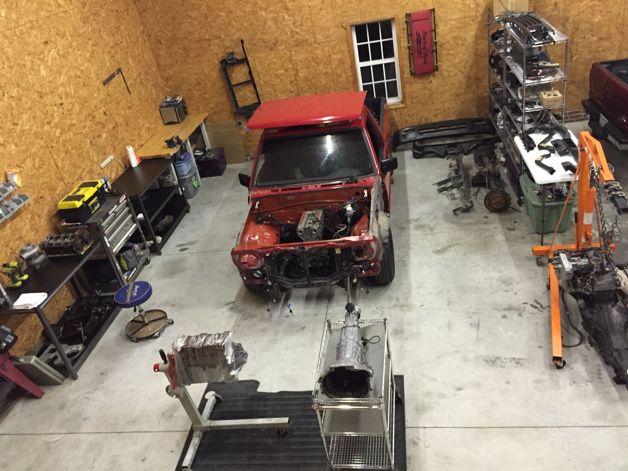

I then cleaned my garage and got ready to get things started.

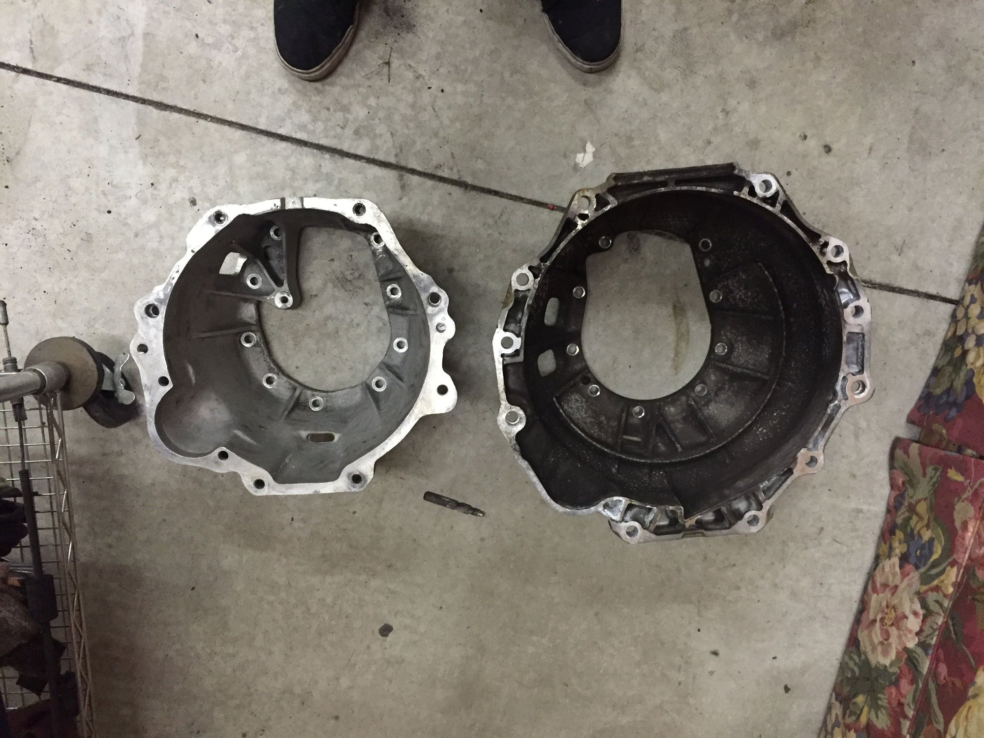

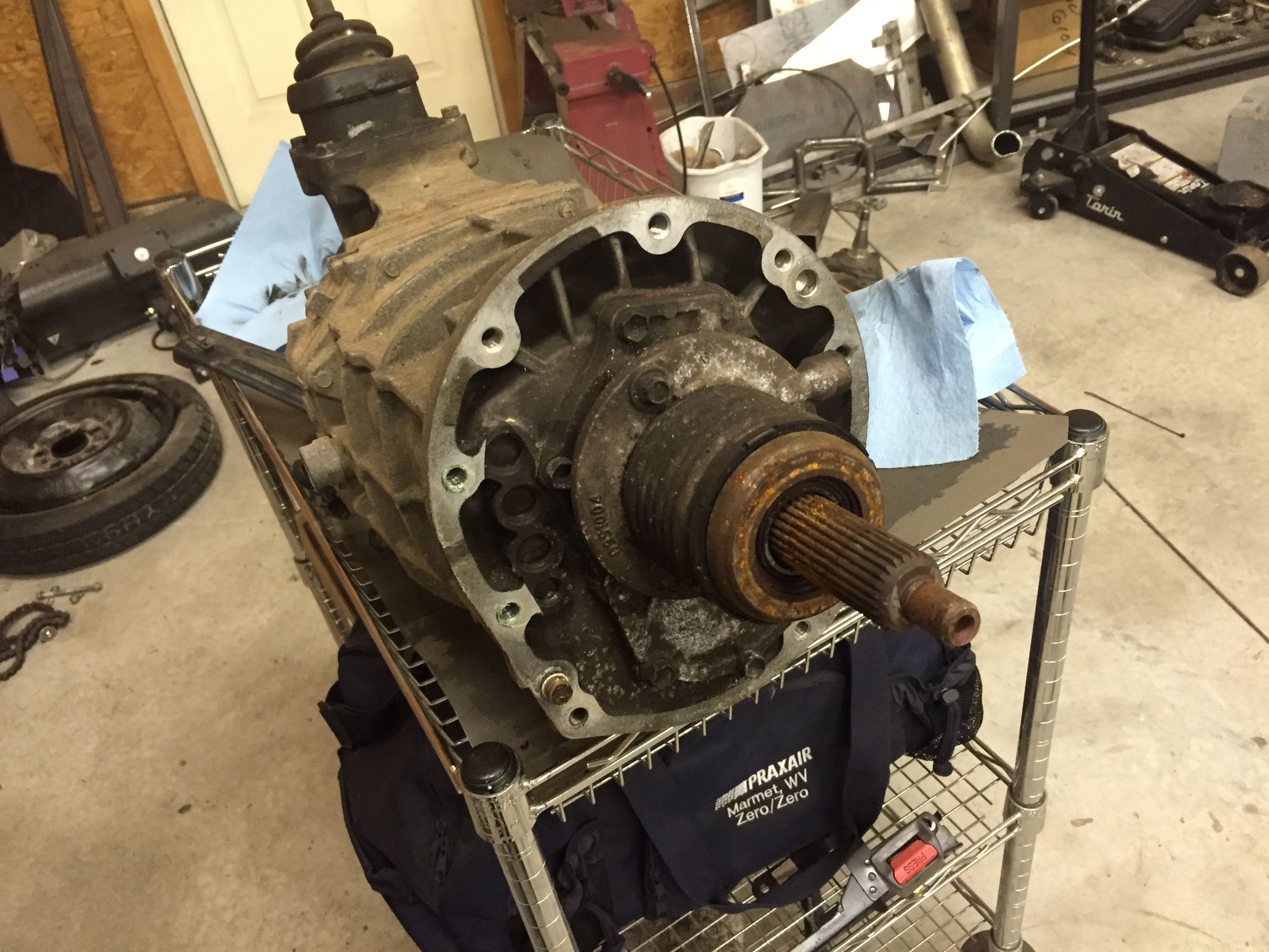

So since the stock km132 trans would have likely lasted 1 dyno pull, I decided to upgrade things earlier than later and sold the trans for $200 to a local guy. In replacement, I snagged a 5spd Aisin AR5 out of a Chevy Colorado. For those who aren't familiar with this trans, it's essentially a newer. better Toyota R154. It has triple cone syncros, shorter gears, a longer 5th gear. and doesnt feel notchy like an R154. These trannies came in Hummer h2s, Colorados, solstices, and Pontiac skys. The main difference is the tail housing length and gear ratios. The length of the colorado trans had me almost the same as OEM and the gearing is acceptable (I think). I located a Bill's r154 to 4g63 bellhousing adapter, snagged the trans off of craigslist, and the rest is history. Now to mate these two up, I had to order a fwd turbo eclipse flywheel + starter, and the clutch disk is eclipse diameter but with a 26 spline GM center. Pilot bearing made to order from mcmaster carr to fit the 4g crank but also the GM output shaft.

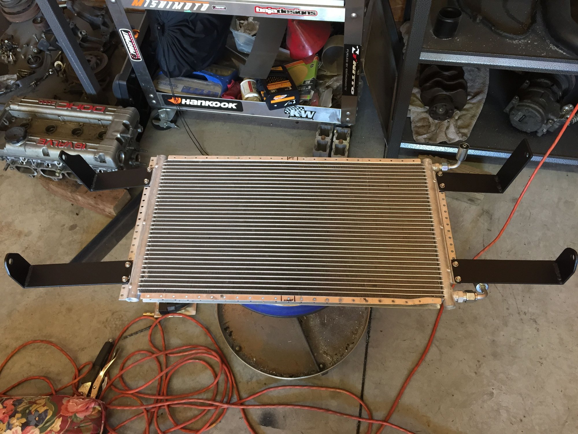

Not knowing exactly how the bay would end up, I decided to do a remote ac condenser early on. This has become increasingly popular and I wanted to give it a shot.

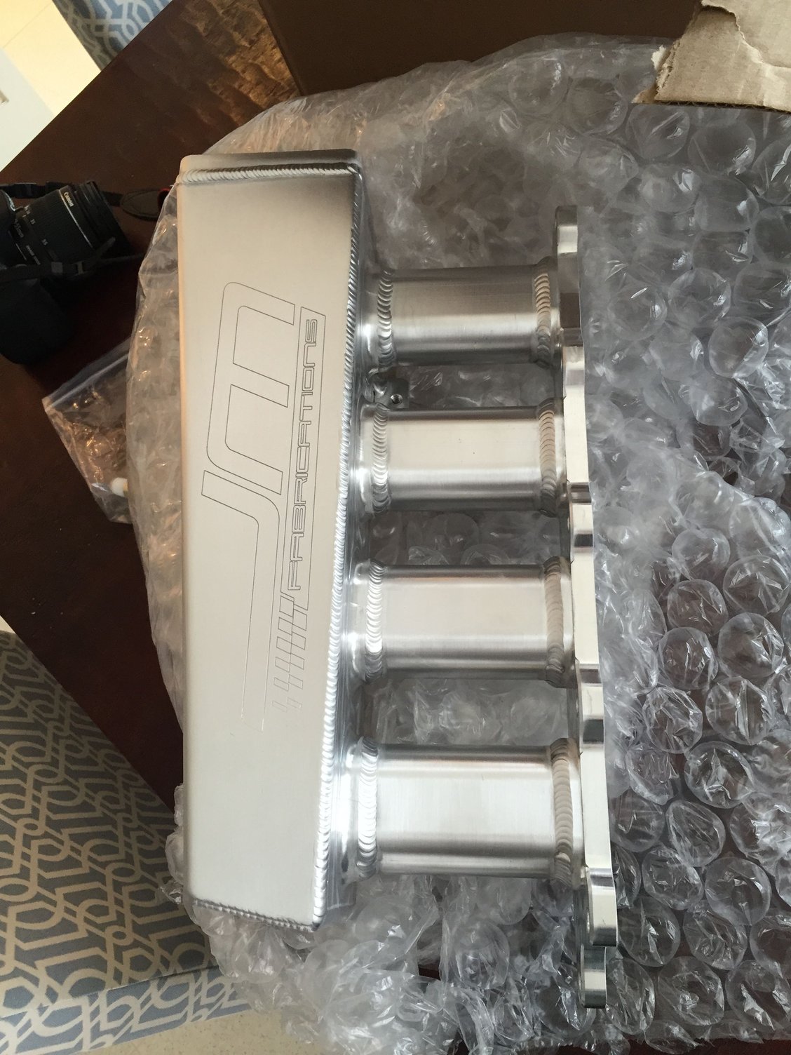

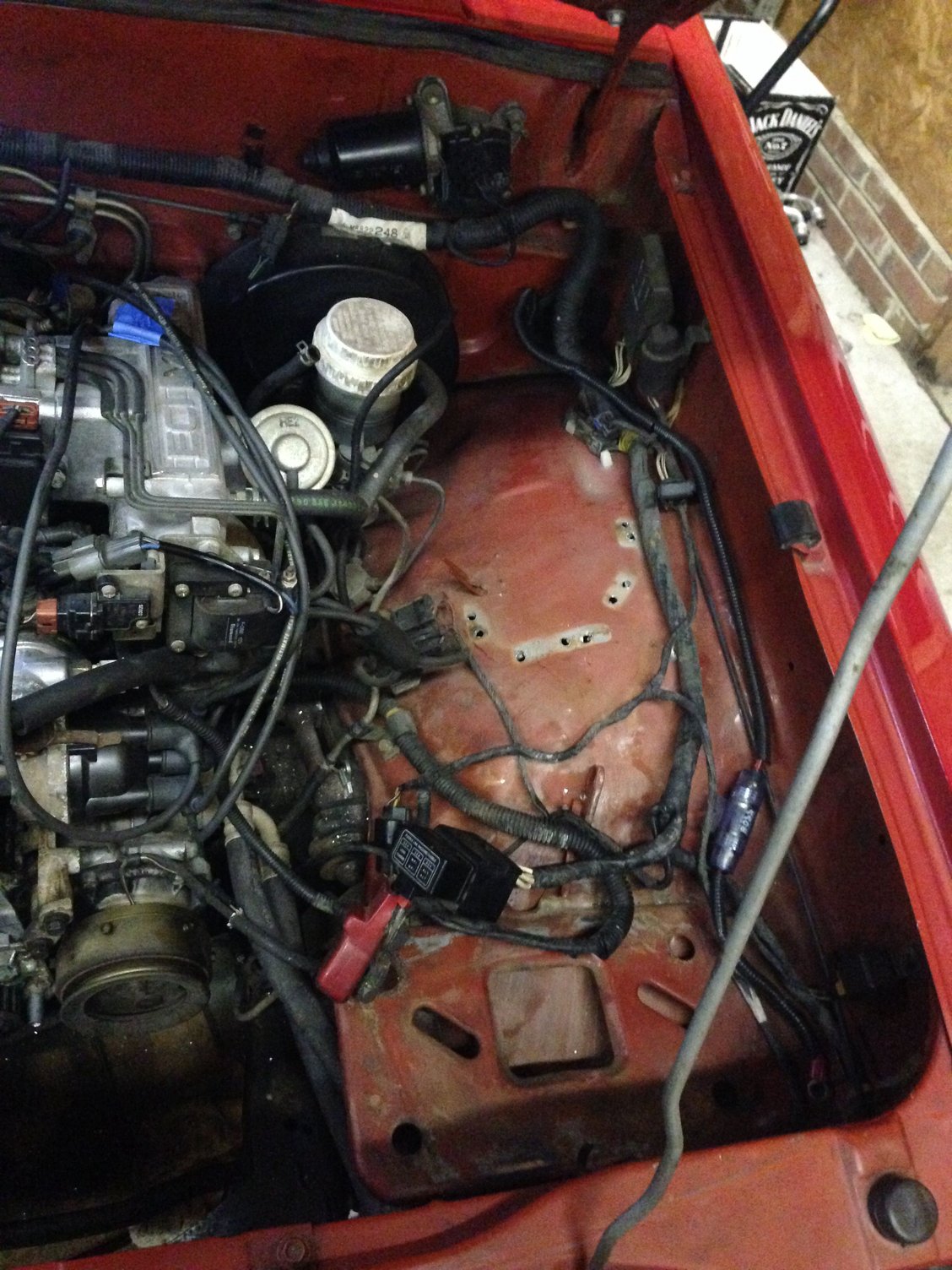

Since I had the rear frame sorted, I moved to the engine bay. Anxious to get it looking like something under the hood again, I ordered a JM Fab rwd street intake mani and s90 throttle body. Really pumped on these manifolds and the majority of people with these swaps modify the stockers to work, which looks like total **** IMO. I'd been toying with the idea of mounting the turbo in a forward facing configuration since day 1, so I mocked things up solely based on where the inlet would fit well in the grill. Setup an ebay intercooler on a jack and proceeded to snap 1 million photos.

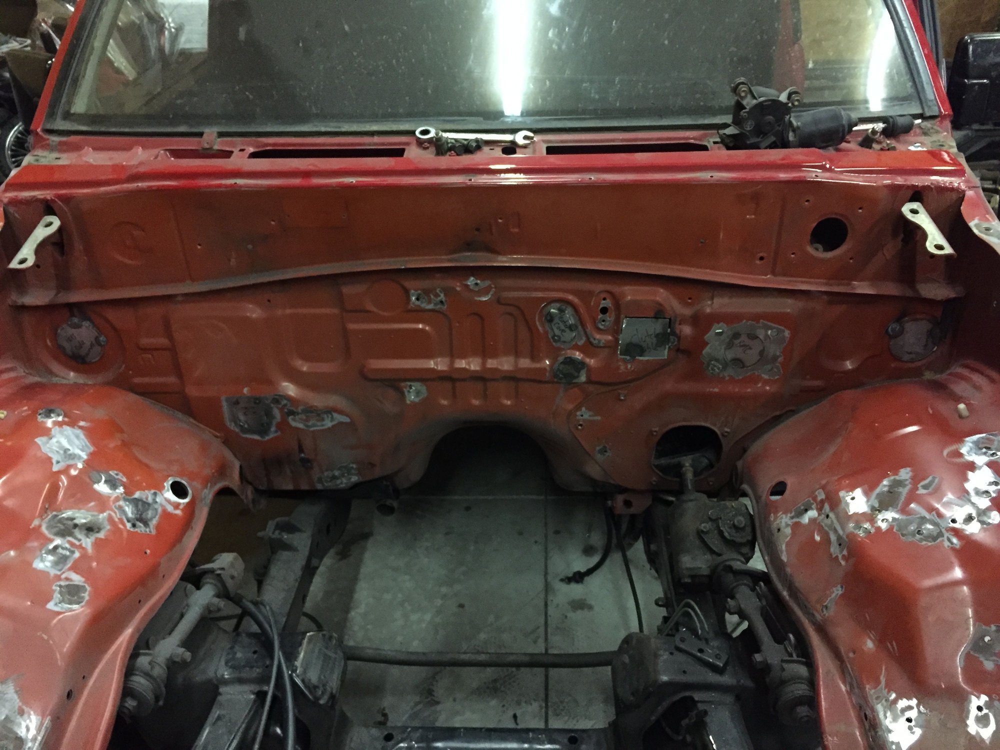

I love tucked/shaved bays so the idea was to do things as clean as possible right from the start. With the ac condenser mounted in the rear and the truck having manual steering, I'd be able to keep things super clean without giving up much. I started welding all of the holes on the firewall shut. At this time, I only had a flux core 110v mig welder, and quickly started to hate it as I was blasting through every piece of metal in my path lol.

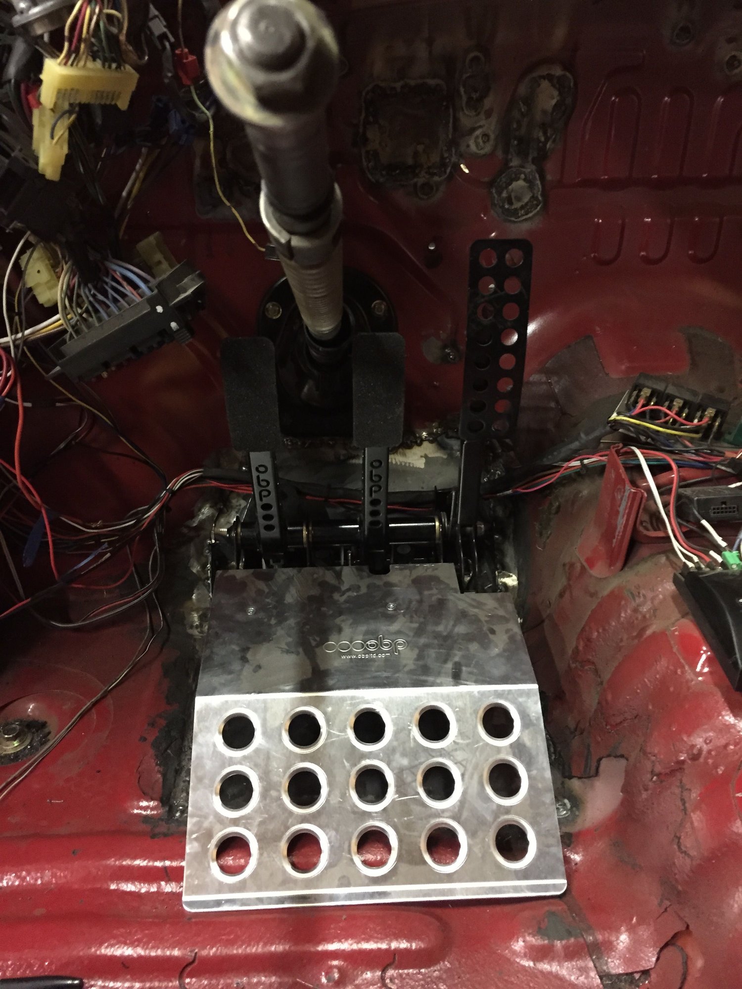

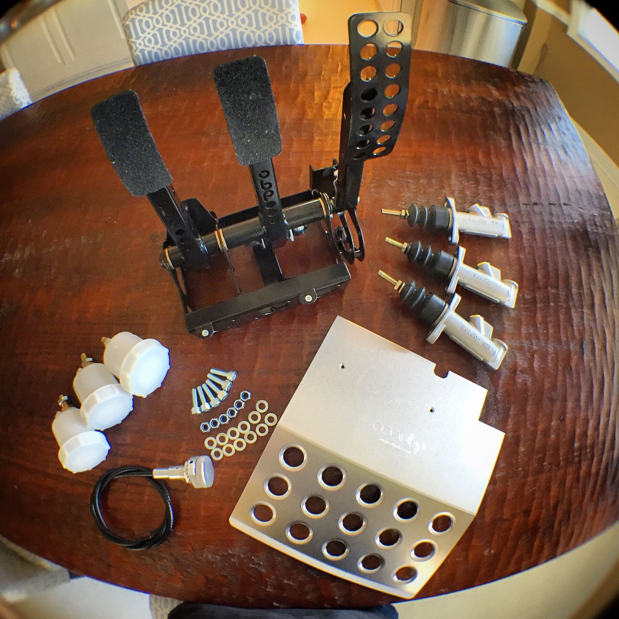

With the new trans having a hydro clutch, I happily removed the clutch cable mount from the firewall. While I was in there, I couldnt help but to hate the lack of intake mani to brake booster clearance. Having driven a few cars with manual brakes, I decided to ditch the power assist in favor of a manual pedal box assembly. This saved me the aggravation of mounting a clutch master cyl to firewall too, at least thats how I justified it.
I contacted Kevin and OBP Motorsports and told him what I was building, he was super helpful and they actually hooked me up hugely on a floor mounted manual pedal assembly. Can't thank them enough.

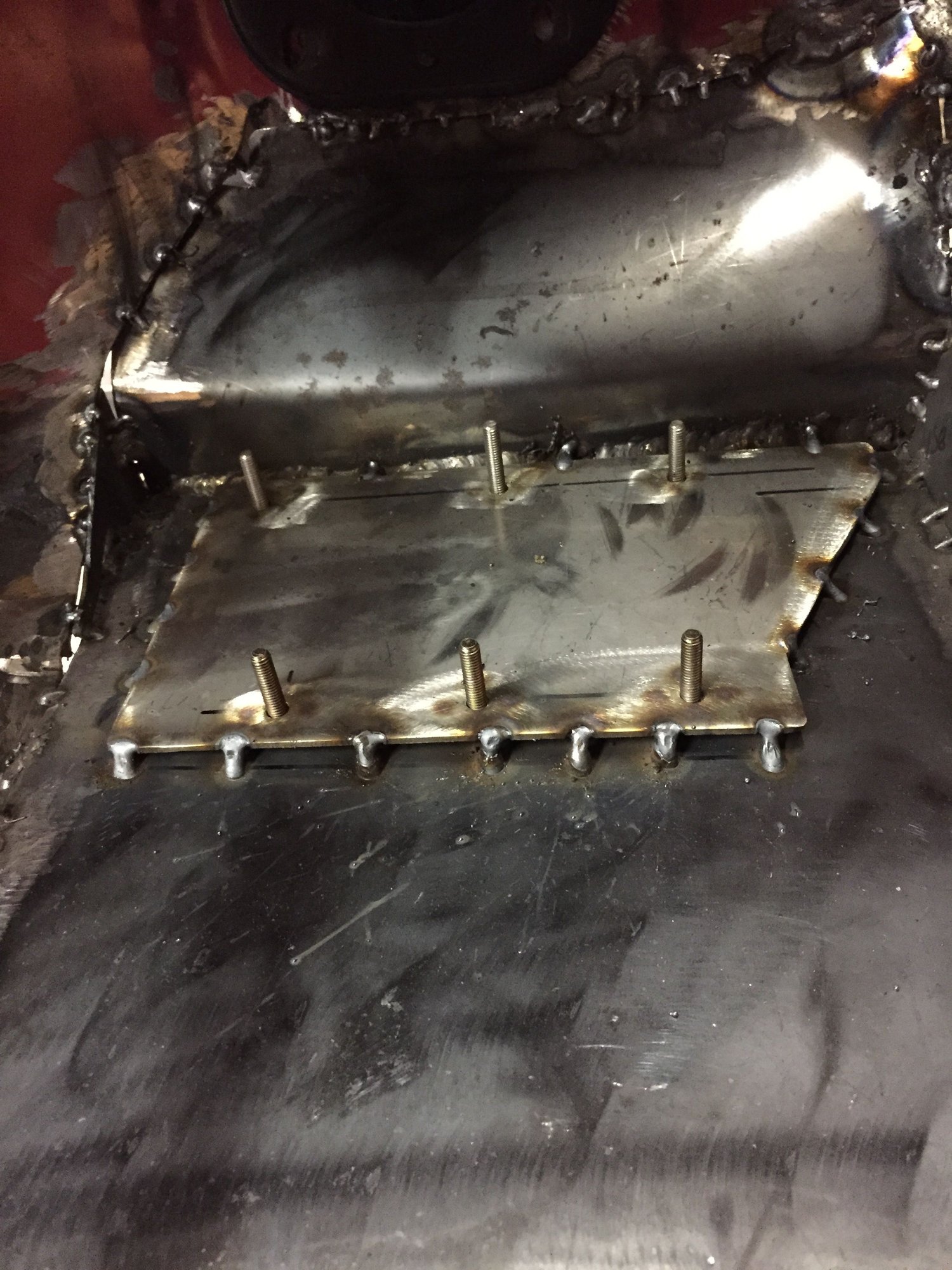

I wasn't super happy with the pedal mounting plate, mostly because the welds were **** and I was using a borrowed MIG at the time, but I had to return it to my friend so it was all I could do in the given time frame.

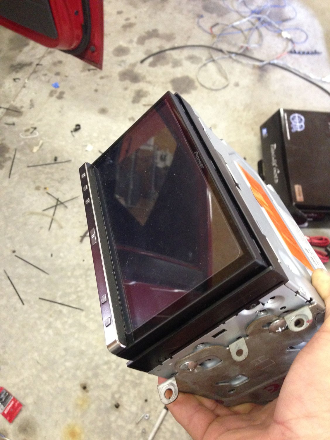

You may have seen them in previous pics, I dont remember exactly when I got them, but I decided on a pair of fixed back SPG seats to keep weight down and save space in the already tight single cab.
The night I sold the evo shell, looked over at the dash from it that was sitting on the floor. I measured it with a tape and to my surprise, it was within an inch of the factory MM dash width. The top of it was much too deep, but thankfully these dashes have removable lids, so I could trim it back to the needed depth and remount it. When its done itll be wrapped in suede. Mounted with a modified oem evo dash bar, I was able to update the interior drastically. Probably one of my favorite features of the truck to this day.
Mocked up with the newer seats, center console, and headunit.

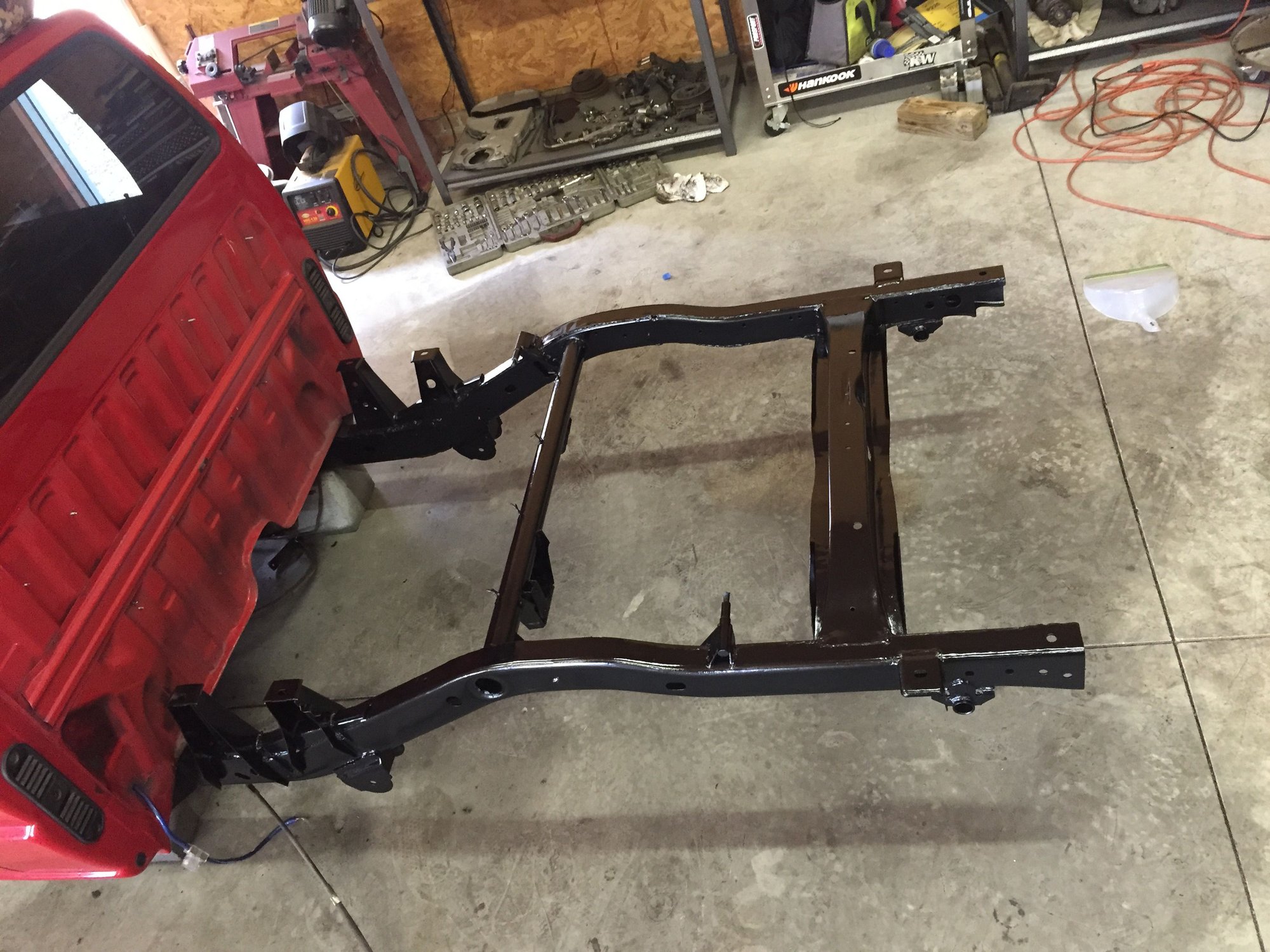

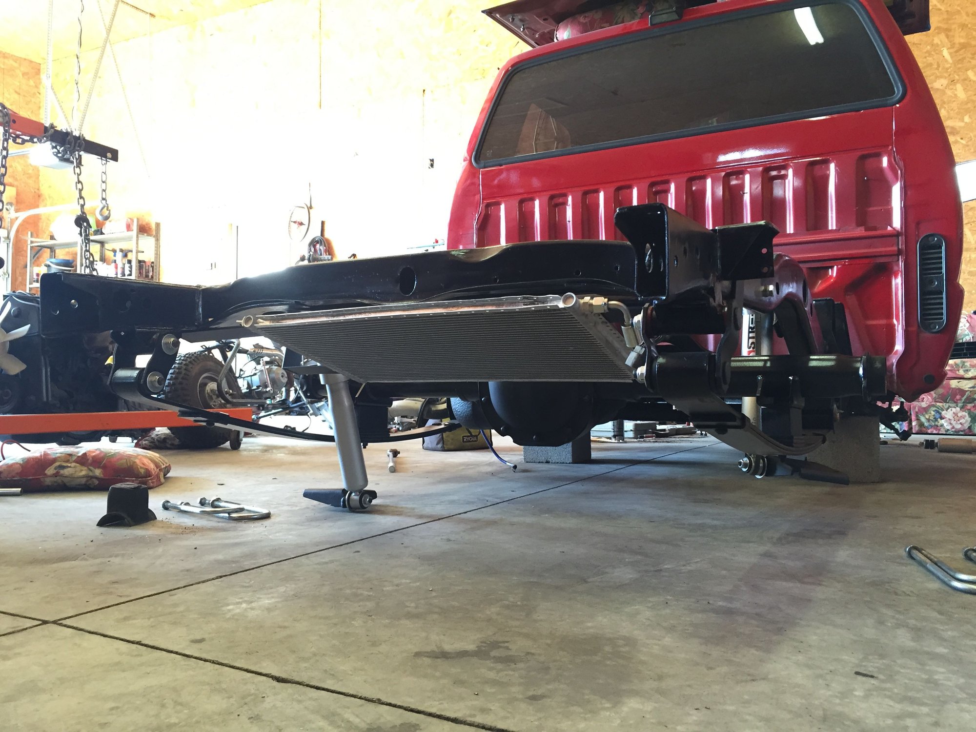

So I had my lowering leaves and struts, front suspension was pretty much figured out, and then I decided to change everything. After pretty much all of my friends were saying it would never hook, and me getting more and more committed to this project, I decided to 4-linking the rear end would be a much better plan.
I started to build my own rear frame with square tubing, adding a notch for extra axle clearance. At this time I still didnt have my own MIG and was on borrowed time. Of course I had no idea how to do this, so I decided to build as much as I could while till keeping the factory frame in place. This would allow me to use it as a fixture or jig so that things could be as close to stock as possible (bed mounts/axle position/etc). I had originally bought a walbro 400 for the stock tank, but with the factory hanger positioning it at the front of the tank, I opted to switch to a fuel cell. Figured the cell would be safer and allow me to move some of the weight back over the rear axle.
I dont have any pics of it all welded up, but honestly you aren't missing much.
The truck kinda sat like this for a little while, and I never completely removed the OEM frame rails because I just wasn't happy with it. I was able to put the bed back on to save space and cut out the wheel tubs to see what kinda tire options I would have. Mostly I was just bored and the truck ended up sitting for a little while. I got a lift during this time, and somehow ended up with a GS-T too. Didnt have it for long.
Would it have worked? Ehhh maybe.....but I just kinda hated it. I also used 2x3 square which isn't really recommended on street trucks and especially those without cages. Not to mention it just didnt look clean with all of the cuts and welds. I was able to sell all of the new suspension stuff for close to what I paid for it, which is pretty insane considering the mighty max community has about 6 members in total .
While looking for a rear link setup, there were lots of things to consider. Do you want the bars parallel? Triangulated? 3 link? 4 link? Air bags? Coilovers?
Of course I want this truck to hook, and I don't have any desire to head to the mini truck meets, so bags and non-adjustable links were out of the running. I knew I needed coilovers, 4 links (+ a panhard), and room for some tire. I was browsing Ebay and found a company that sells entire rear frame kits. These kits are built to order per your measurements, use mandrel bent 1 piece 2x4" frame rails, and come with everything. 4-link bars using QA1 spherical ends, QA1 coilovers, and most of the hardware. Since I already hated my setup, I pretty much just said **** it and placed my order. A couple of weeks later it showed up.

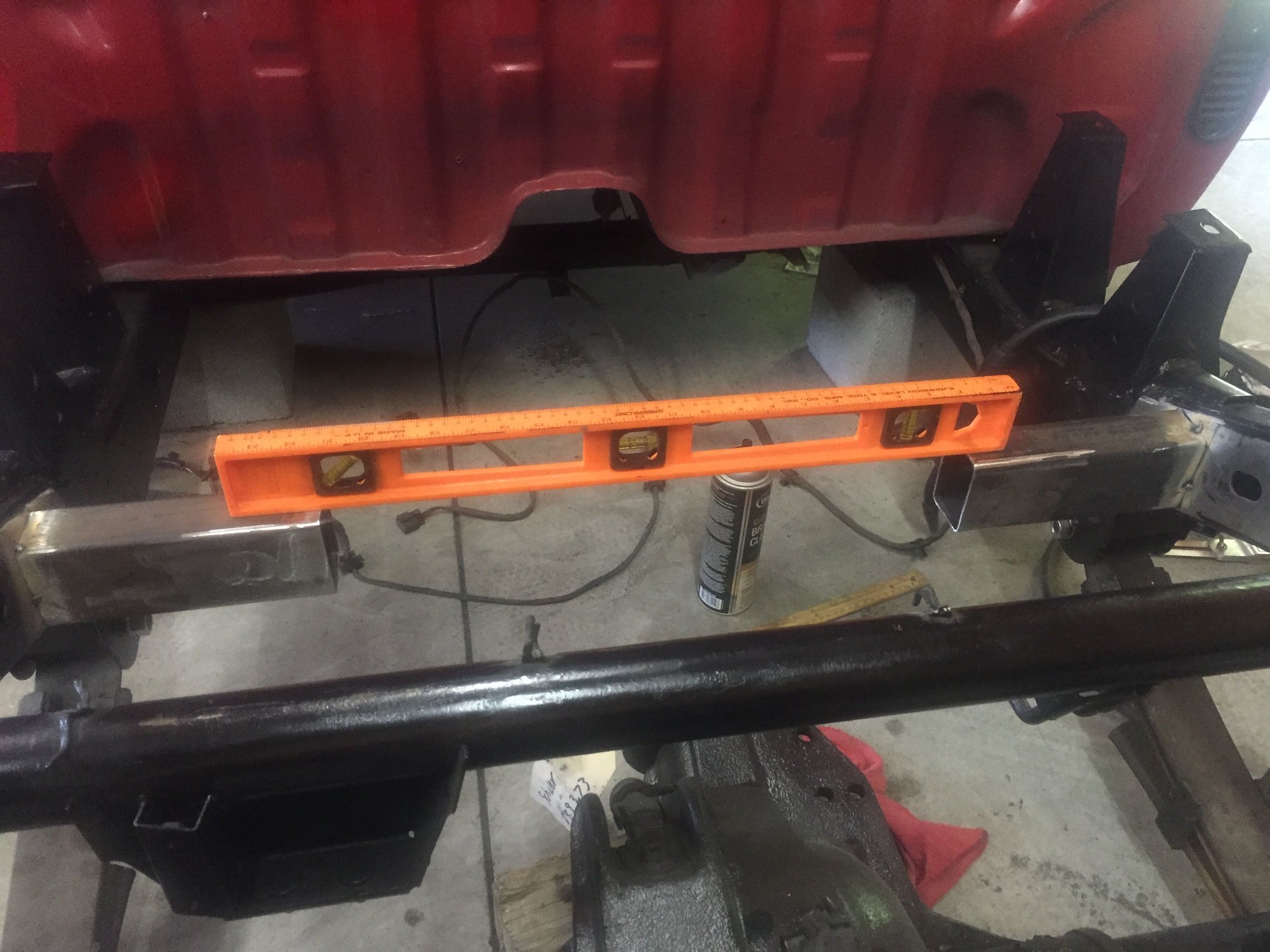

Of course nothing goes to plan though, and although they were okay with my frame rail width measurements, they never told me that it wouldnt actually work with my axle. With the frame rails as narrow as I had them, the weld-on 4 link brackets wouldnt fit on the axle housing due to the center diff width. While they did send me new brackets, I still had to deal with cutting off the existing ones and moving the mounting points to the outside of the frame rails. Wasn't very fun.
First, I set the frame on the existing setup, just to kinda see where I was going and what I had gotten myself into. This was pretty scary for me, mostly because before I built the new rails with the factory frame in place, and now that wasn't an option. It's all pretty basic, but I had a lot of things to watch. Frame was too wide initially, so I had to cut it down. I don't have a porta band, but was able to make it work haha.
Once I got the frame width correct, I took the plunge and got it set into place. I left the factory leaf springs in position for as long as I could, so that as long as I kept things straight, I wouldn't lose my axle position. Changing the wheel base was not an option, mostly because the bed might not fit after
