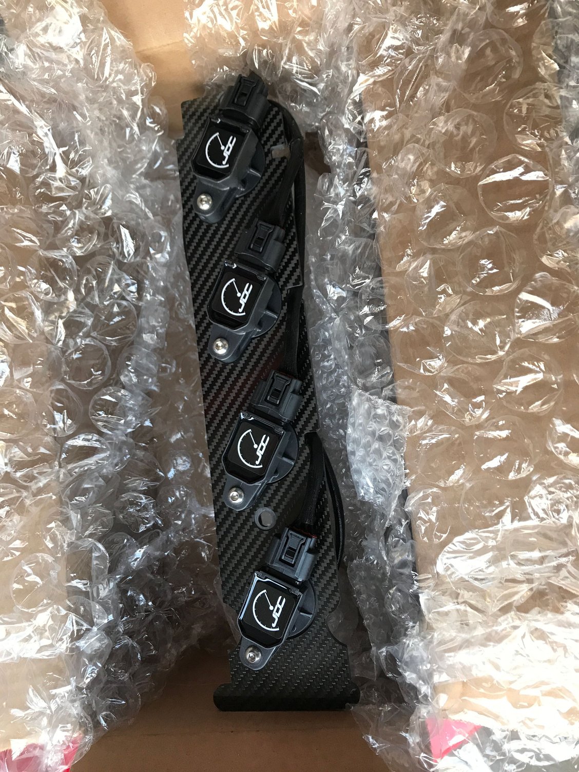

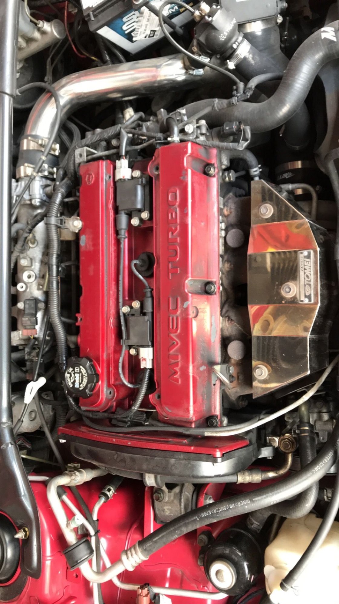

Thankfully that has all changed thanks to great black friday deals from JD Customs! I ordered myself a coil on plug conversion and hoped and prayed that it would solve my issues. After installing them I can say that the Evo is running again, and better than ever! From the first start up I could tell that the Evo just had a better sound and idle. Being able to drive this machine worry free after so long is beyond satisfying. I am hoping to keep posting more updates on the car but everything has just been so busy. Either way, I will post here whenever and as much as I can... Here are some pics of everything that was done.
Beautifully packaged shipment by JD Customs
The OEM coil plug set up that lasted about 105k miles. Thanks to KT motoring for the tip to replace them as it is a common issue at this mileage. Being that OEM coil packs would have cost me just as much, if not more, than the coil on plug conversion I figure why not go for the upgrade.

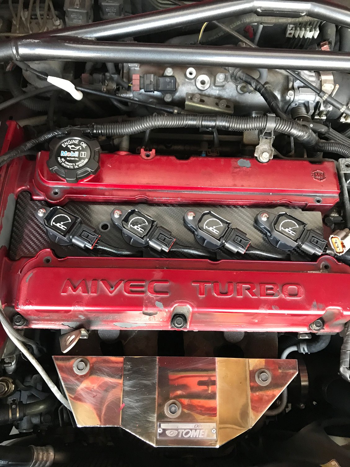

Dropped in perfectly with no issues what so ever!

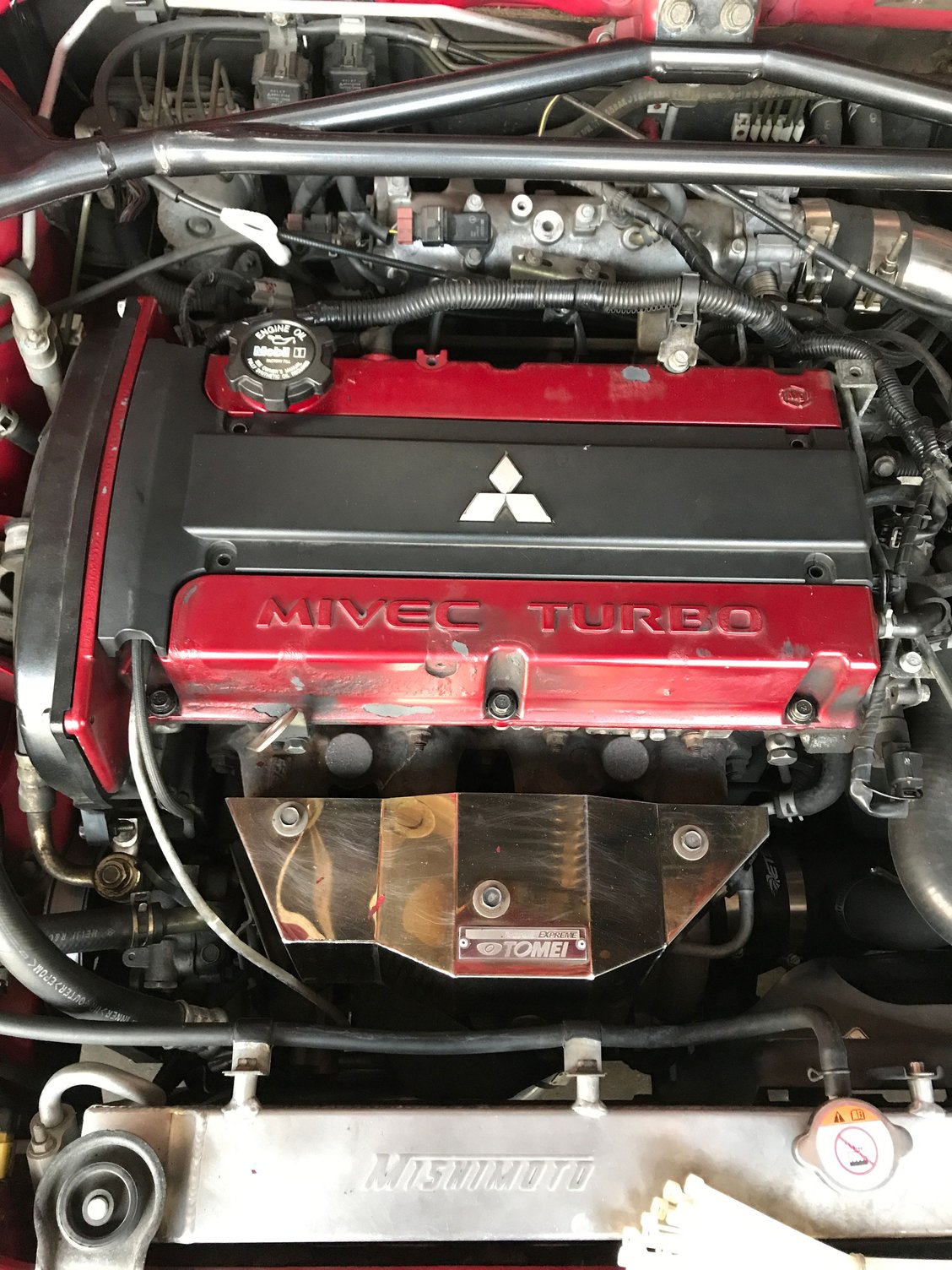

Decided to put the OEM cover back on for that "sleeper" look.

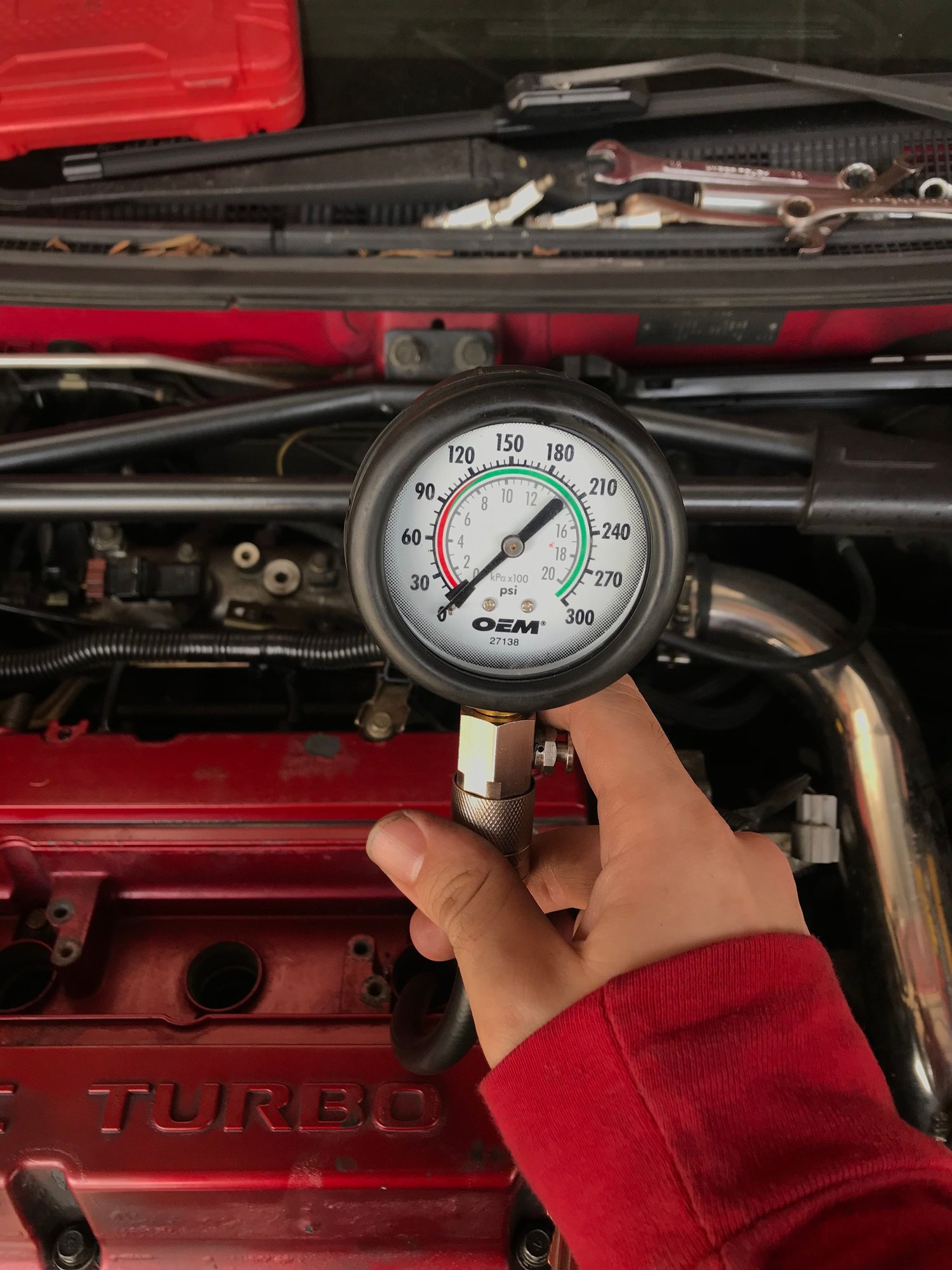

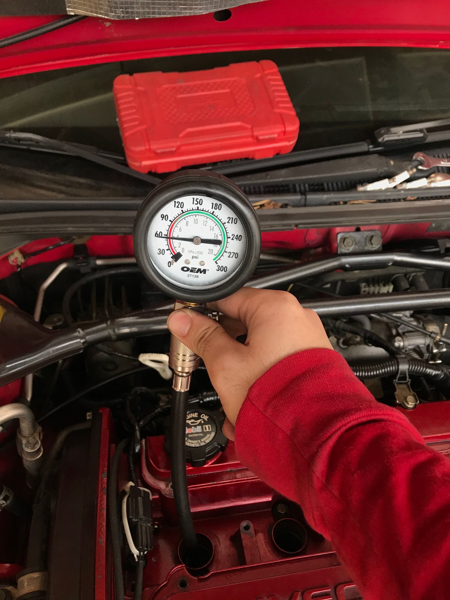

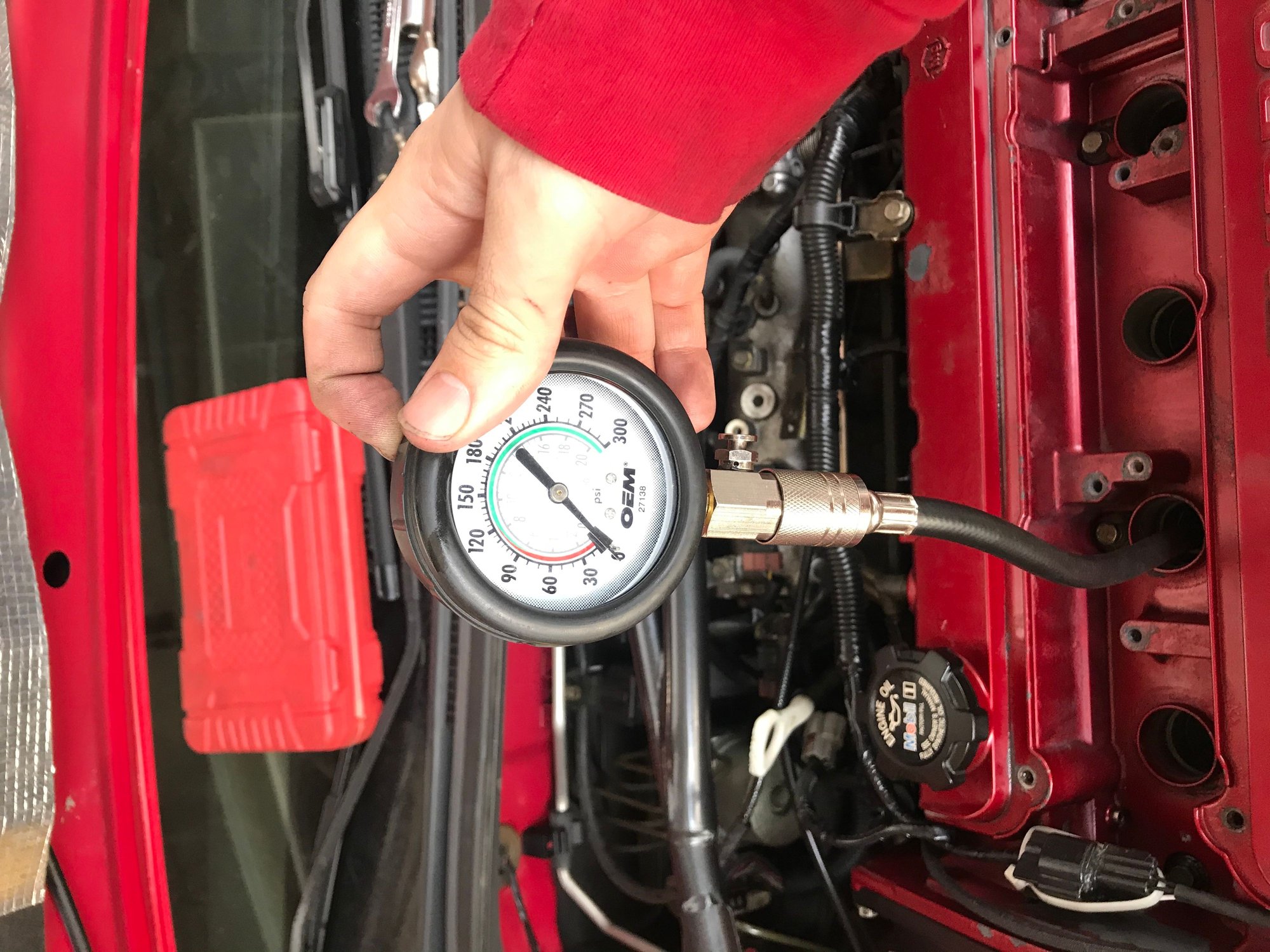

I can't believe how long it has been since my last post but I promise you it is for a good reason. Two things happened in January, one good and one bad. I think I will start with the bad.

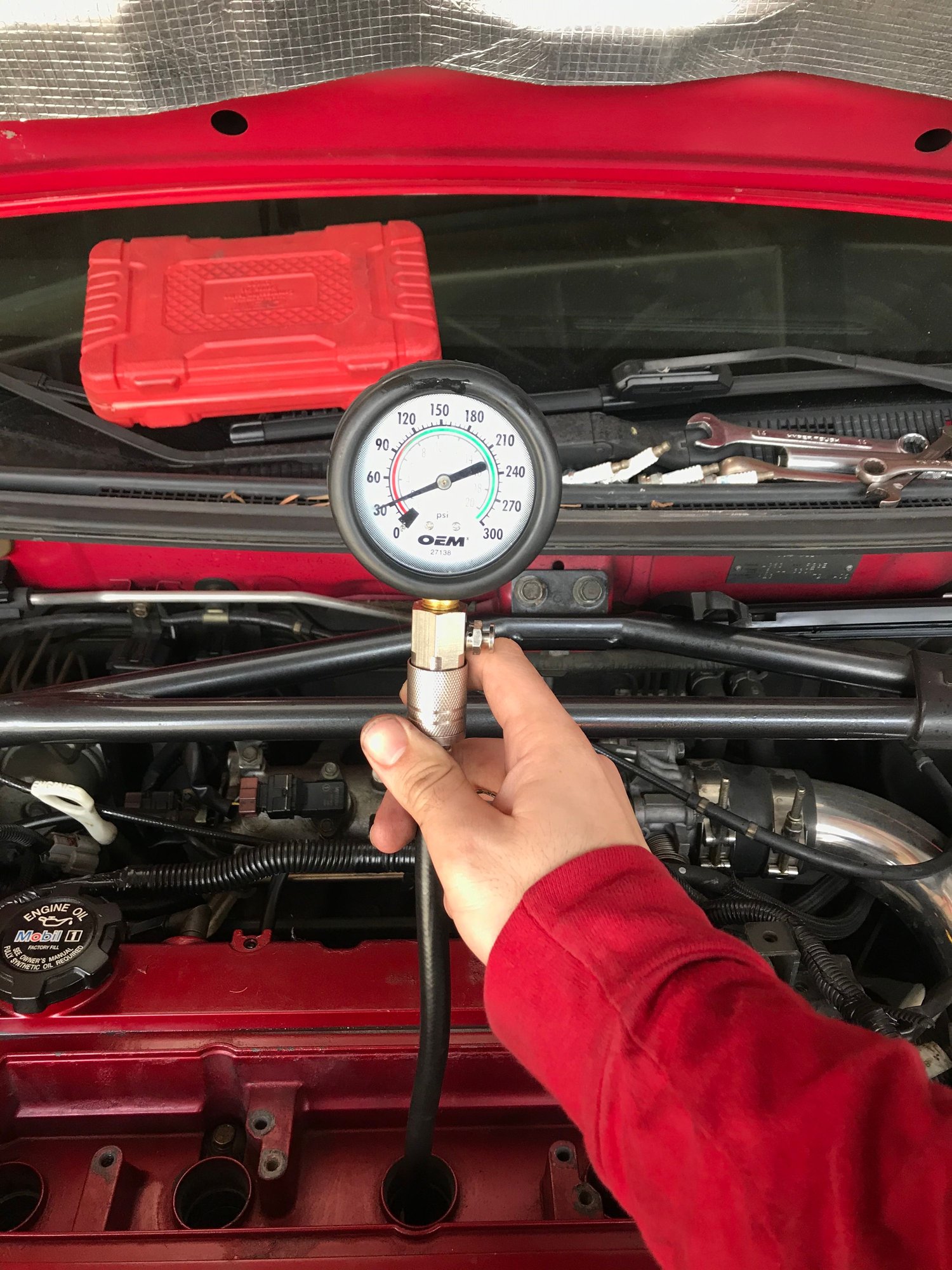

In January, I wake up to a text from my younger brother at 4am pretty much saying that he took my evo out on a date, was driving crazy fast on the highway, and now my evo wasn't running. Not wanting to believe what I read, I simply ignored him and went to check out the car the next day. Upon initial inspection there was oil all over the engine bay, and floor of my garage so I immediately thought the worst. After talking to my brother, he said he was going about 160mph on the freeway, threw the car in neutral to slow down, and the engine just died. He said he was able to crank it a few more times and drive it home (less than a mile). That gave me comfort that there isn't a hole in the block! And upon a quick inspection I am comfortable there isn't.
Being that I have been crazy busy with work, I haven't had a lot of time to check out anything and the Evo just sat in the garage collecting dust. All I could do was talk to @SoSoEVO and tell him how much I missed the car and that I couldn't wait to fix it. Fast forward to April, my work hours have finally settled down and I had time to do a compression test. My hope was that my brother simply lifted the head and all it would need was a head gasket job and studs. I drained whatever oil was left and noticed it had a greenish hue to it, smelled pretty bad, but was not super milky. I checked the radiator fluid and thankfully it was still green! Another good sign was that when I drained the oil, I noticed no metal shavings. The only thing that scared me was that the spark plug on cylinder was seems to still be broken off even after my coil on plug upgrade. Anyways, compression tests came back as seen below...
Cylinder #1
Cylinder #2
Cylinder #3
Cylinder #4
As you can tell, there is no type of compression being made. Hopefully confirming my theory that the head lifted. Now I am stuck with what my next step should be. I want to take it to a shop to get a leak down test and they can tell my exactly what the car needs and how bad the damage is. If anyone can recommend any shops that would be appreciated! Or if there is anyone who has built their own cars and is local to Long Beach, CA area let me know and I am more than willing to pay you to check it out. I just want to get my car running again.

Have you checked the timing belt / timing marks?

I'm agreeing with biggie. First thing to check is the timing. If it's off, well let's hope it didnt bend any valves. Worst case, the head is coming off.

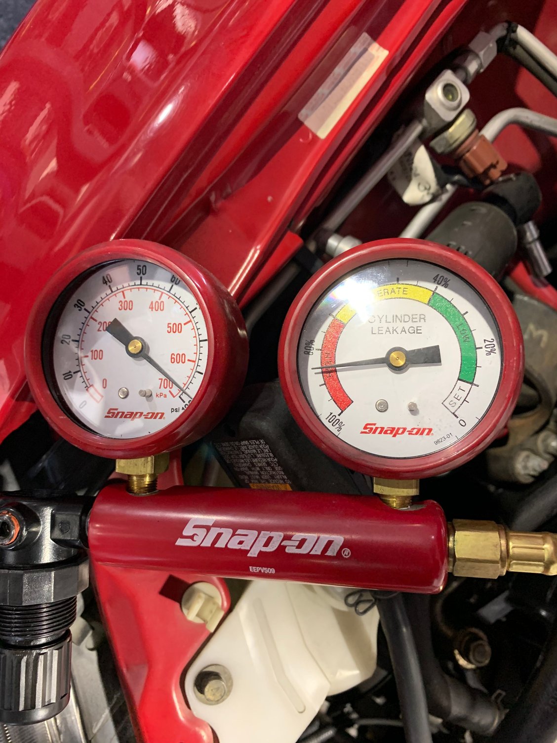

I just realized that I never gave you guys an update after getting taking my car to my good friends over at Raw Power Motorworks (RPM) in Long Beach, CA .

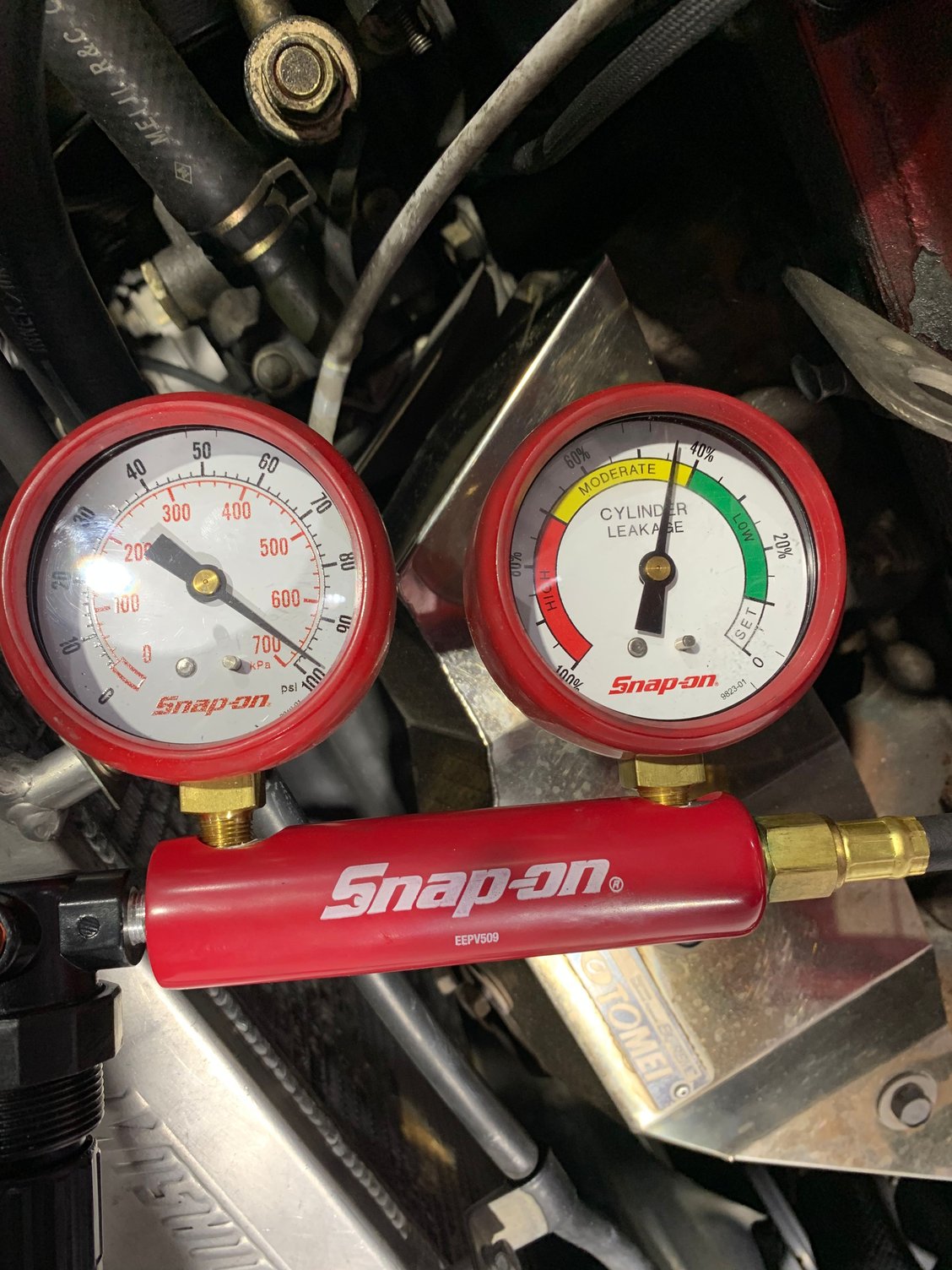

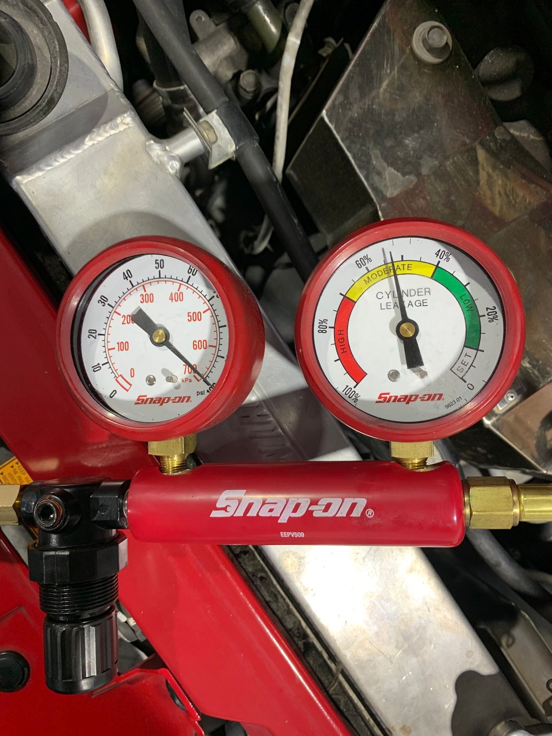

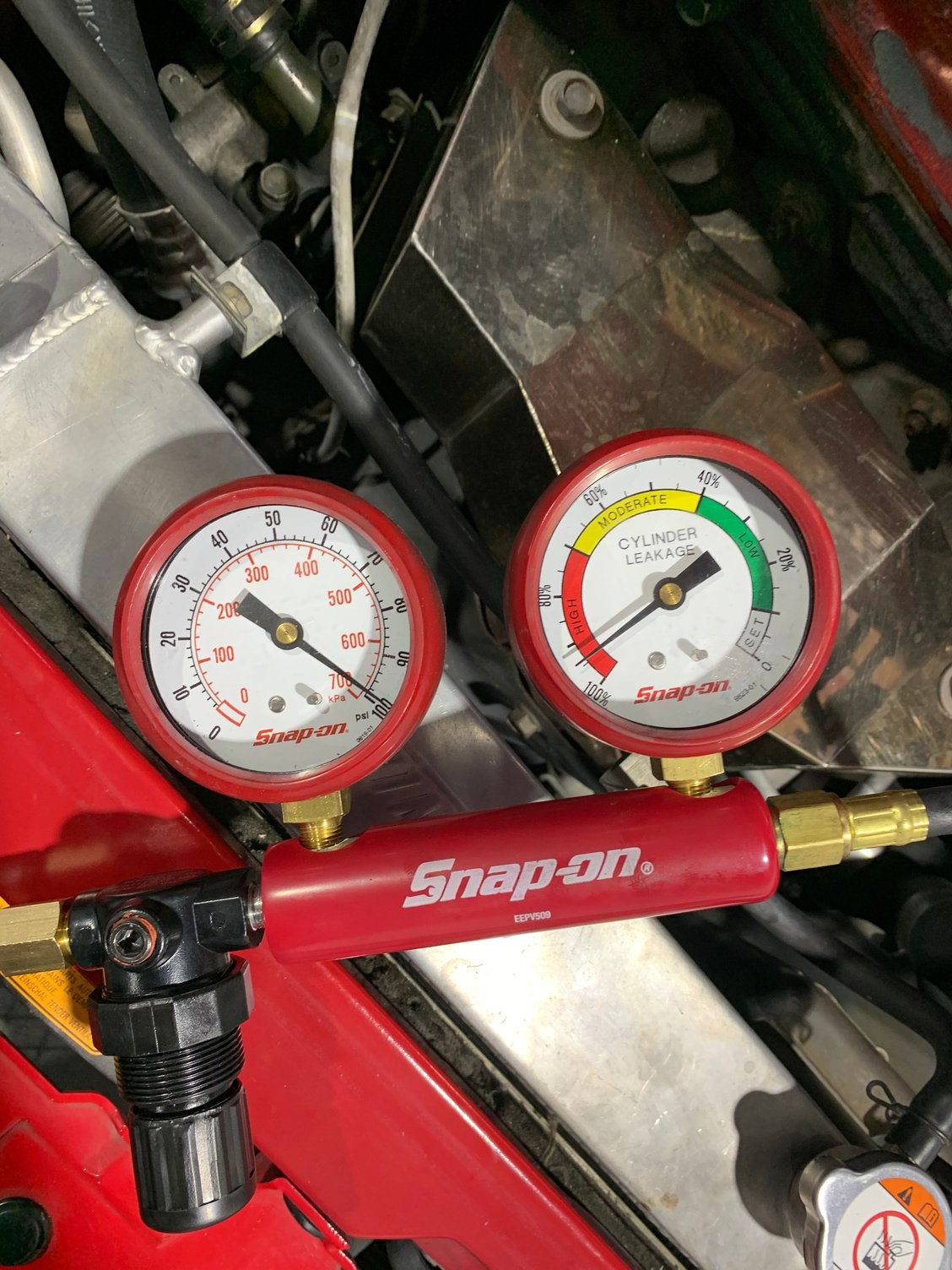

I towed my car to RPM and they ran a leakdown and compression test on my car. I already knew that the compression was horrible on the car but wanted to get a leakdown test done to get a better picture of what is going on. After RPM did their thing, the results were truly heart breaking. Two cylinders had practically 100% leakage at 100 psi and the other two were not any better. I can't add videos here, but RPM but a small bag over the oil cap hole (not sure if thats the right term) on the valve cover and it filled up like a balloon.
When I initally found out the news, I was crushed! This was much worst than I initially thought and of course will cost more dinero! BUT being the optimistic person that I am, I looked at this as an opportunity to get the Evo running better than ever. The car just hit over 100k miles and it was going to need some maintenance done to it either way.
Being that the short block will pretty much need to be redone, I spent countless hours debating what I wanted to do. I could either go the fully built route, or an "OEM" spec rebuild. I chose to do something in between, which will consist of the following:
