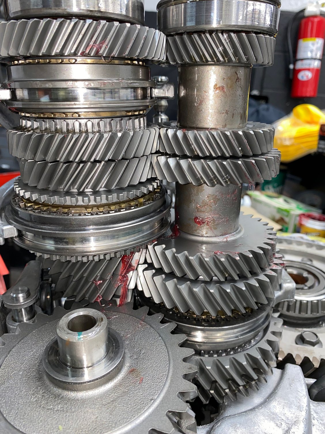

Ooooooooooooohhhhhh, it's been so long you say? Did he rack it again you say? Some crap about porridge and bears you say? WELL NONE 'O THAT, more like saving me sheckles for that thing about making my car live longer than me. To that end...well I don't have pics of sensors but believe you me I got a passle! New MAP, front O2, all ABS(only need 1 but future needs), cam sensor and just to have a MIVEC solenoid.

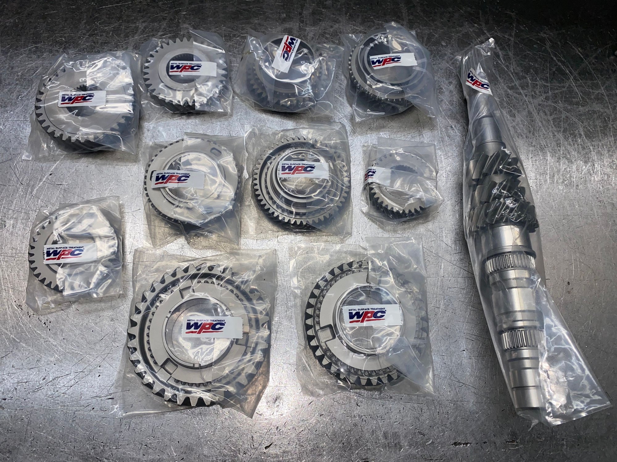

The big deal deal of biggness is the fricking trans-the hell-mission! Built, ready to ship, pics but the video no bueno other than sound. Ooo-la-la they say!
Yes, it is a 6 speed. Yes it is best for me and what I like. Yes the rest of driveline is gonna happen but c'mon, I'm a peasant with a quick car...and a GF who sorta likes the car? Next will be t-case but that's next years big budget thing, so if you got a cheap ACD unit I be looking about November. Enough squawkin' THEY SAYYYYY!
Some tranny guts and ***** to woke blah blah, do I look like I got programmed to frickin' feel!?!
Hard, durable, fancy tranny guts I say!

Wow, super nice pieces / parts. Youre doing the trans re-build yourself?
Haaaaa, my current ball size isn't up to that, shop costs are the least bit of this so no point risking messing it up myself. Plus shipping a big box was cheaper than separate items, I looked and it ended up being same price at Jacks to get it built vs collecting parts to try myself. So I went for treated gears. Immortal car or some such folly. For longevity I also went brass vs carbon synchros.

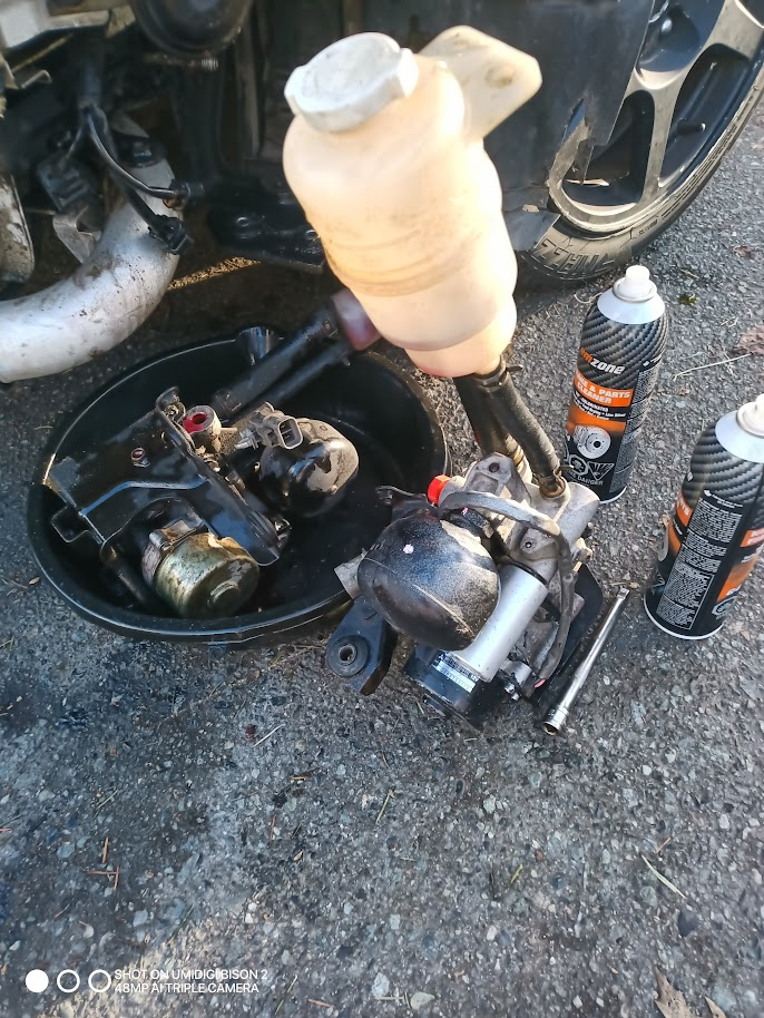

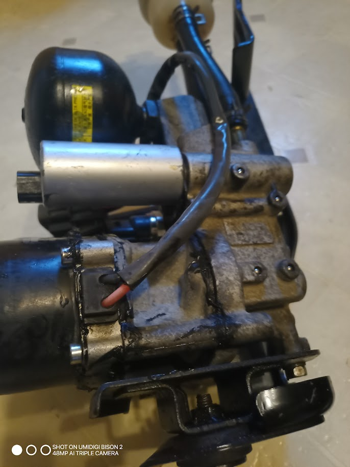

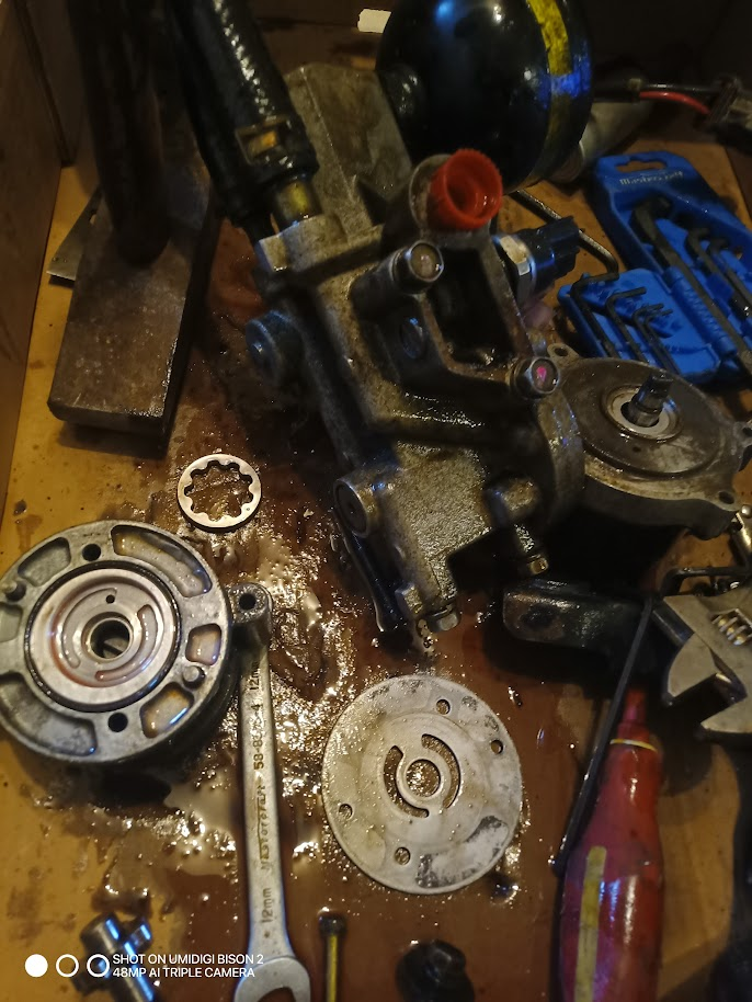

None of that matters because I've been on a pretty solid rampage of repairs.
Check engine lights, gone. Was not what I bought a pile of parts for but I say all good learning. And the nuclear option might be overkill so don't be so bloody jumpy! Friggin' o-rings man.
Dancy *** end and boings to make you go mad? Yeah, installed end-links wrong and did it all to myself, blah! Now I know so there's that learning malarkey some more.
So feelin' pretty bold and kingly so it's time to tackle the 3 lights all ACD users puke a little every time we see.
Do you have 2 pumps? Me too! Weird, I got one when mine didn't work after sitting for years. I swapped 'em and for what!?! ARGH. Stupid sunuva...anyway got the rebuild kit and put the bugger to use and rebuilt a pump. Who knew it would need it all too?
Have I met with immediate success? Of course not, why would that ever happen!?! No, pretty confident all it needs now is to manually for sure be bled. I dunno how if I'm using evoscan right to do it so plan on forcing whoever seems likely to push a pedal at the right time to help me while a crawl around under the car.
I should buy some ramps...
If you plan on rebuilding a pump, spray the bolts with penetrant then let it sit for like...a year-ish worked for me. Also, very grungy.
I get the kit from some Brit wit stainless plate not some for sure gonna rot coated baloney.
Putting it back together gets *****y I tell you what! So I put some sealant around the ingress edges.
I might now be good at swapping this pump.

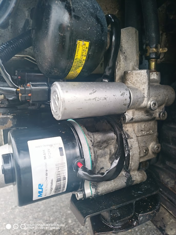

Holy hell in a hand basket! Friggin' pump man...anyway, IT IS FINALLY FIXED! After much hassle and many swaps I for sure toasted the motor or didn't put it together properly yet. So I said ***** to this all and ordered a new motor from the guys makin' 'em. Another 500$ item...at least the guys are Canadian so free shipping for once, HUZZAH!
Back on the car and about as new as it can get. Fresh solenoid from ze Russians, stainless pump plate from Britannia and a motor from right here 3000 miles away in Canada! I burned an entire tank of fuel waiting for the 3 lights fire up, they did not. I drove like a madman through some corners and quite certain the unit is now functioning correctly! Next is scheming up a proper shield/bucket for that damn pump!
The new motor is very much an upgrade. It ditches the bearing for a better housing they claim is better sealed from the elements.

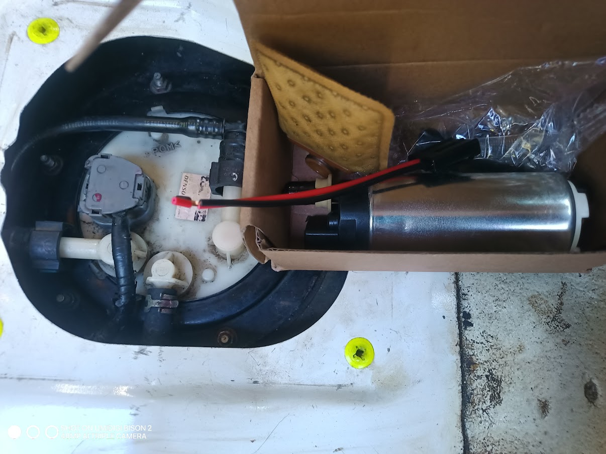

What? Was I correct? Well the frlippin' brand new DW 200 wasn't the answer as it's dead out the box! Crap thing is I bought it years ago for the original chassis in case of failure. So no dice on warranty, what a waste!
Little clarity, obviously I think my fuel pump is/was dying based on it making some wonky noises, some screwy idling(plugs got 10k on em but look fine) and my car randomly just dying. I been chasing idle issues. Fix one, good a week then something else.
Stock pump in the box, Amazon unit in the tank, car fired up and idles smooth like butter! Did I fix the thing!?!
So I dig out the fresh new pump, swap it out(quite easy) and NOTHING! As a rookie of course I put everything back together assuming it would fire right up. Instead I get BUPKUS! Where's the whine!?! From me for a hot minute! So back in goes old pump to see if I'm insane. Nope, old pump fires up and goes with the wonky(bearing dying?) inconsistent noises.
Decided to just order 60$ unit from Amazon to see what happens before I go ***** deep with rail, regulator and...a Bosch pump? I'm not feeling positive about big brand names right now.
