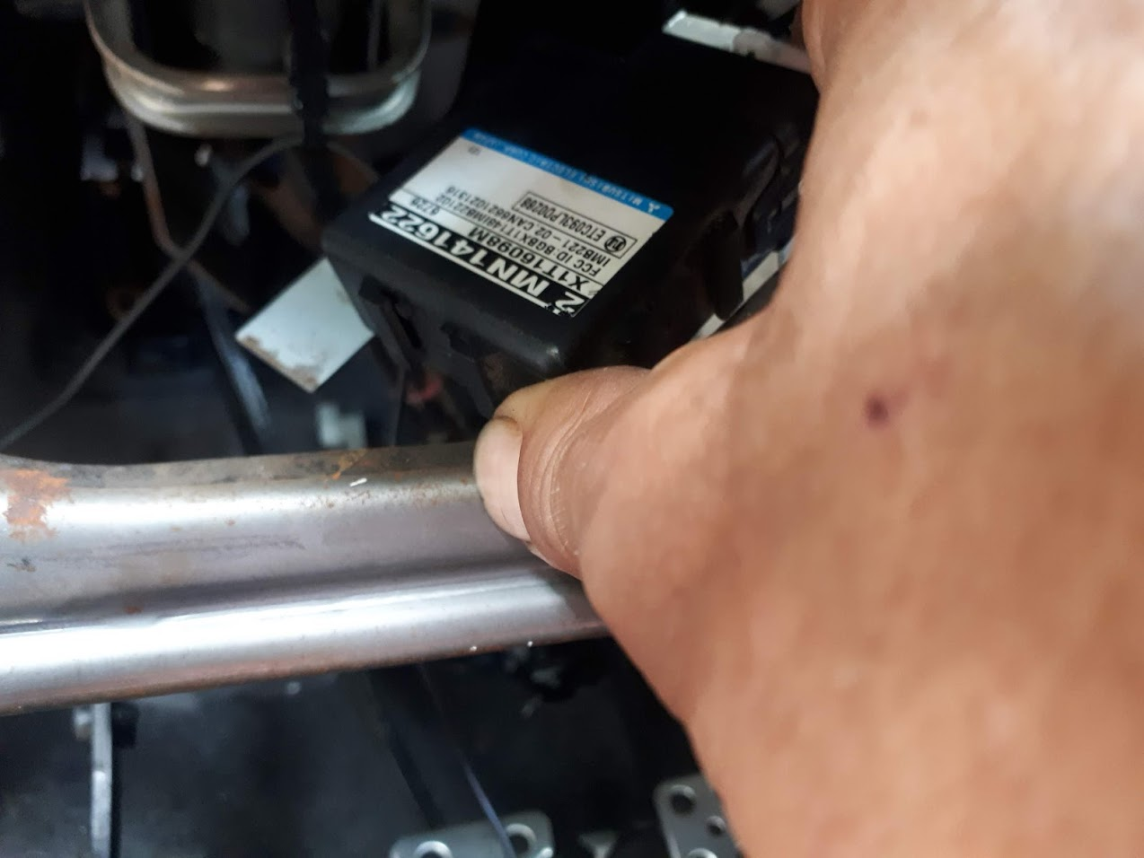

So uh, yeah, after all that I learned a lot and eventually found the things that were not correct. It was wiring diagrams that finally sorted me out.
Ooooooohhhhh, you mean that little electronic googah that I wasn't sure was swapped is in fact the IMMOBILIZER ECU!?! And that other thing I simply hadn't noticed was beefcake fuse? All that is behind me now.
Hahahaha, took needing to go through wiring diagrams to realize this is the immobilizer ECU...so much grief for such a tiny thing, typical.
Bloody good thing I got a spare!

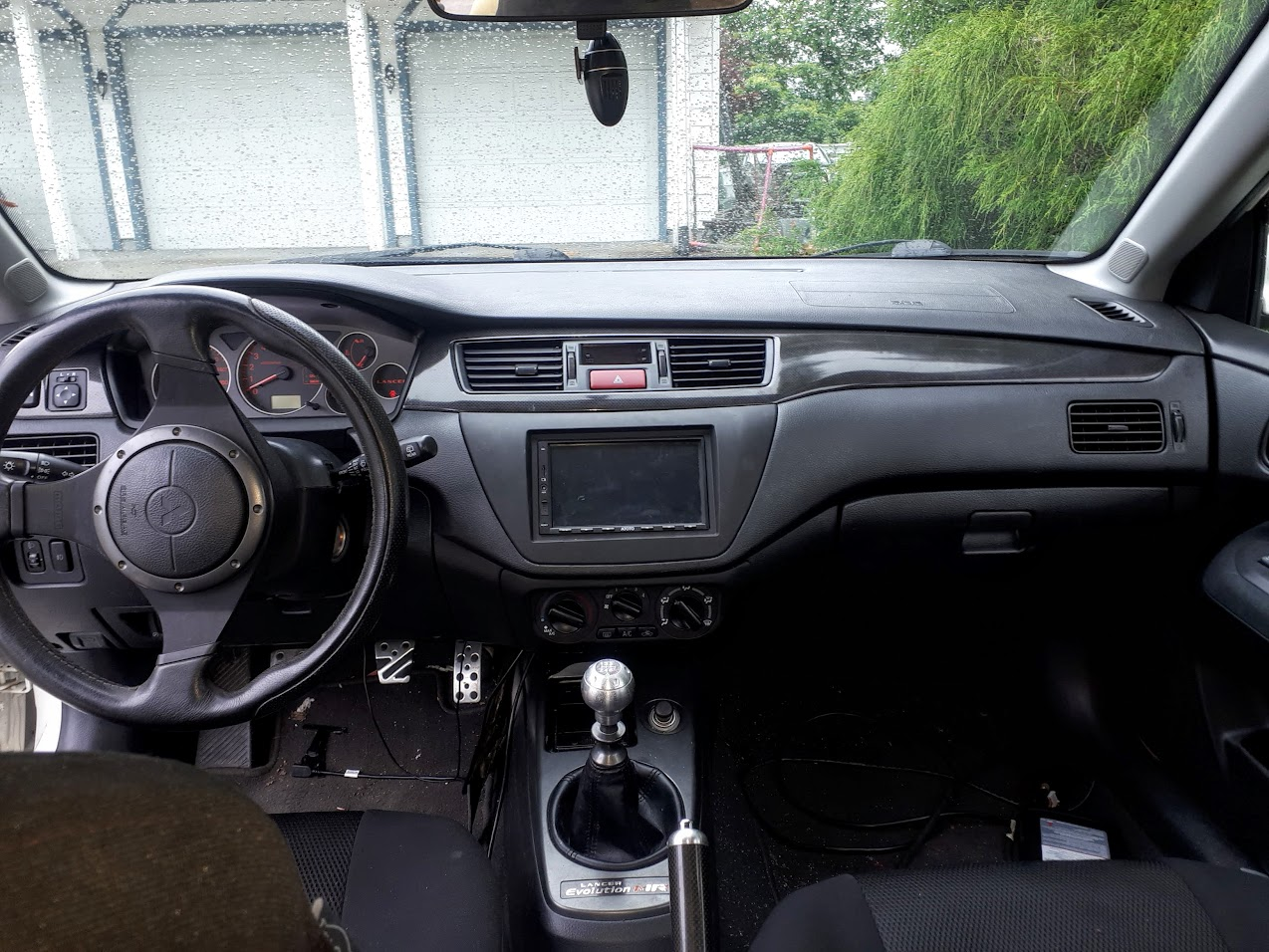

The stereo dual bluetooth thing worked well so far, had phone and torque hooked up at once. Just need to get a proper wifi signal to update/upgrade/install apps. Really wishing Evodroid was out in the wild now! Yeesh, whatta we gotta do ovuh heeuh.
