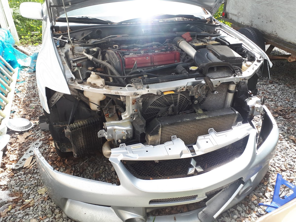

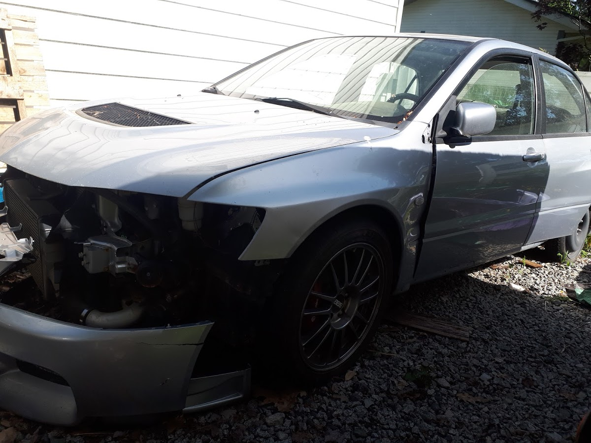

Added pics of wreck and new roller for anyone wants to see a mangled Evo and be amazed the roof is fine despite rolling twice...stupid steep mountain banks and black ice...

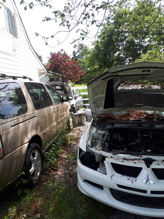

2 zomb-evo's gonna bring 1 to life
bonus, mudflaps already there
not the best work space but the weather is nice

new roller
saddest IX

IX interior, window was cracked and rear door no quite close so it's a mess. seats already pulled and reclaimed
death blow from the roll

front pass. corner got hammered too
injen piping came with roller
