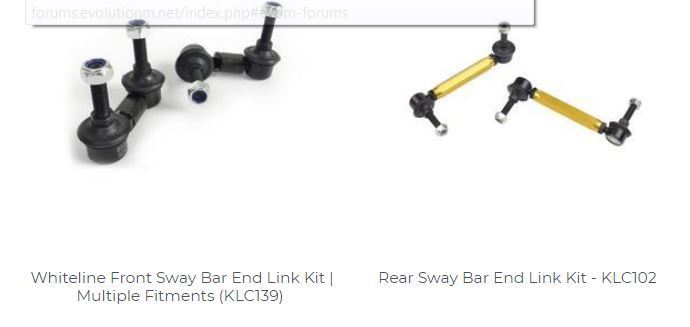

Regarding the endlinks, ive intalled the WL at all 4 corners.
That Cusco lower coupled w/the WL endlinks is a good system to run
End link no. are:

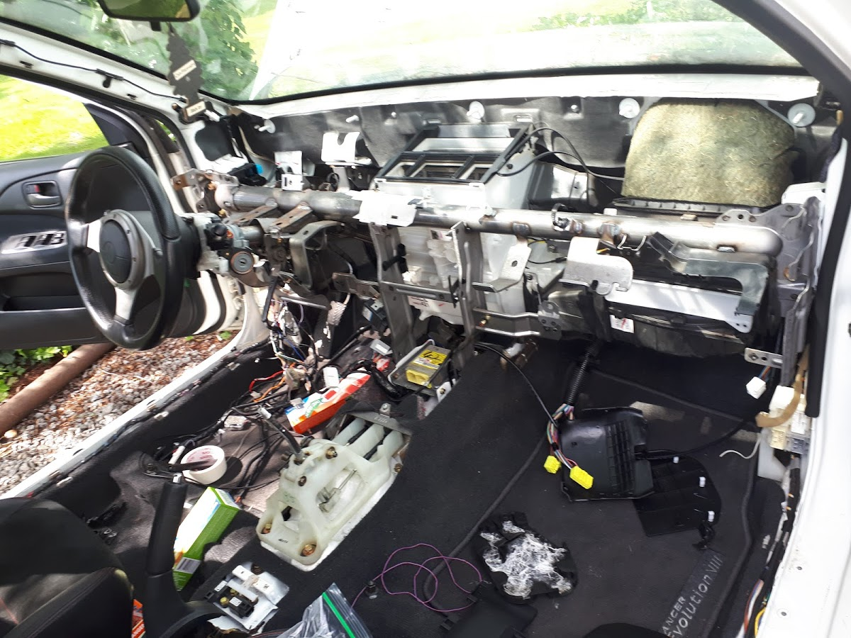

Got some time to visit the cars and get interior dash harness from 8 completely removed. Pulling the dash first time having little clue(didn't find how tos for complete removal) was nerve wracking but got it out without busting anything. Key for pulling it is the 2 10mm holding the passenger airbag in.
There is still a pile of weird wiring left over from a variety of crap...radar, gps, remote start and more that is a complete mystery and I'm wondering if I need to just pull all wiring and use mystery free stock stuff from 9. Advice on this would be really nice
Some mystery wires with extra spooky little electronic goo-gah
Dash and harness out. Anyone need an 8 dash and harness? Etacs ECU and all!

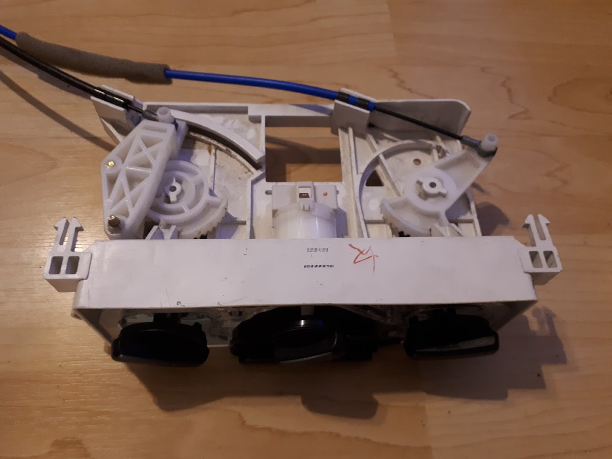

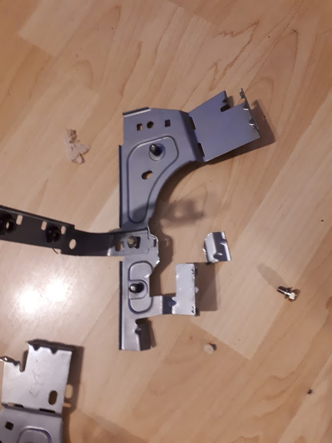

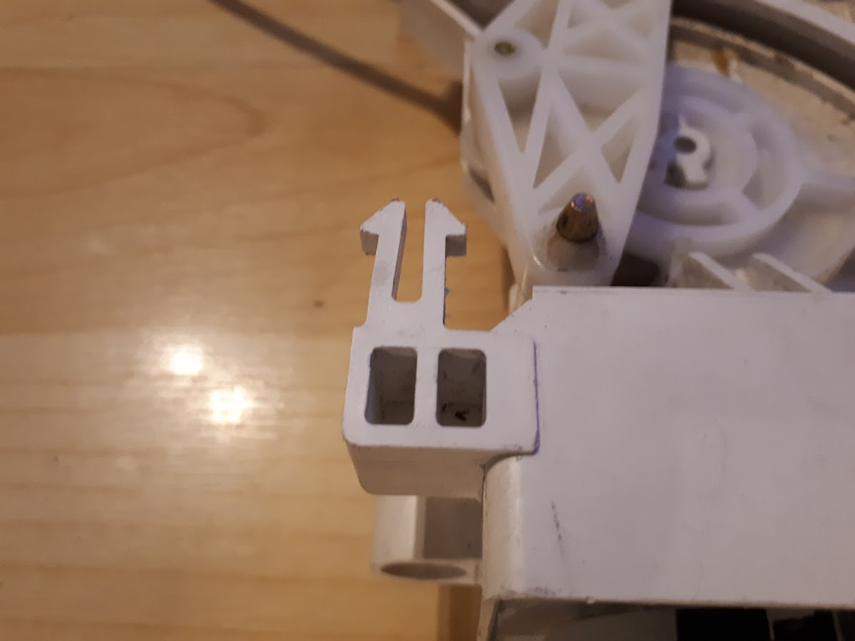

On a side, while dash is torn apart I cut up brackets to relocate HVAC to lower cubby. One thing I'm not sure of is how to actually mount the controls themselves, do I need to cut off the little tabs on the unit itself? Or am I missing a how to that shows this. I've searched and watched videos and they all say cut brackets, but what about tabs on controller? Got some pics
HVAC controller
Tabs that seem in the way when trying to mount in lower spot. Yes, cut em off is the answer for anyone who sees this.
Finally abusing the dremel!
Came out smooth

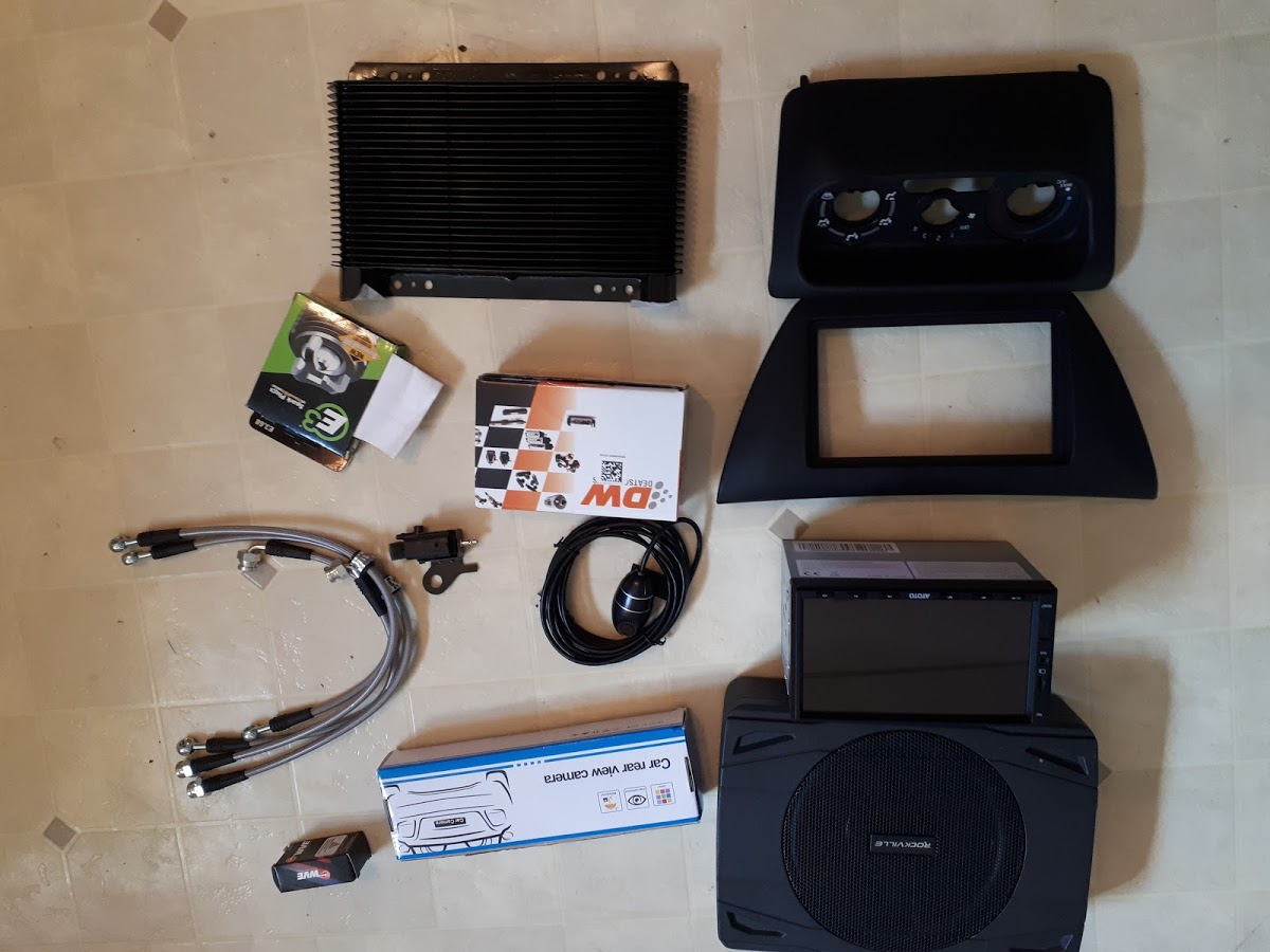

Just some pics of stuff
Some stuff to go in

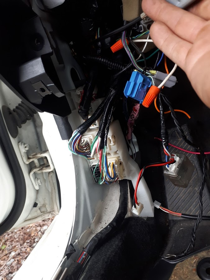

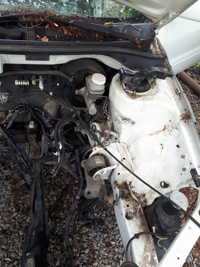

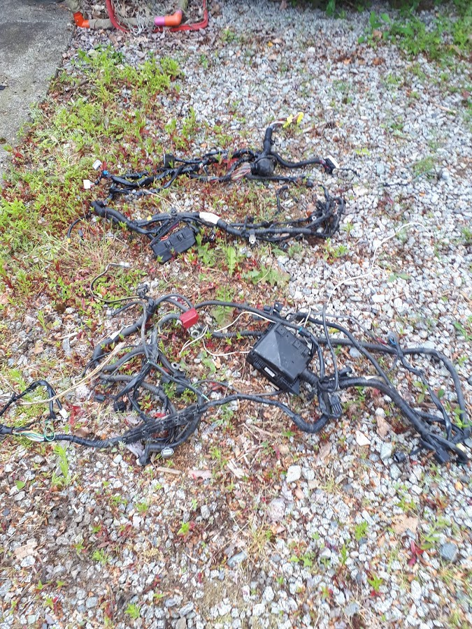

Anyway, I got out to the cars today and finished yanking all mystery and not needed wiring from the roller. Learned how to remove fenders along the way...stupid skirts and their rusted to mush screws, gonna cause me grief down the road when everything starts going back together for realsies. Some pics because why not.
All wiring gone...except the stuff that can stay.
ECU and Fuse box wiring. Anyone needs em they will be cheap AF as I gotta get rid of things ASAP due to lack of storage.
Wish I had the money and/or know how to do a tuck with the sweet firewall connectors but a working car is what matters most now.

Still wondering about the tabs on HVAC controls, do I cut 'em?

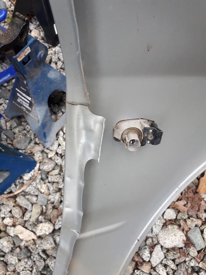

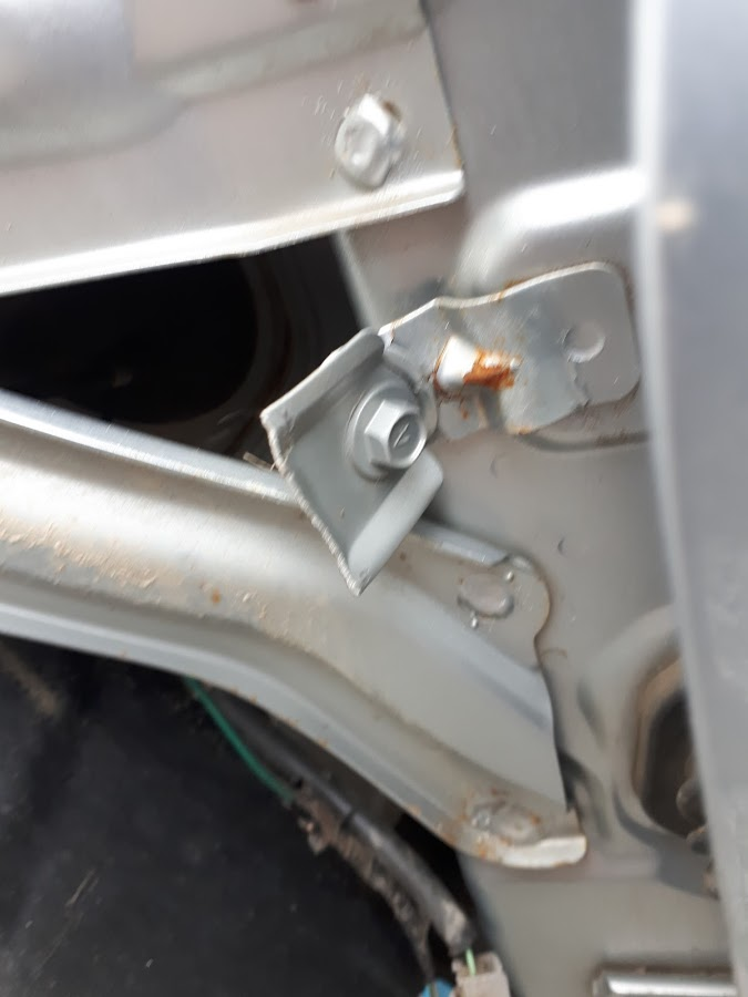

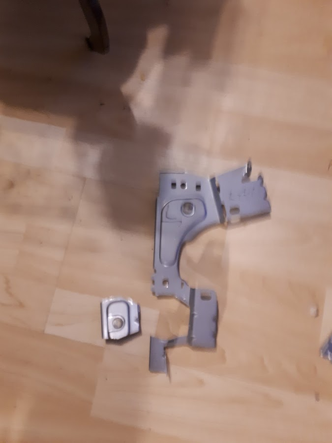

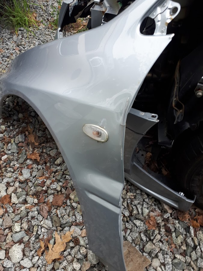

Fender
Damaged fender, see the crack and crinkle? Tab is also busted off, see other pics. Can it/is it worth fixing? Tree-fiddy.
Tab from fender. You good welding aluminium?
Inside where tab busted off, also crack.
