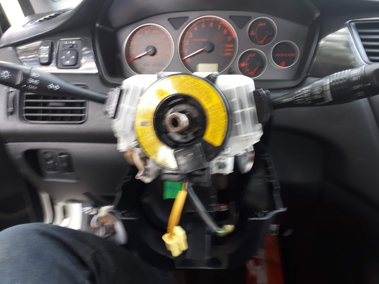

So then going through pics and the parts I got around my place I realized the steering column switch stalk thing got swapped and so the 8 one is in with all the 9 bits, will swap that out as well in case it has anything to do with immobilizer.
Blue scribbles give it away as I marked stuff coming off 9 only. With luck this is the culprit to no turn over of car. Anyone know if any security system functions happen in here?

Man I take garbage pics most of the time! But, this was the culprit with immobilizer and now the engine turns over...which leads to a mystery!

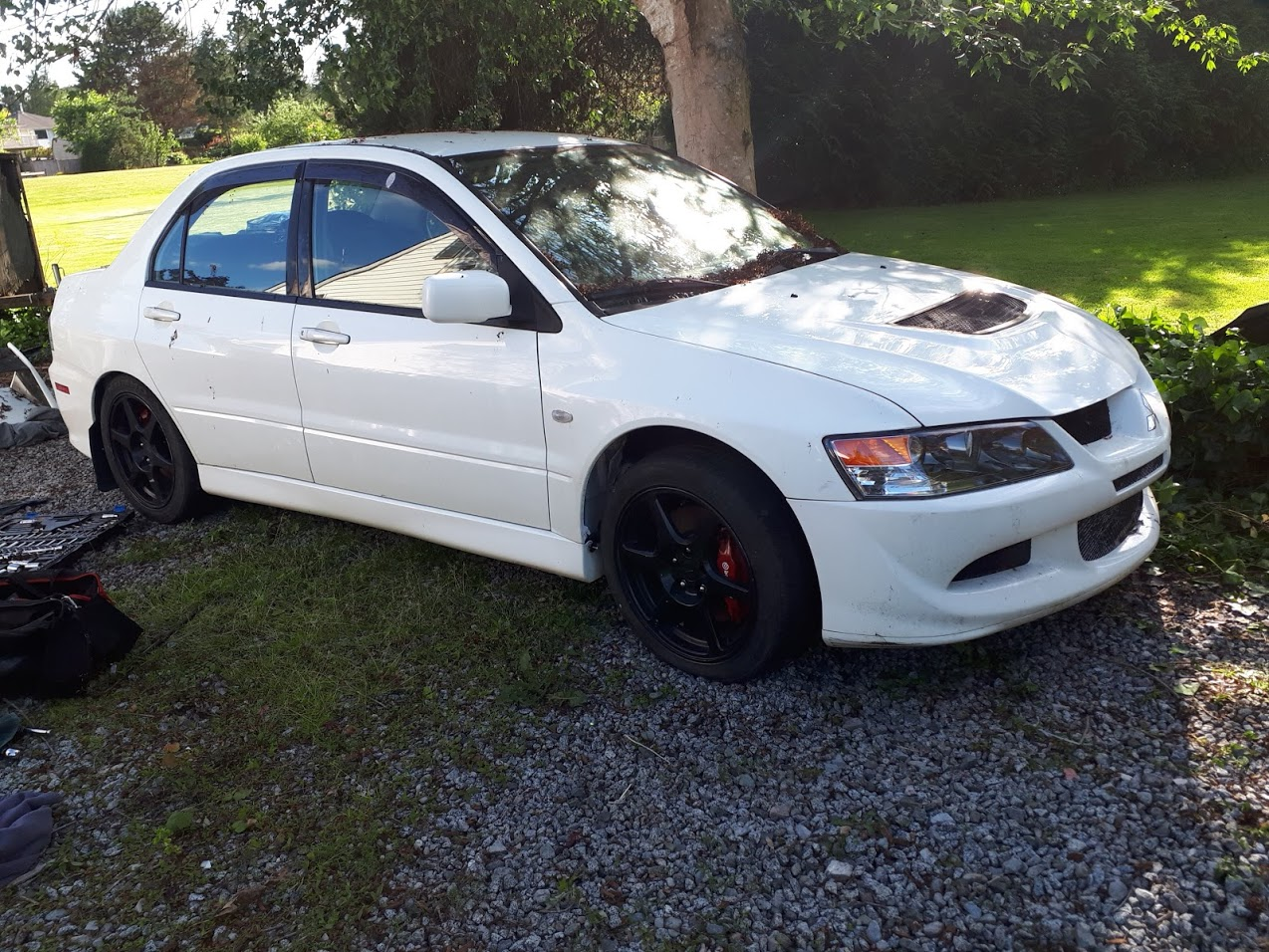

Hood back on, went white cause paint in better shape.
What's that? Well kids, it's an Evo! That will turn over but not start...

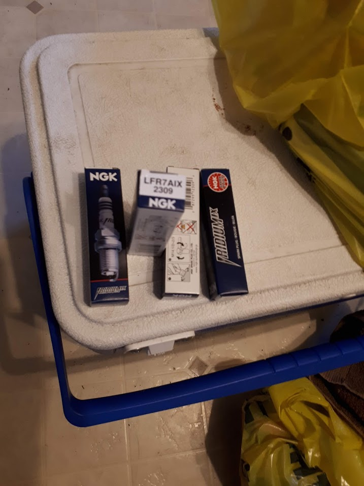

Okay, so I bought new NGK(last set in town!) plugs and will swap out E3's tomorrow when I go to car just to be sure it's not wonky plugs. Pump is running, made a nice mess under hood checking so it has fuel.
Nice new plugs, not sure what else to check or how...gonna be a long night sleuthing this malarky.
