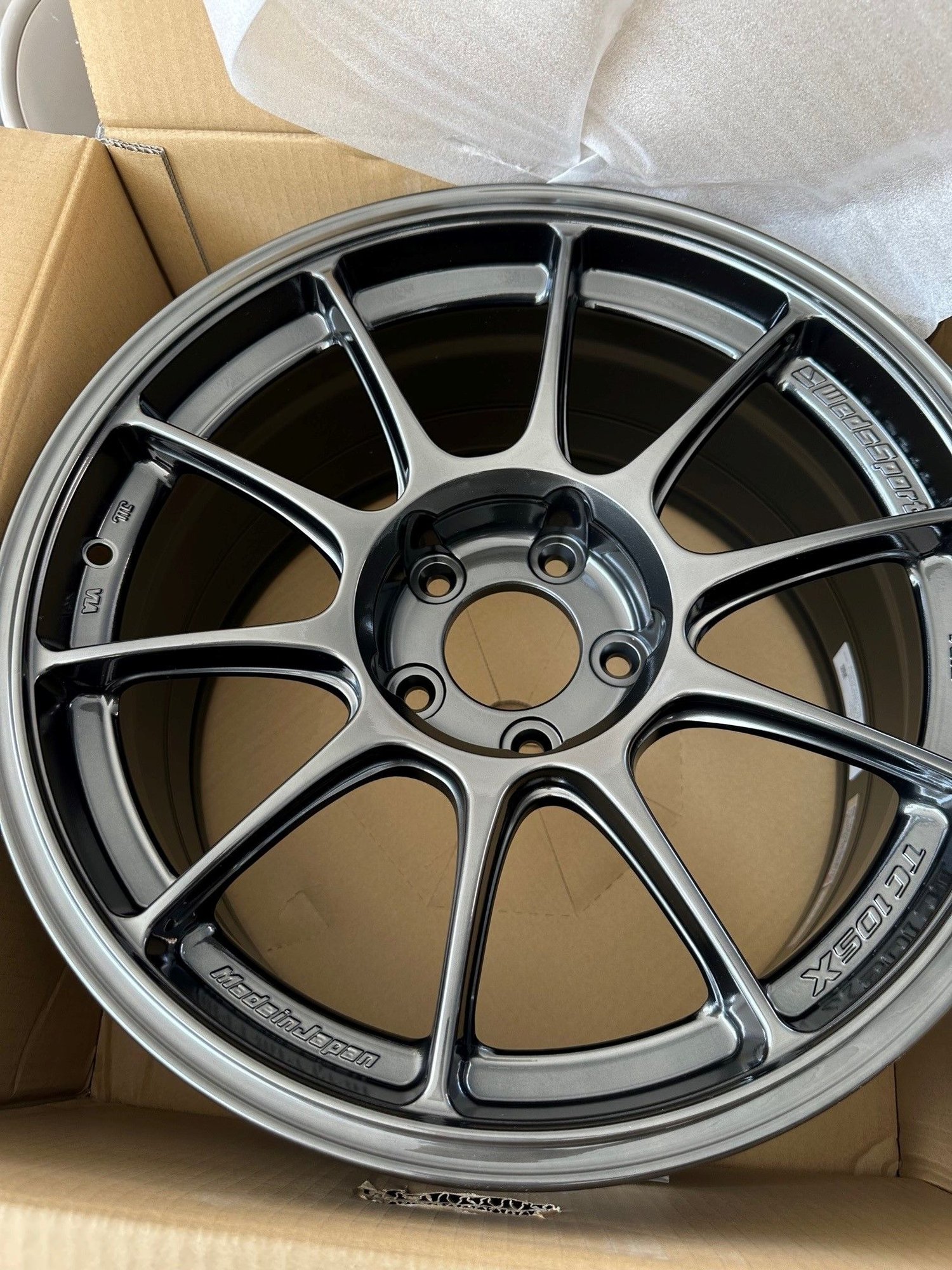

Update.
Wheels and Tires are in!. These things looks great and <17lbs each.
