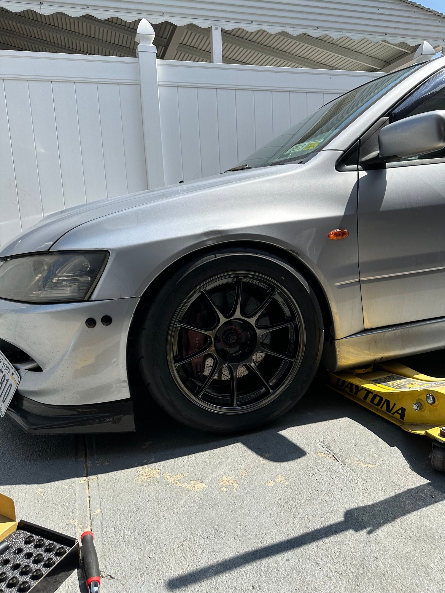

Mounted 1 to see the fitment, clears front/back brembos. Very slight poke on the front and flush in the rear. Rear will need to be rolled and front might need to be lifted up a tad bit. Need to order the damn center caps, forgot about that.
Once I get everything to clear correctly, time for the body shop hunt.
