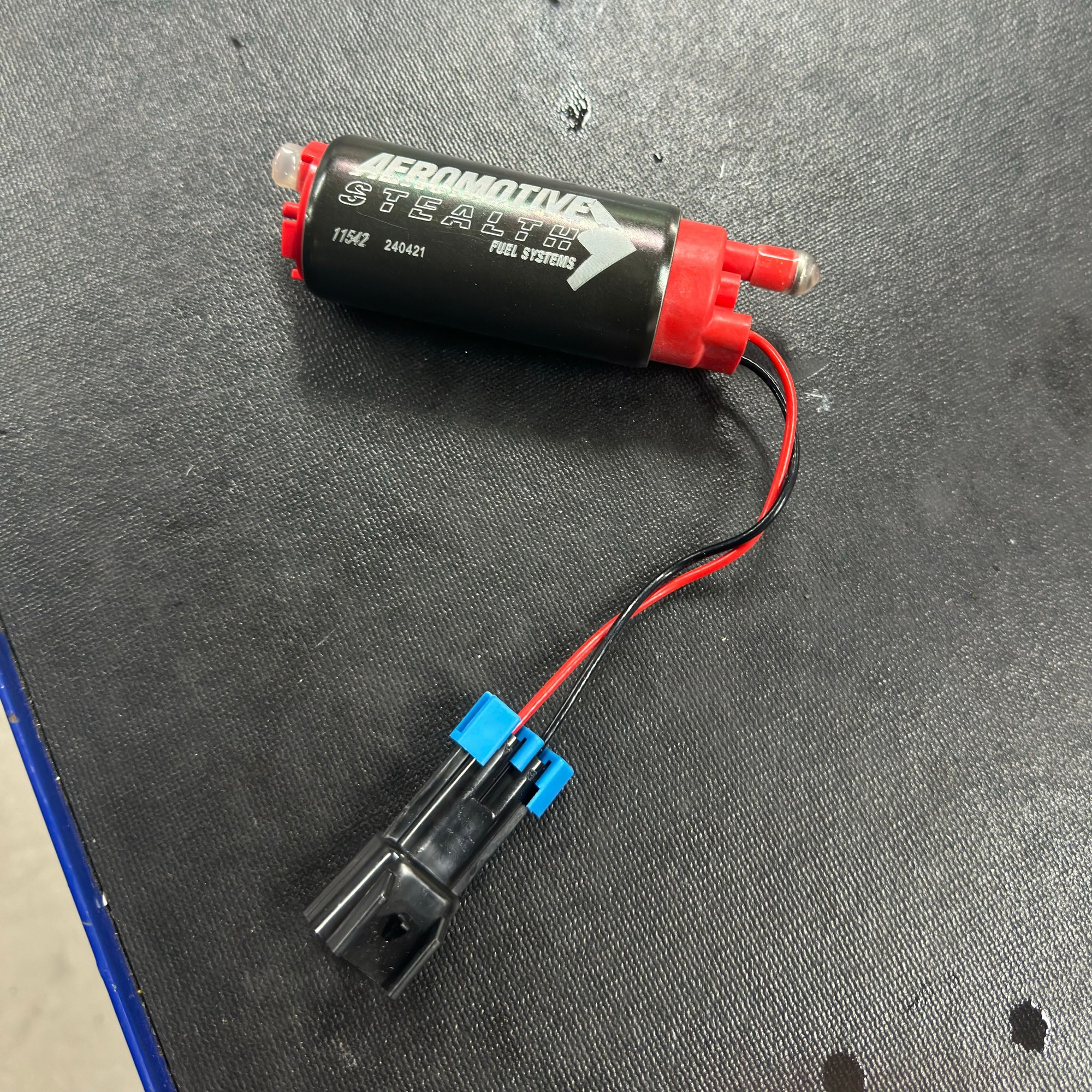

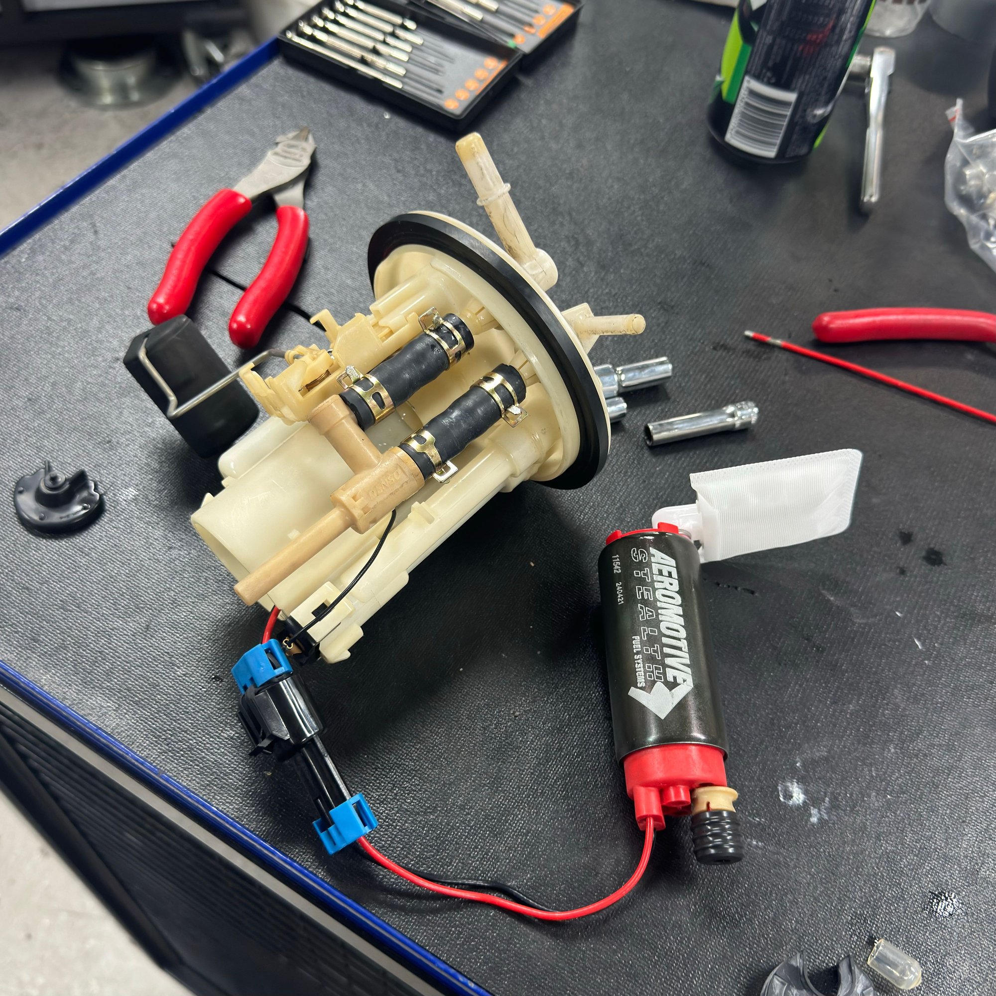

So first evening on the dyno, first power run and at about 5500rpm the fuel pressure started dropping off, checked the fuel pump voltage and it was low. So I hardwired the pump to the battery and that fixed the issue.
Next power run we hit 295awhp but was getting a warning on the link management program to say the injectors were maxing out. I no for a fact that the injectors are more than capable of the power I want so it was down to the pump.
The Walbro 255 is good for about 500bhp on 98 but add in the extra 40% fuel being used due to e85 that brings the figure down to only 300bhp when using e85, so the pump was maxing out causing the injectors to max out.
So I swapped out the pump for an aeromotive stealth 340 pump. Due to the bigger pump creating more pressure I also got a turbo smart fuel pressure regulator and hoses to complete the setup.
Benny

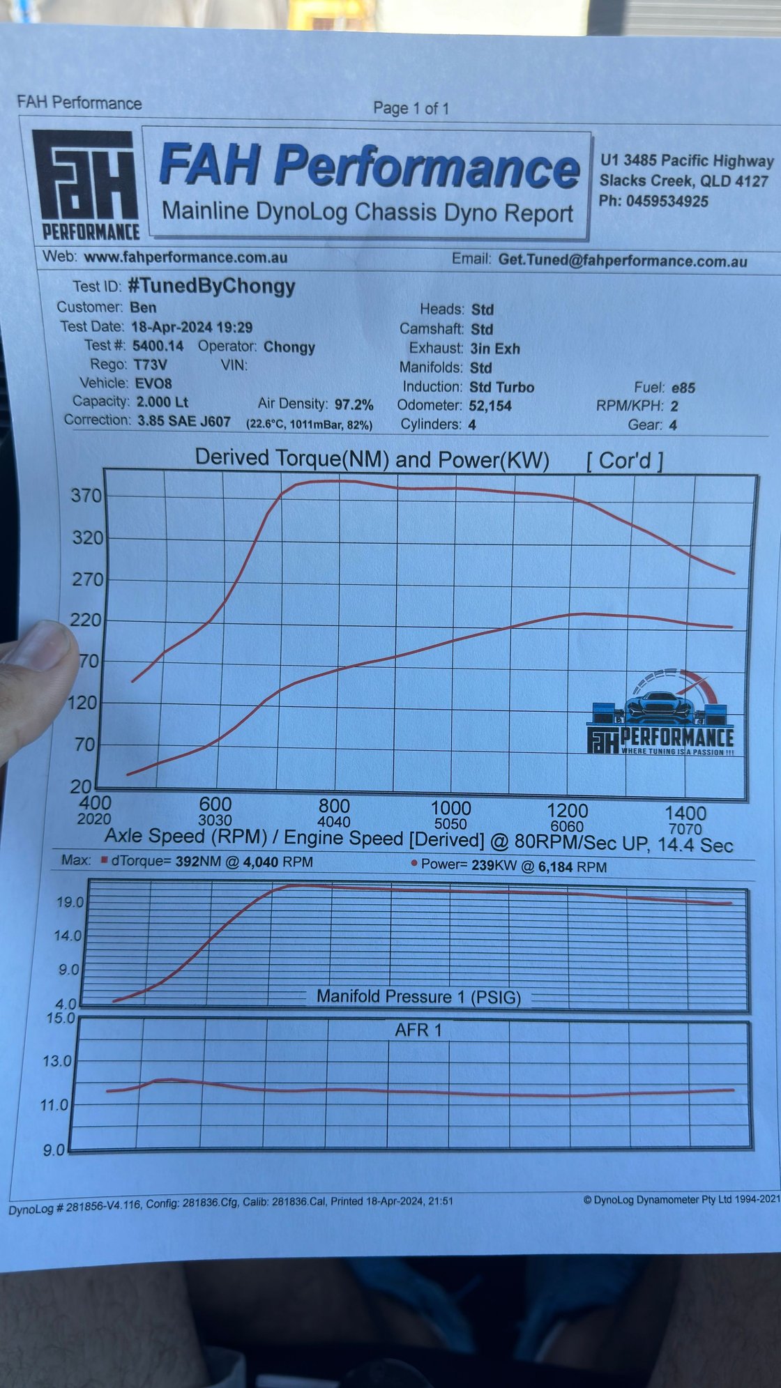

After the fuel modifications were done it was back on the dyno the next day for more tuning.
The final results of the tune were 320awhp & 390nm torque on e85 fuel. Dyno was a mainline hub dyno
The mid range is phenomenal and full boost is achieved by 3500rpm which will be awesome for the track.
The power mods to summarise the tune are:
PWR intercooler kit
Induction kit
3” exhaust system
ID1050x injectors
Aeromotive 340 fuel pump
turbosmart fpr
grimspeed boost controller
link G4X ecu

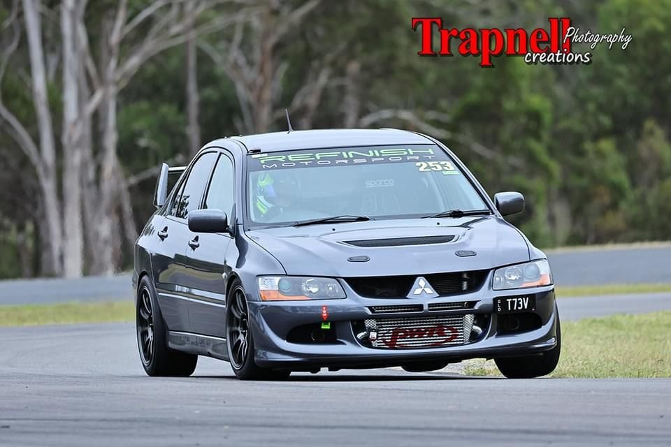

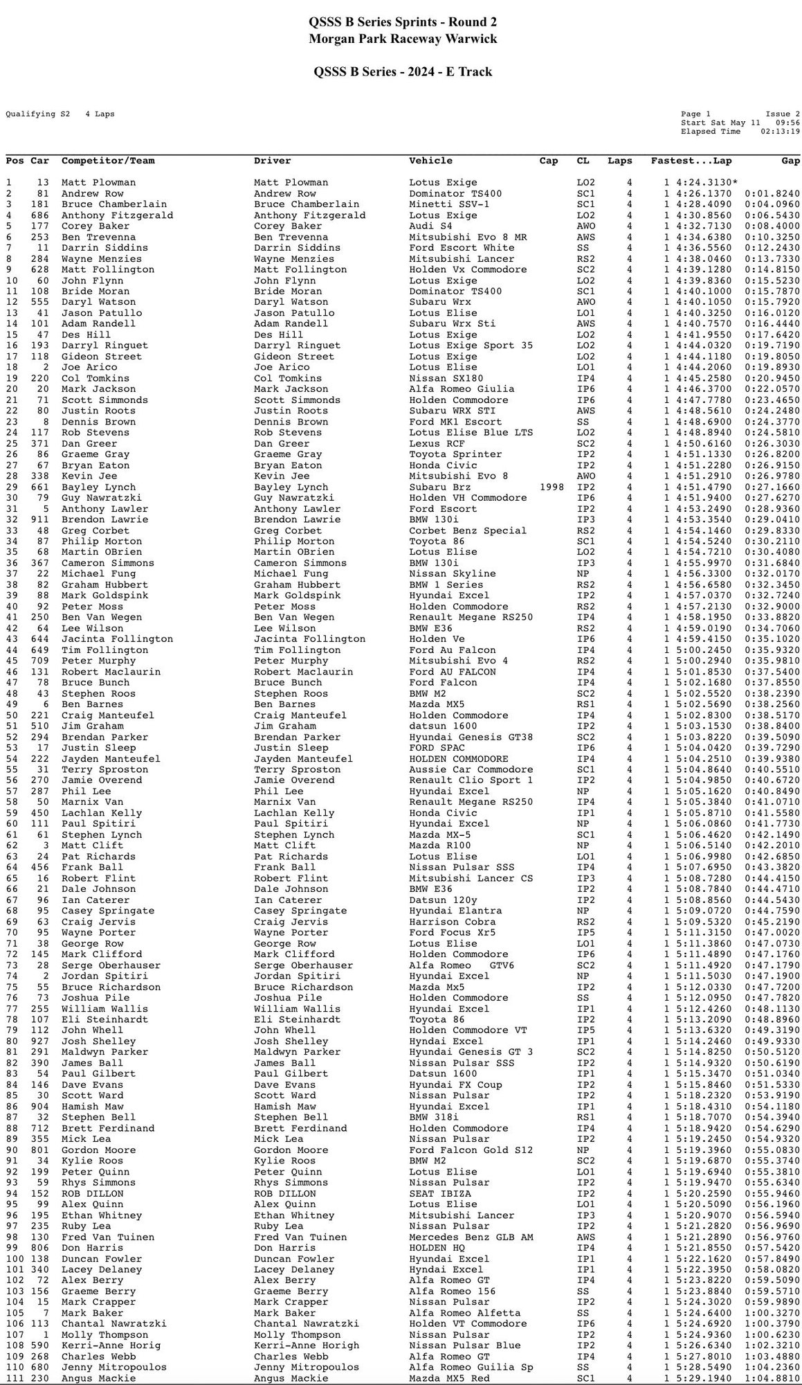

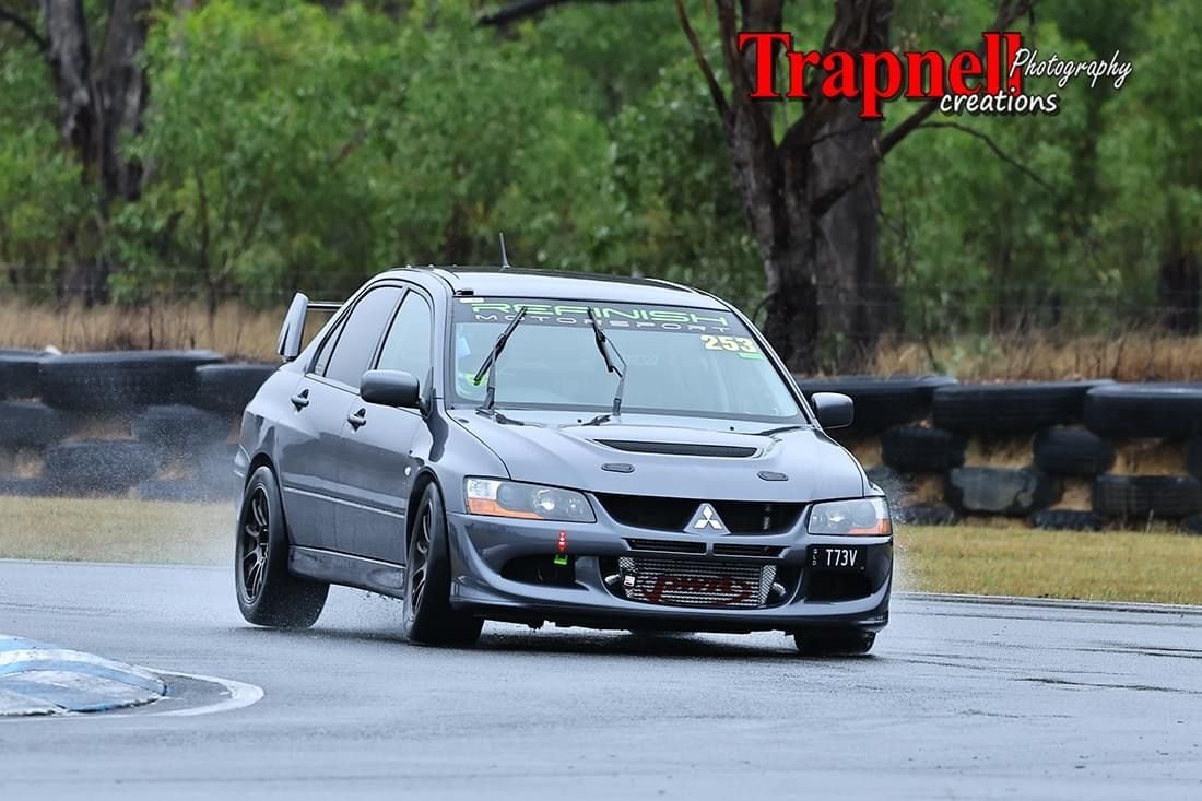

Had round 2 of the state championships at the weekend and it was awesome. I finished P1 in my class and P6 outright of 150+ cars, I was also the fastest road car there.
The front felt a bit soft under braking and I was using all the travel in the front up to the bump stop, I’ve ordered some 13kg front springs so I’ll get them fitted when they arrive.
Also had a blast racing in the rain. Back on track again in 2 weeks for some more sprints.
