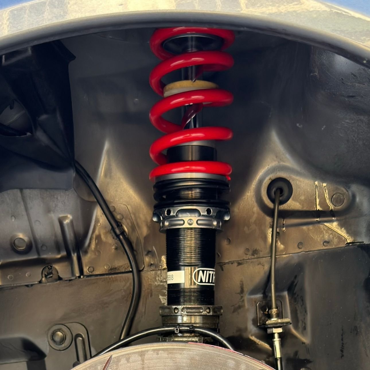

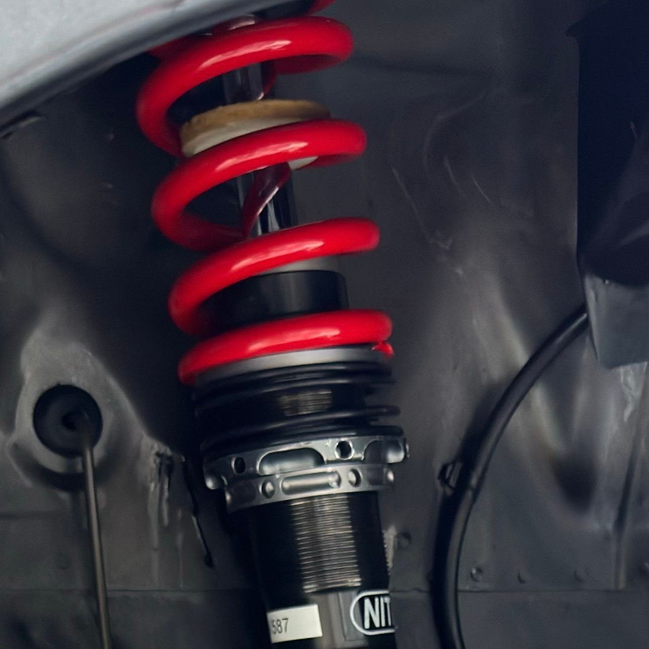

Got the 13kg front springs from eibach and got them fitted. I’m on track again next weekend so will be keen to play around and see how I go.
Benny

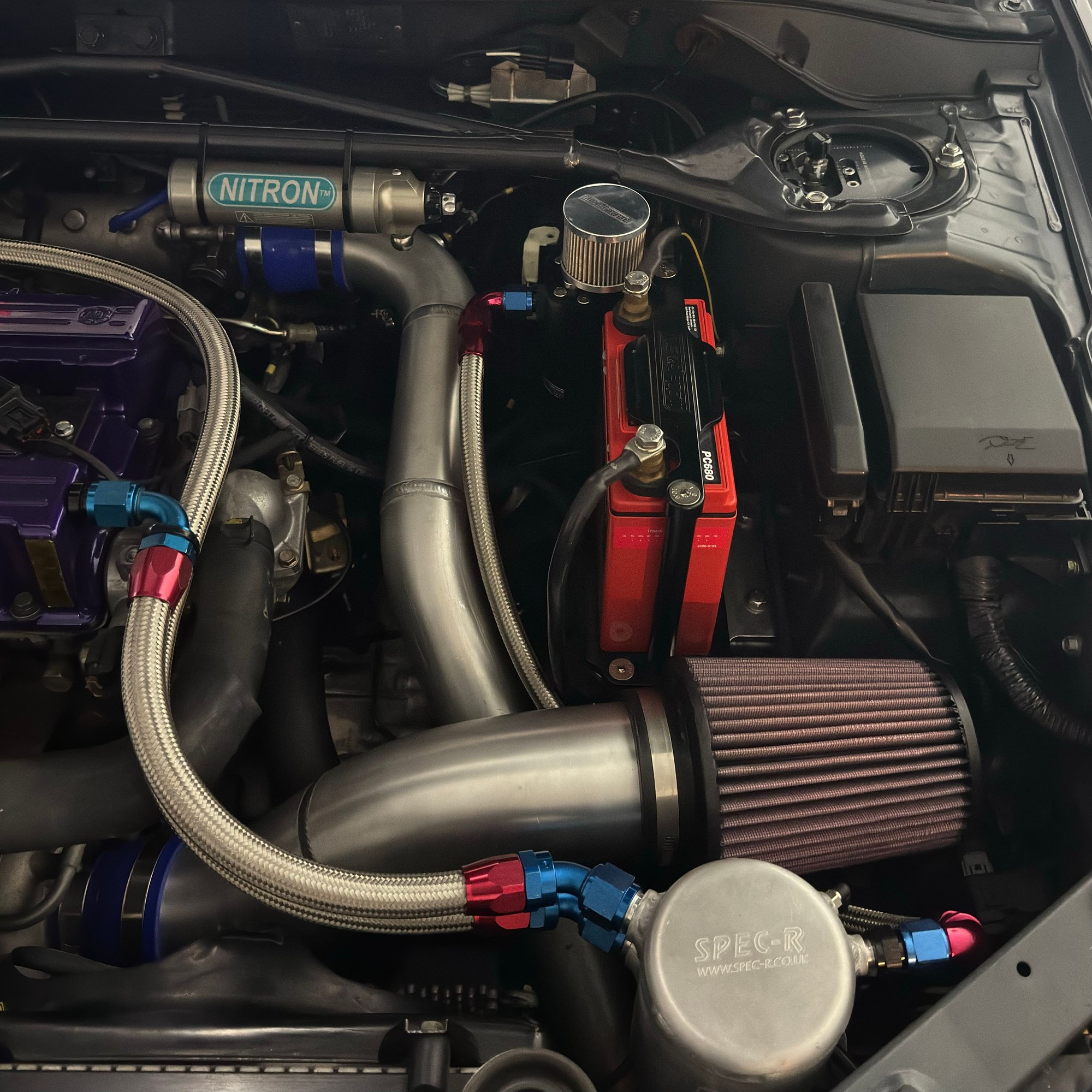

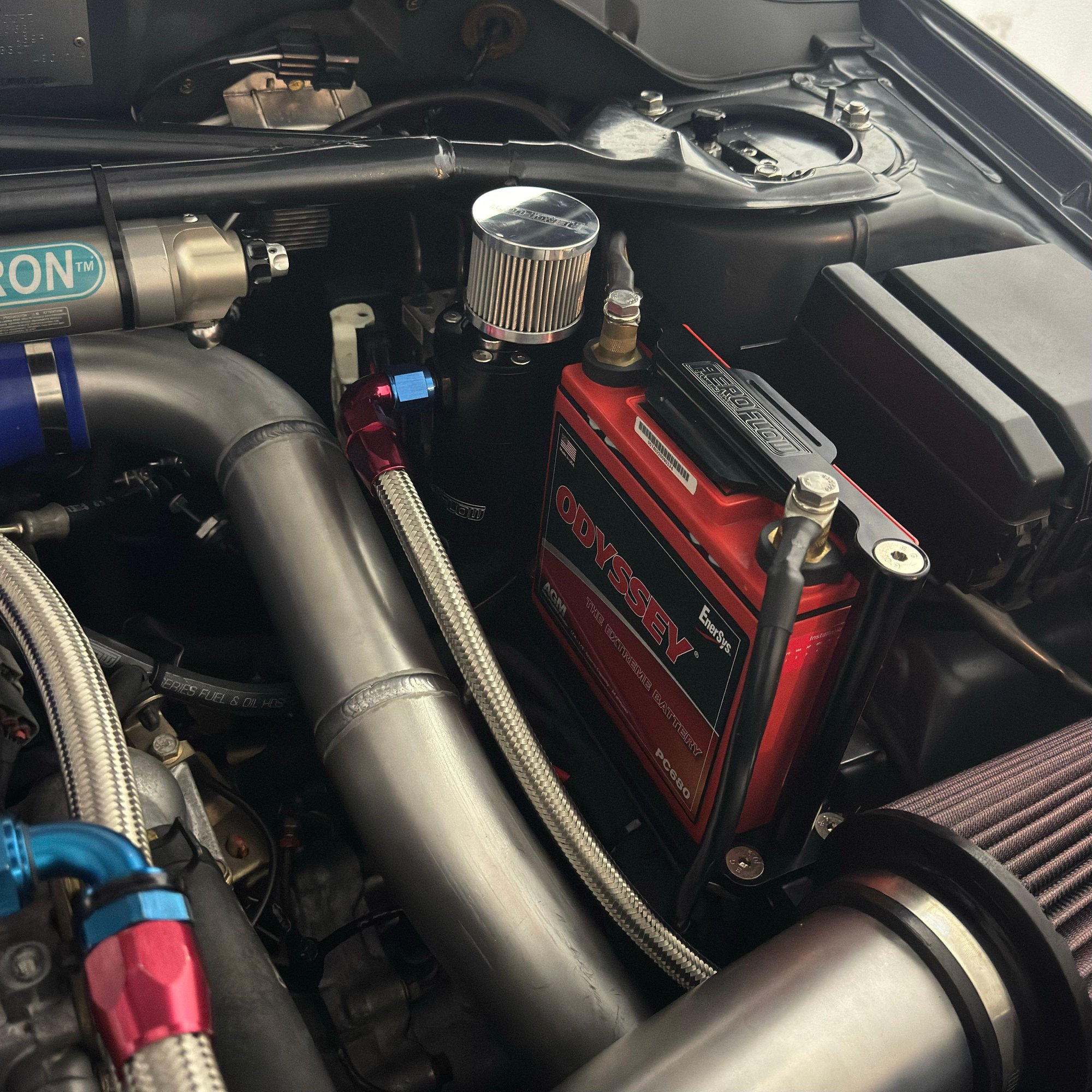

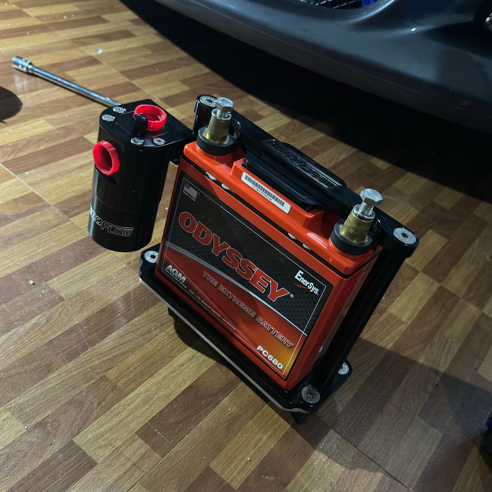

Also upgraded the breather system to accomodate the e85 vapours. I bought an Aeroflow single breather can which I’ve bolted to the battery tray. Now the breather from my original catch tank will go to this new one and then the new one has a little breather filter on top.
Benny

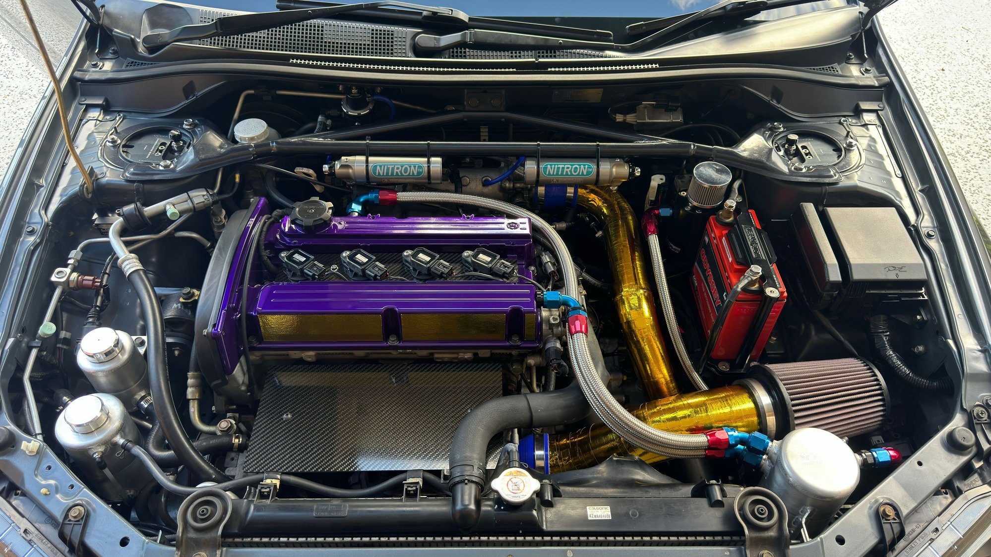

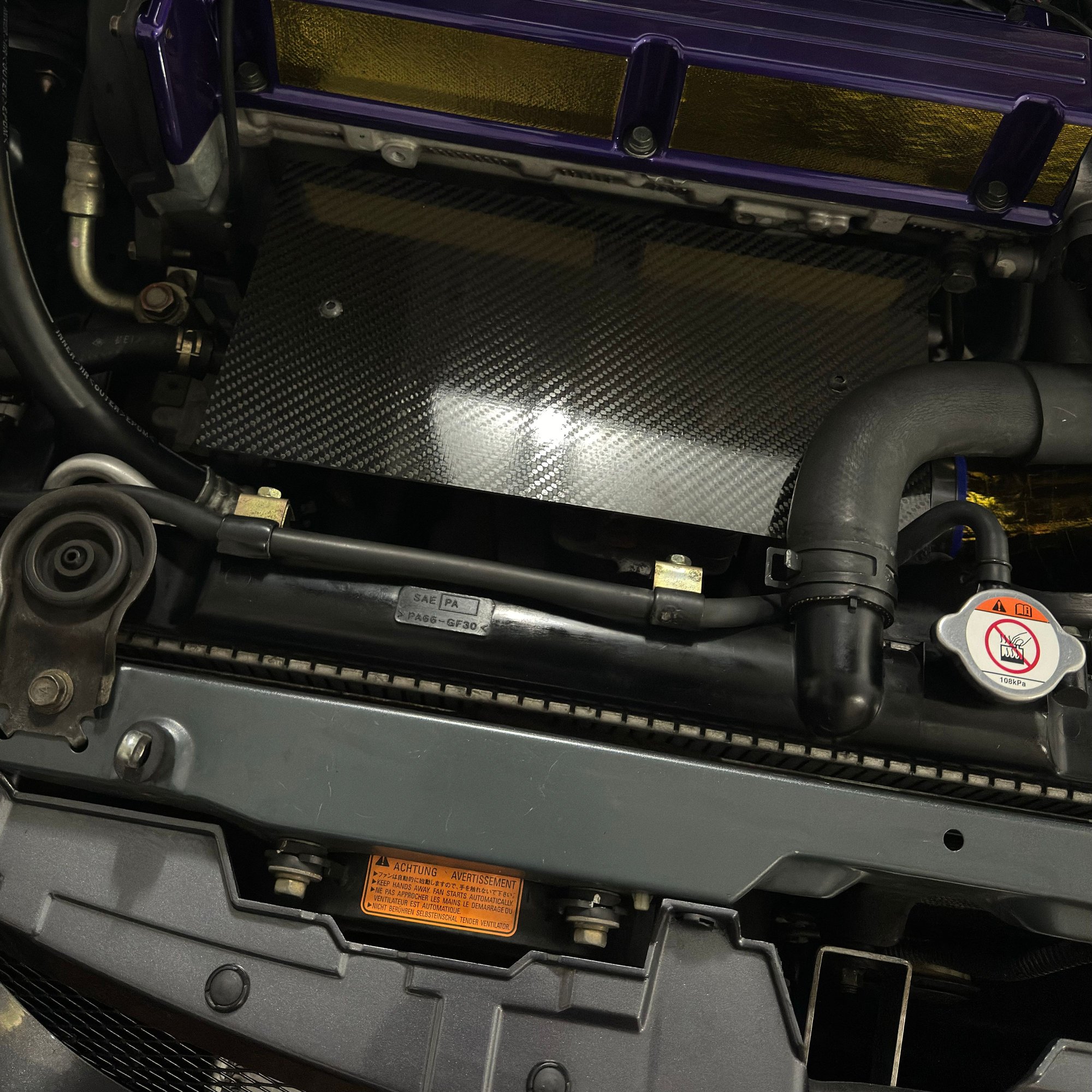

Wrapped the intake and intercooler pipe in some gold heat reflective tape, every little helps with keeping the temps down in the hot Aussie weather.
Benny

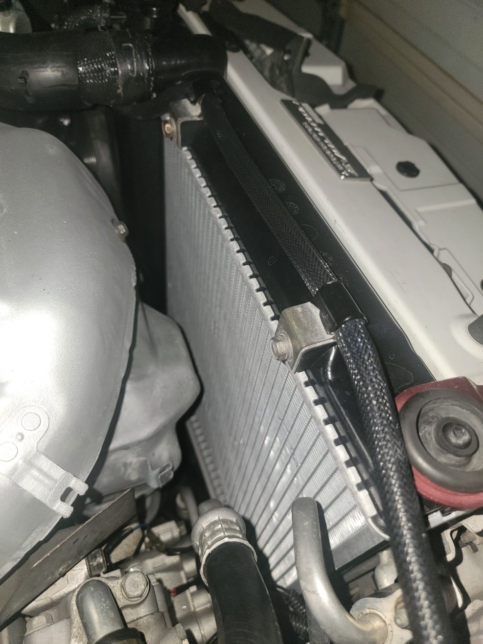

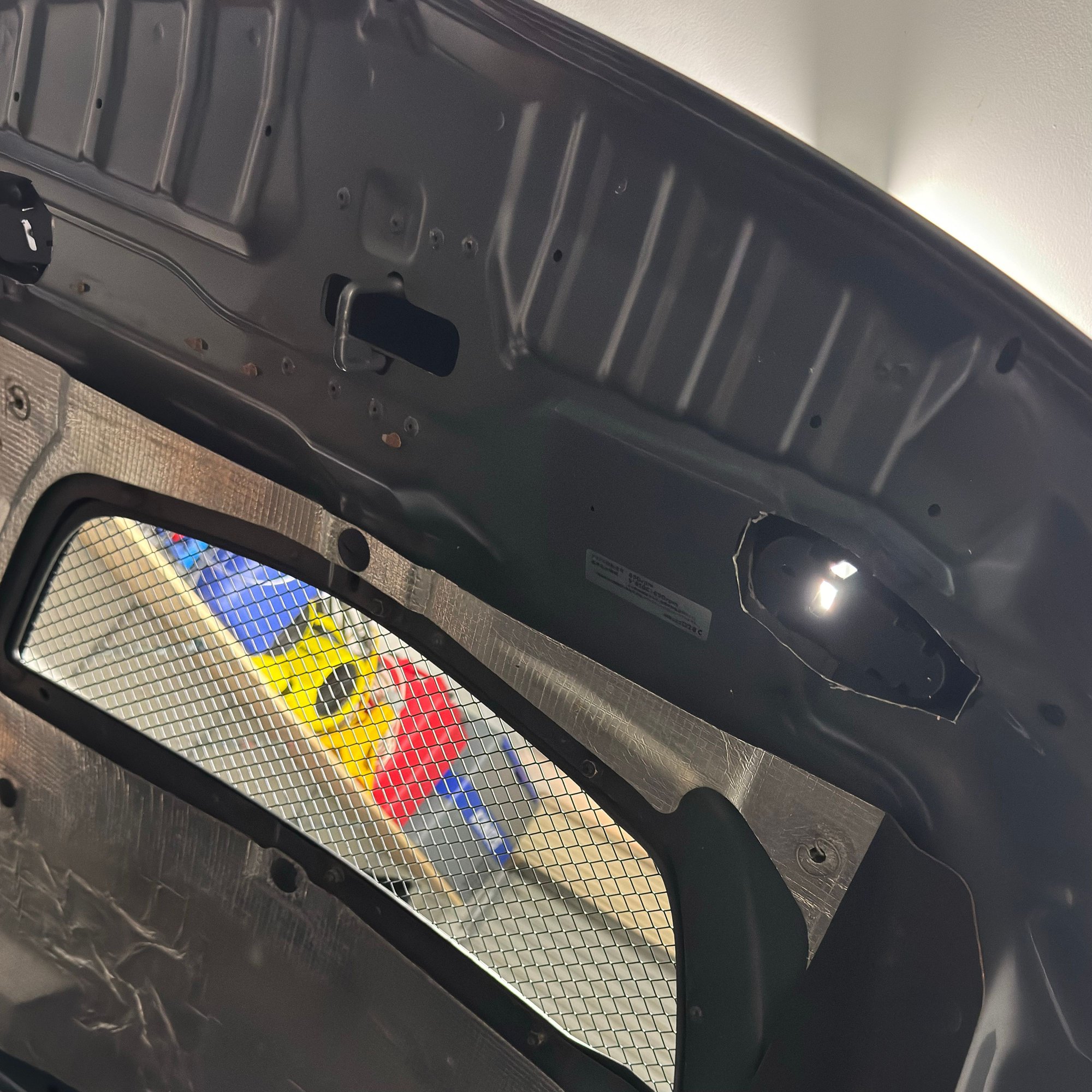

have you removed all the hood seals? I measured ambient temps in the engine bay when driving 50mph
also if you put the breather beside the intake fumes will get sucked in and wont smell
also you can flip the bracket on the hose to the coolant reservoir
I haven’t removed the hood seals, does it make a big difference?
I was going to put the brether there but got tight with all the room lol, and what bracket to the hose on the coolant reservoir are you talking shout?

yes it definitely helps. all the air being deflected by the radiator will cool the the top side.
this hose
this hose
sweet, I’ll do both them mods when I get home. Thanks mate

Took the hood seals off and changed around the coolant reservoir hose

flip the brackets man

What are you flipping the brackets for? To cool the overflow hose?

clearly tucking away hoses and cables is a thing here.

Finally got it

perfect. dry your rags somewhere else

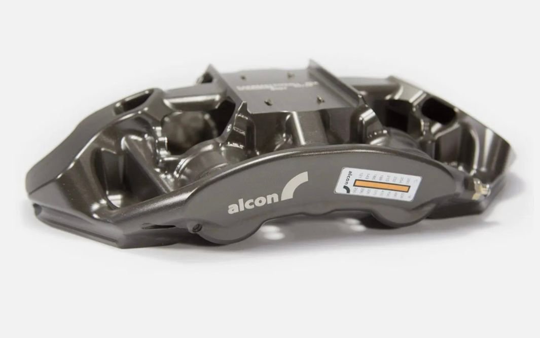

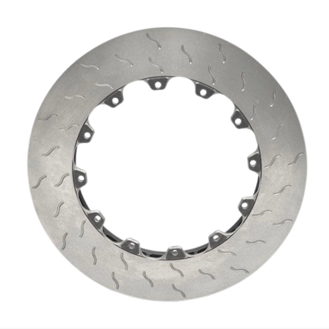

This also means I can now run a bigger brake setup. So I’ve sold my current setup and I’ve ordered a new kit which is pretty special.
It consists of some Alcon billet monobloc gt calipers which have vented titanium pistons and are semi ducted ready. They will have some 25mm endless n35s pads in and be paired with some 365mm x 34mm fully floating alcon s vein race discs.
Keen to get this set up on, the brakes will take about 4 weeks to get here.
Benny
