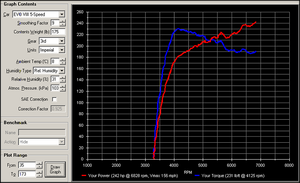

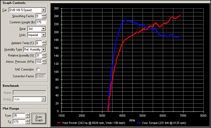

I looked @ your 3rd gear pull and it looks fine. The problem is it started @ 3400 rpm and ended @ 6800 rpm. Also, your TPS was not 100% all the way through. @ 6500 rpm your TPS dropped below 100.
Please do a log from 2500-7500 rpm and post the results. That will be more accurate and it will load the car better for turbo spool up.
Also please log more parameters, like Inj pulse and LoadCalc.
Based on the log you gave us, your car is putting the following hp/tq according to DLL. I have used the temps and baro press from your neck of the woods. I assumed a full tank of gas and a driver weight of 175 lbs.
