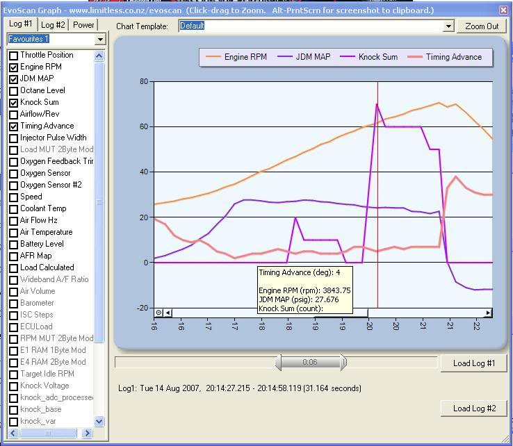

1. I didnt calibrate it wrong, I didnt calibrate it at all, I just plugged in a close enough value. At most I would be off my .3psi, not 1.5-4psi. Razorlab didnt show me anything, because there isnt anything to show.
2. If the full logs showed any bit of useful info I would have posted them, but they didnt. AFR was imcomplete and I'm not at liberty to post my timing maps
3. Get off the who log deal, really. Ill post them soon enough, I simply didnt have solid log to post. I simply left off the other logged values to clean up the graph, since this post WAS ABOUT THE BOOST SENSOR. Adding in other values throws off the scales and such, and it at the time of positng, I didnt see how it was relevant to HOW THE BOOST SENSOR IS READING.
I came here for help, it was not to gloat and brag how I'm hitting 27psi+, then be attacked, that was not my intention at all considering my boost target was <23psi. If that was the case, I would have started my own thread "Hey look at me running 27.5psi on cali pump *zips up flame suit*"
Seriously man, I really am at a loss right now why you are ****ing attacking me. Jesus christ lay off yeah?. Mrfred,razorlab, and others are here to help and have given me some insight, I even posted a second log of how I corrected the overboosting issues and how its now reading on par with my original boost targets as logged on 2 different dynos (one being razorlabs). You seem to be here to naysay, attack, and preach off your all mightly all knowing soap box so excuse me for not giving into your RUDE demands.

Just for reference. To show im not hiding anything, that I was really just looking for help with any possibilities that the sensor may be grossly off. I was not hitting my target timing accross the board due to going into higher load cells. Obviously the car knocks with the boost it was hitting in higher rpms. No negative timing as you can see

np fred. Im really wasnt trying to start any trouble or a flame war or anything, i just felt like I was needlessly being attacked. Got busy tonight so the second gauge will go in tomorrow instead. Logged my 2-byte. At 27psi I was getting 280 peak loads, at 23-24 now im getting 260ish
Did the power graphing feature, registered at 371hp/331ftlbs for a 3rd gear pull. Used 3200lbs, 175lb driver weight, 70F. Didnt change the gearing
Seem on par with other cars?
