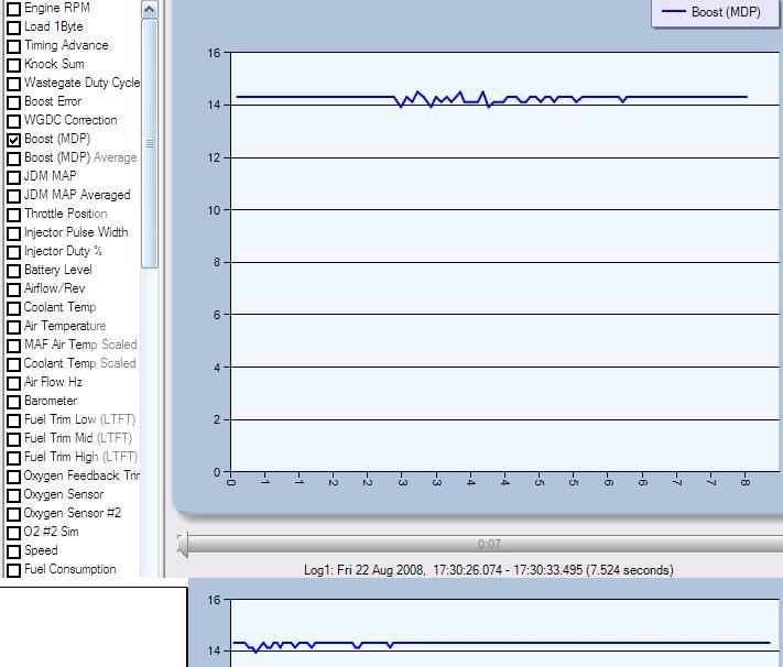

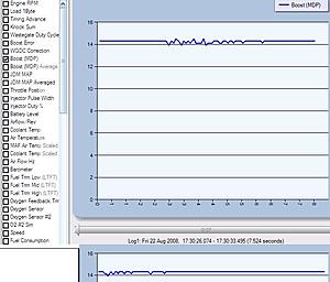

Is this normal? With the car off (key in on position) and warm I'm seeing fluctuations in the MDP signal. I couldn't hear any solenoids going or anything draining the electrical system and it seemed to happen even after I left it for a minute. I know we have a noisy electrical system thanks to my passport 8500 x50... but re-soldering the power connector choking it solved that problem completely in that instance. I assume something could have been draining the power without my knowledge though.
evoscan v2.5, tephra v5.10, direct boost control on evo IX SE
Attached Thumbnails log boost with JDM MAP sensor (updated instructions)-mdp_fluctuation.jpg

The minimum increment in boost is about 0.15 psi. If the sensor is right on the fence between two values, the boost can fluctuate about 0.15 psi. Shouldn't be more than that though.
