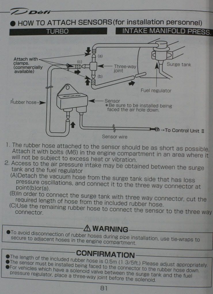

Have anyone tried logging boost with Defi boost sensor that come with boost meter? Check out this manual here. It cross my mind that will work.
