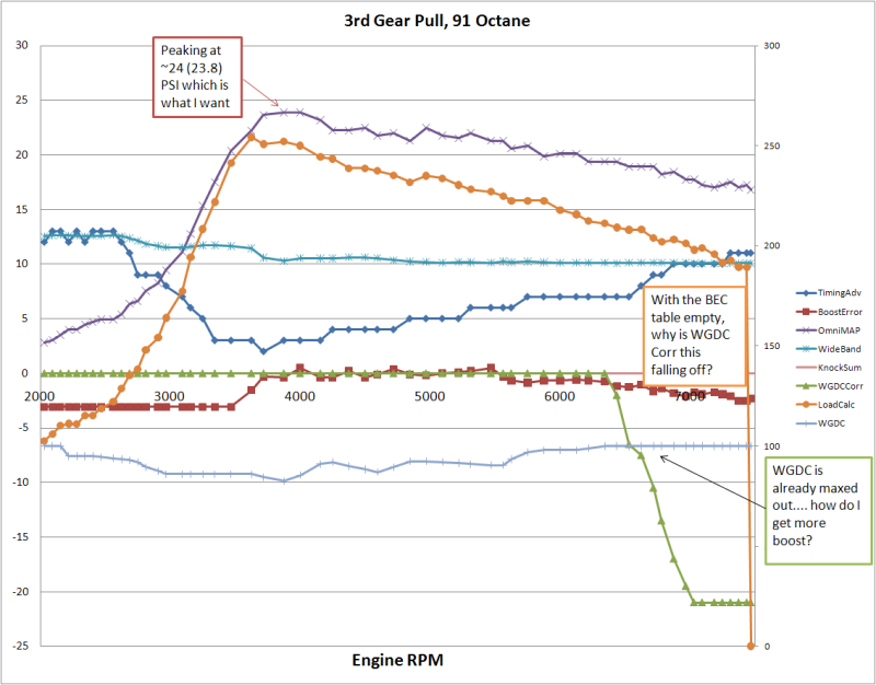

Hopefully someone can help me understand what may be happening in my case. I just took this log this afternoon.
I'm thinking my taper may be evidence that I still haven't fixed all my boost leaks...

Did you pressure test? Did you find and fix your leaks? BTW the stock turbo will have taper. The best way I have seen to eliminate taper is an O2 dump. My car is tuned for 24 psi and I taper to 22 psi by 8k rpm. But I have a built head which contributes to taper. Despite my taper, my airflow increases all the way to redline. My point is that boost is not what makes power, airflow is what makes power. As long as airflow increases, you are good.
Old Sep 2, 2009 | 05:12 AM
  #825
Jack_of_Trades's Avatar
Posts: 3,523
From: Opelika,AL
I've never seen someone enter a value larger than 100% in their Base WGDC table. Is your local atmospheric pressure really 13.4 psi!??? If not, your BASE BOOST #1 table is gonna be off. Usually with a boost leak I would suspect higher load values than he is getting,hmm. My guess is the boost pill thingy isn't enough. GM BCS can't be beat.
