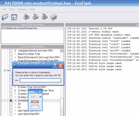

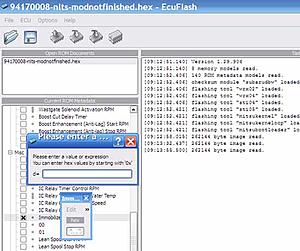

Originally Posted by 4TUN8
Ooooh I didnt think about the immobilizer thing, anyone want to explain that for me?
click on your current ROMs working immobilizer, new box opens..click to highlight text in box, copy contents(CTRL+C) Expand immobilizer in new patched ROM and paste information from your current rom, hit enter, close box and done.
