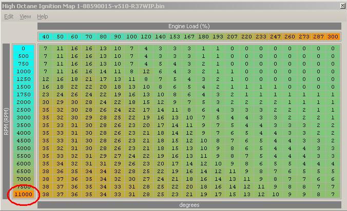

ok i am tired of looking at the 11000 rpm in my timing map. Can i change it or is it a bad address? I am using ecuflash 1.35 so i have a feeling it was set in 1.29 and carried over.

I have the 11000 RPM in my timing map also in ECUFlash 1.38

^^ post a screen shot. But you should be able to lower that just fine. All it means is that when you go past 7500 it will interpolate between that and the values for 11000 really no purpose to have it any higher than whatever you rev limit is since you'll never be able to hit it.
I wasn't sure if it was a bad definition in ECUflash reading a part of the rom it shouldn't be. If so changing it could cause other issues.
you running a big turbo ? i apologize if i missed anything you have posted. too much to go back and read. Just looking at your timing map and guessing that that is the case.
stock turbo 25/26psi. why does it look conservative?

i belive we all ahve that 11000 in our timing map...why is it bothering you

i dunno, it just looks weird. I just find it weird that the stock timing map would account for 11k rpm. and yes i understand that it would interpolate between 11krpm and 7500, i just find it odd.
