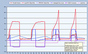

Problem with v5.5
I switch my ECU from 88840016 with mrfred boostcontrol mod (https://www.evolutionm.net/forums/sh...d.php?t=288408
to V5.5
I change the follow lines in the xml file (88840017 other place for MUT):
<table name="MUT8A" category="MUT" address="37B6E" type="1D" level="1" scaling="Hex16"/>
<table name="MUT8B" category="MUT" address="37B72" type="1D" level="1" scaling="Hex16"/>
I change the values in MUT E3 & 83 to log ALT Map & Alt Map Volt
now the Problems:
1. MUT E3 0,195V & 83=255 dont change the Values when i use the AltMapSwitch( checked with Voltmeter off=0V and on=4,11v)
2. Boostcontrol dont work (look at the EvoscanImage)
Gerhard

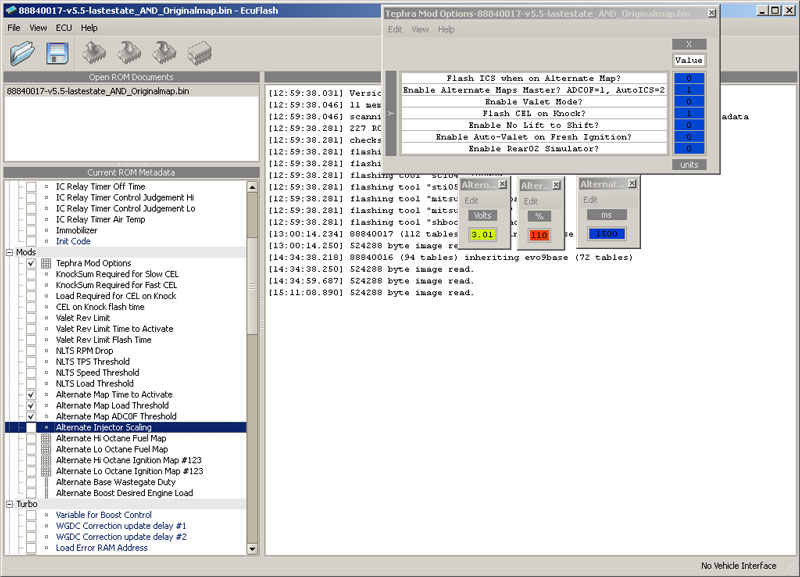

can you log 0x8425 for me?
does your ICS light flash when on altmaps (not sur eif 88840017 has ICS light)
are you using the altmap harness or autoics?
can you post a picture of your tephramods options + altmap settings?

MUT E3 is 0x8245 and in the logfile show everytime 255
i using the altmap harness
my evo have no ICS Hardware(German 2007)no LEDs no Switches etc.
Attached Thumbnails PATCH: TephraMod V5-tepheramodoptions.jpg

Gpunkt - can you use something other than E3, I am not sure that the ECU can read MUT's that high.
just overwrite MUT00 for the time being!

Originally Posted by Gpunkt
Problem with v5.5
to V5.5
now the Problems:
Gerhard
It works for me, I didn't try atlmap yet but boostcontrol is ok. Try to redo a new map copying your tables on a fresh 88840017 V5.5.
