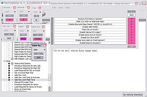

TEphra, I am using the 5.1 version of 96530006 as a replacement on an 05 evo 8. Everything seems to work fine, but around 4k rpms in 2nd or 3rd, during acceleration the CEL will start flashing slowly and continue for a good 3-5 minutes. I even turned the car off and restarted and the flash was still there. This is not knock because I have logged with no knock present. This did not have he same issue when running 96940011.
Any thoughts?
I have changed the turned all features off except CEL KNOCK. I have also changed the Valet RPM to 8k.
I have attached my settings currently on the car, hope this helps.

what version of ecuflash, post up the endian your put in your XML

Ecuflash = 1.30.1095, endian = big
I will change to little and report back. Good call completely missed that. Is Ecuflash 1.35 that much better that I should just upgrade?

/play family fued sound affect.
1.31 and BELOW endian should be little.
that will fix your flashing time...
report back about the 4000rpm thingy... with logs please
