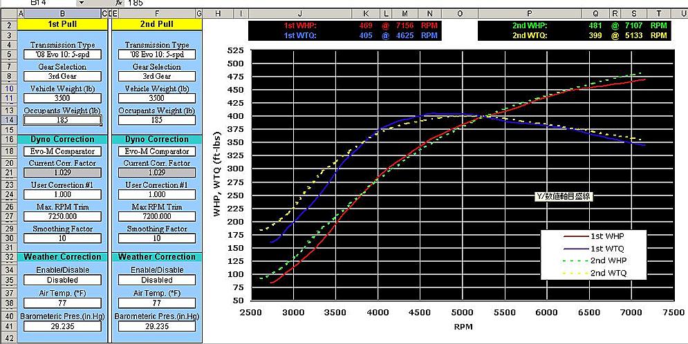

Here's my EvoX with the following mods running on 100 RON Oct (95 US Specs):
AMS Intake
AMS UICP
Cosworth MX1 cams
Blouch Dominator 2.0
AGP FMIC
HKS EVC 6
ECUTek/ECUFlash Tune
UR Mini Muffler Test Pipe
Kakimoto Custom 80mm single exit exhaust
1st run was higher boost with lower ign timing and the 2nd run was lower boost with higher ign timing.

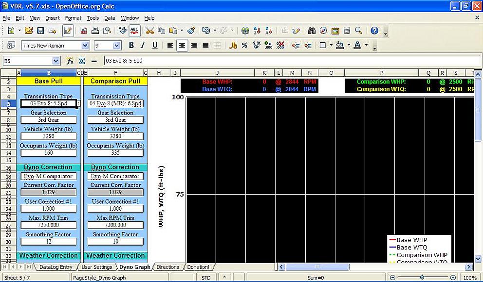

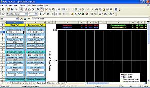

I got a question, why when i change what transmission in the drop down box my graphs go back to 0? and i cant get them to show hp again, it just says 0 whp at 2844rpm and 0 tq at 2844 also, my car isn't that slow but the graph works if i leave it as evo 9 5 speed, but once i change what tranny it is everything disappears and i cant get it back? I was trying to compare my friends evo to mine
Yet another bug in v5.6
If its going to take too long to get the stand-alone version launched, I will at least try to fix all of the bugs currently residing in v5.6 for now. Once I tried changing things so stuff worked with Excel and OpenOffice, bugs appeared all over the place.

Ok, so i dont suck that bad? hahah is the IX tranny different enough to cause far off readings from my 03? when it does work it looked really cool!
The '06 5-speed is different gearing than the '03-'05 5-speeds so your #'s will be different. Have you tried loading your info into the comparison side and see if the tranny selections work for now?

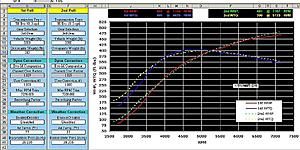

Both worked with excel this is awesome! I want to go tune now haha. Here's My Kelfords, TBE, Stock Boost, 9.8 turbo vs my stock cam, TBE, Stock Boost, Aem Intake No tune, I just adjusted the AFR and very little timing with the kelfords
You gotta love it. Being able to 'see' your mod/tuning improvements is priceless. I can't WAIT until the stand-alone version is ready. Thats going to be so friggin' sweet.
