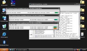

Here are the settings to correctly pass emissions just like oem, with the correct monitors enabled.
