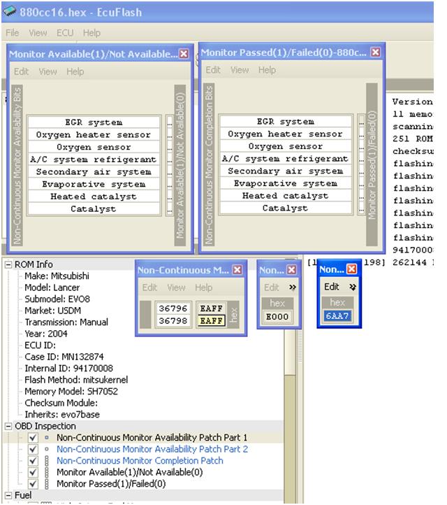

Old Dec 9, 2009 | 03:31 PM
  #133
sk8terdude929's Avatar
Joined: Jan 2008
Posts: 310
From: bucks county p.a
problem/help
I tried loading this patch and followed the instructions, watched the video but i am having problems wiith it. here is what it looks like. i can fill in any data (0,1) in the sections
oh and Rom is 94170008
Attached Thumbnails Patch: Force OBD Inspection Pass (acamus, mrfred)-forceobd2.jpg
Old Dec 10, 2009 | 08:15 AM
  #134
CMB's Avatar
CMB
Posts: 481
From: Near water
Dont expect any help. These guys just help if they know you
