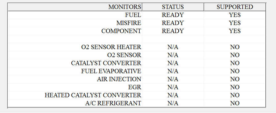

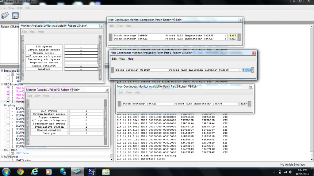

Does anyone know why this is going on? Attached are my Ecuflash settings and the way my car reads in Scantech. It only shows 3 sensors as ready. Is that right? Even when I set everything to pass, it only shows those 3 sensors.
Thanks in advance!

Anyone?
