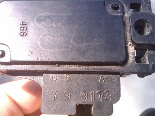

Igot a backfire this time but nothing else. It just cranks and cranks. I will reverify my harness. But it was built by a shop in my area that does the 2G to EVO 8 swap. so they have the experience. And I know for sure the guy that made it even referenced this thread. This is getting very frustrating. Im not going to have my car next week. I noticed the hex for the immobilizer was 0000 shoud it be 0040?
what can i log in evoscan that i can post to help figure this out. now i have a MAP sensor but i have searched and do not know how many bar it is. Here is images of both my MAF and My MAP sensor. I have a GM MAS and MAP sensor that I could go SD with, I just do not have a MAFT cable. So I would have to cut and solder my 2G plug for my MAS to connect if
not sure if it makes a difference but i have a 2003 ECU and the rom id is for a 2005, i dont see how that can affect it when it comes down to just 1 and 0's
what can i start with for troubleshooting to ensure my inj are being driven properly, like i said when i plug in the stck ecu it starts on the first crank
Attached Thumbnails Evo8 ECU in a 1G DSM in the works!-mafimage.jpg   Evo8 ECU in a 1G DSM in the works!-mapsensor.jpg
