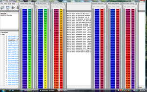

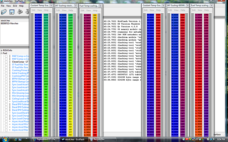

Hey Dave, can u clarify somethin for me?
I just noticed that theres a huge difference in "temp scalings" between a v.7 rom, and a stock rom. (88590715/88590015) Heres a SS of what Im talking bout... "stock" on left, and "v.7" on right.
Ive been trying to determine (on my own) which are correct, and have found that the "stock coolant temp settings" on a v.7 rom are NO good! But can't tell if the other temp scalings have an effect. Can u can enlighten me, please?

l2r99gst's Avatar
Posts: 3,499
From: CA
Looks to me that you have one in C and one in F.
