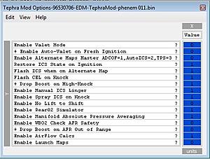

Posts: 214
From: South Africa
Originally Posted by tephra
Sean - Launch mode?
Can you provide a log of said incident?
rpm/load/psi//knocksum/timing/afr/tps if you can
Launch mode is disabled
Valet Mode is disabled
Map switching is disabled (for now)
Will flash the car now with this and do a log while idling and then try to rev it up.

Not so sure this will help....
AS the car revs up and the misfire starts/relay chattering, Evoscan losses connection and then it re-connects.
anyway file attached
