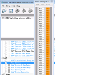

I downloaded the sd version assuming the mat scalings would be there already, but they are not. Is this something that has not been added yet or something i need to change? All i did was download from the link, paste the xml file in the correct folder and open the rom that came with it to take a look.
