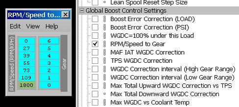

Did you try changing the "RPM/SPEED to gear" table? That table determines which gear you are in. I attached screen shot of my setting, and please mind that the scaling is in RPM/KPH.
Originally Posted by Raceghost
Any settings you have found that work ok as a baseline, or are you still at 100% across the entire table?
I am not sure I understood your question fully, but this TPS compensated WGDC also works when it is over the 100% WGDC under a certain load condition. So under, say 160 kPa, WGDC remains 100% all the time.

the old rpm/speed crossover value is still used, but only for TBEC interval...
log gear, that should tell you what gear you are in, if it's slightly wrong then you will need to adjust the rpm/speed ratio table (in V7)
Yes, I set this table to similiar settings. I want to say Appauldd posted the settings for us earlier in this thread...lol.
Ah, I see... Ok so it is only used for the low/high interval point. Now it is starting to make sense...
The Main Boost Table and Main WG table are independantly controlled by gear/rpm utilizing the RPM/Speed to gear table to tell boost control what gear it is in. Boost in 1st gear goes off column 1 in the boost table and then when the ecu senses you shift to second, by means of the lookup in the RPM/Speed to gear table, it switches to column 2, and so on... same goes for the wgdc table.
sometimes I feel like such a brick...lol
