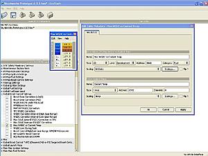

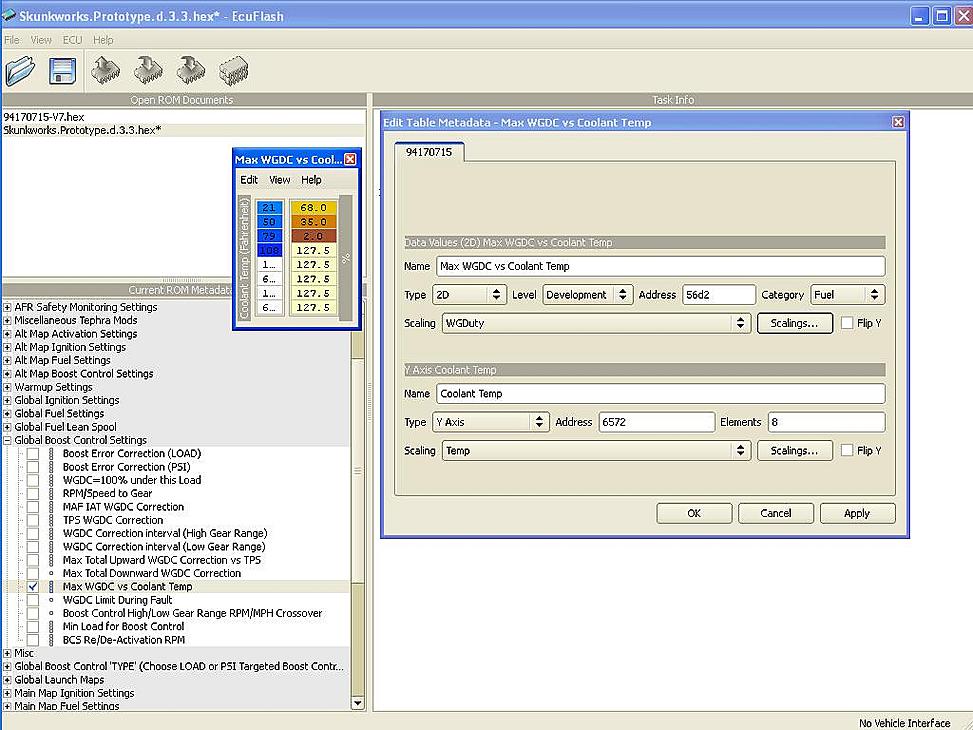

Tephra,
Any word on the Max WGDC VS. Coolant Table Fix.
There have been a couple of us throw it up.
Here is what it looks like currently, I am sure it is an address issue...
Thanks again,
Old Apr 20, 2010 | 06:53 PM
  #204
Appauldd's Avatar
iTrader: (22)
Joined: Nov 2003
Posts: 2,408
From: Northern KY near Cincy
That table is correct....the address for the temp should be 67be with the scaling being Temp
Old Apr 20, 2010 | 06:56 PM
  #205
tephra's Avatar
Joined: Feb 2007
Posts: 9,486
Likes: 67
From: Melbourne, Australia
AFAIK 94170015 doesn't have max wgdc vs coolant temp..
the code is different between 94170015 and other ct9a roms...
Old Apr 20, 2010 | 06:57 PM
  #206
tephra's Avatar
Joined: Feb 2007
Posts: 9,486
Likes: 67
67be is the coolant temp axis for cranking enrichment maps
56d2 is invalid, its halfway through the header of another table..
for 94170015 at least
