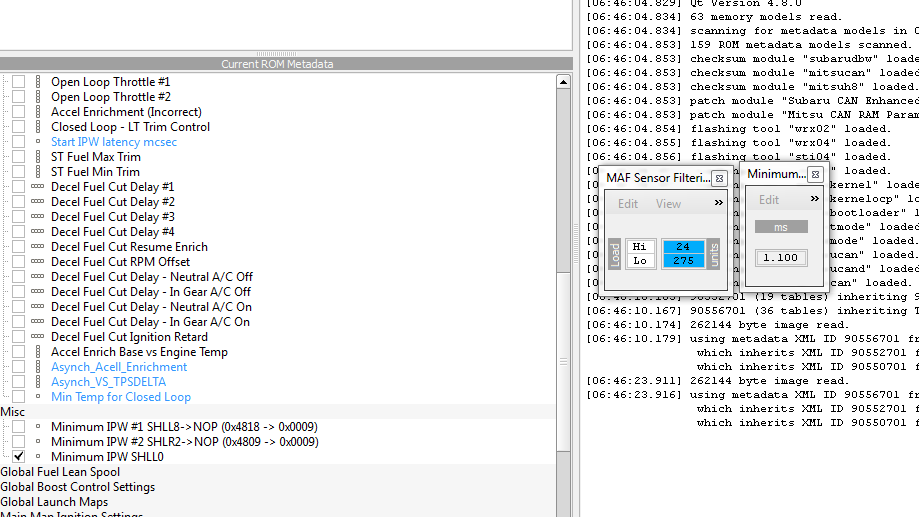

Old Apr 9, 2015 | 02:24 PM
  #203
SiriusEvo's Avatar
Veteran: Army
Joined: Dec 2013
Posts: 195
From: D
Originally Posted by tephra
Hi DOodz!
90550001:
Code:
<table name="Minimum IPW #1 SHLL8->NOP (0x4818 -> 0x0009)" category="Misc" address="227b8" type="1D" scaling="Hex16"/>
<table name="Minimum IPW #2 SHLR2->NOP (0x4809 -> 0x0009)" category="Misc" address="227ba" type="1D" scaling="Hex16"/>
<scaling name="IPW16:SHLL0" units="ms" toexpr="x*4/1000" frexpr="x*1000/4" format="%.3f" min="0" max="65" inc="0.004" storagetype="uint16" endian="big"/>
<table name="Minimum IPW SHLL0" category="Misc" address="1502" type="1D" scaling="IPW16:SHLL0"/>
After doing the code changes (top 3) you will then need to use the "new" Minimum IPW SHLL0 table to set your Minimum IPW - you will need to replace what the stock value is with ~1.1 or whatever you want. Feel free to use +/- keys to increment/decrement
Cheers
D.
Hey guys,
I tried the Patch above on an Evo7 ECU 90550701 and what it does is strange, first I only see two entries vs three for every other rom, and secondly whenever the Min IPW is touched, the Maf filtering low is changed as well.
Doesn't seem right. Can anybody help? I need to get some fic2150 going on pump gas and this patch would really help.
Attachment of pic for reference
